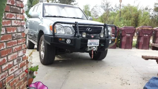

I have the same bumper on my LX. I love it. I have had no finish issues in the two years it has been on my truck. The bar as stated does not shake. It has one tab and the tab clears the grill just fine on my 2001. I will post a few pics up in a followup post in a little bit.

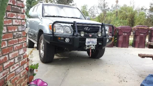

I'm a bit concerned about the brush guard portion of the bar in that it looks very straight and somewhat high compared to say the TJM.

I get no significant shaking on the Ironman. It's a stout unit. Keep in mind that the 'shaking' you see is the difference in movement between the hood line and the bumper, therefore it's not necessarily the bumper that is moving. Could be soft body mounts allowing the body to move around the frame, although if it's a high frequency shake then yes, it's most likely bumper vibration.

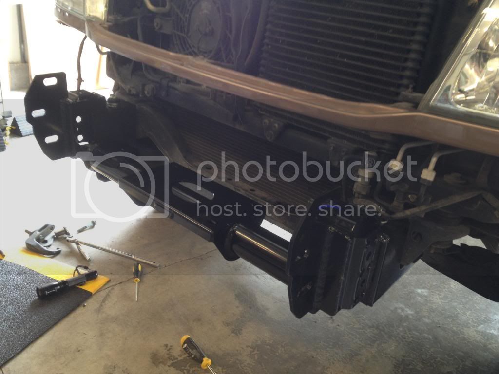

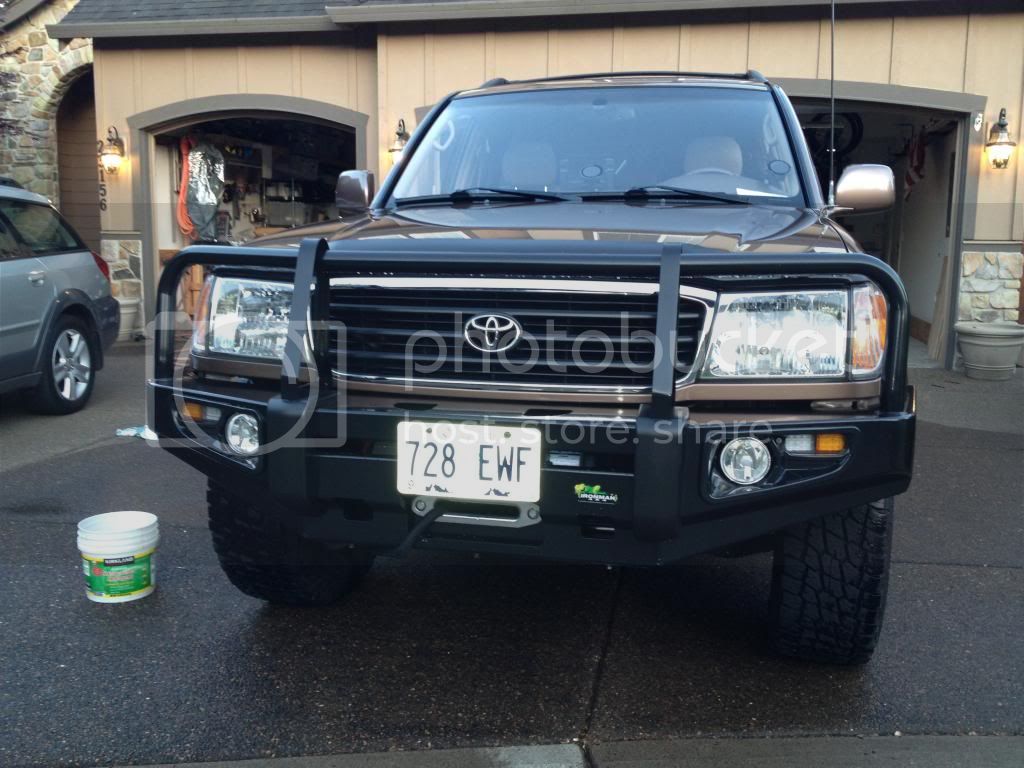

As far as a review goes... The bumper arrived extremely well packaged. In fact, it took a lot of effort just to get the silly thing unwrapped.
The Ironman support strategy utilizes a winch cradle that mounts between the frame rails. The bumper then mounts to the cradle. This is similar to other bumpers, however, the Ironman uses shims to fir out the gap created by the frame horns. I've read where other brands require trimming of the horns. While I don't consider trimming to be an unpardonable sin, I'd rather cut as little as possible. That said, there was one user with an LX who had gap issue with the shims. Don't know if this was caused by a delta in frame design between LC and LX (unlikely) or a mis-shipped set of shims.

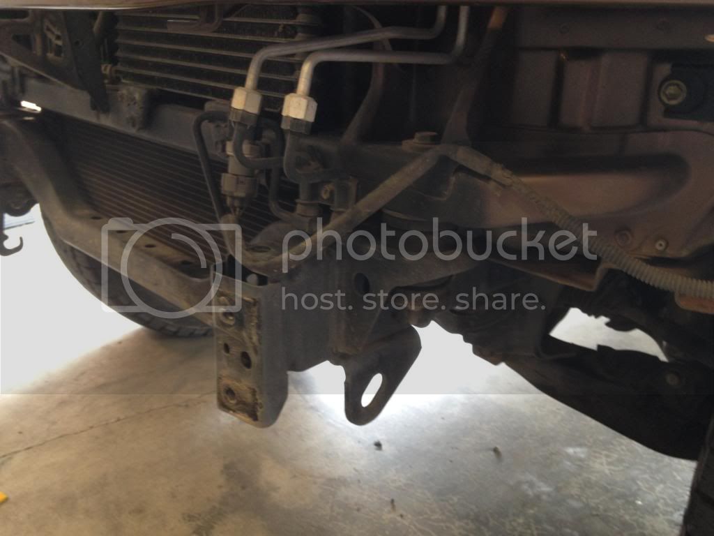

Here you can see the DS frame horn and OEM recovery point. Also note the proximity of the A/C lines.
Here's a pic of the installed shim. This is PS below the frame rail.
A couple shots of the installed cradle. Note the slotted holes on the front. These are used to adjust pitch, bank, and height of the bumper. The 'Swiss Cheese' area is the crash crumple zone.
I didn't get any pics of the winch mounted separately, but you can pretty much see the plate where it mounts. I have a Titan 12,000 lbs TW12 so my guess is just about any full size winch will fit. Don't know about the new Xeon as they have a larger height due to the cross-over frame design.

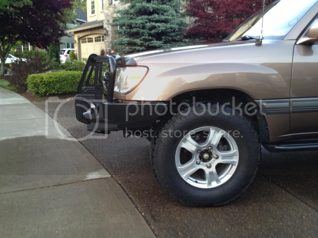

Installed pics:
Looking at that last pic, I could probably shore up a lot of that gap without any problems. I want to run it 'loose' for a while to see how it responded to flex and just haven't gotten around to adjusting it.

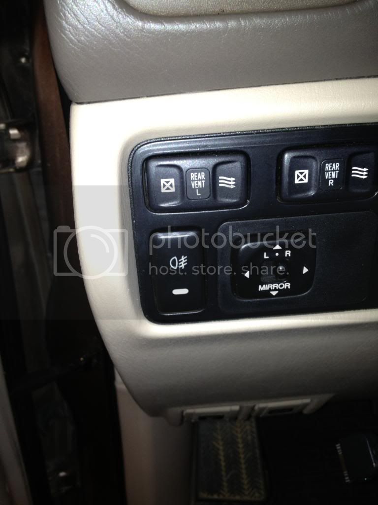

The light kit is superb. The orange LED couples to the blinker, the white LED to the running lights, and the fog (obviously) to the fog light. While not as bright as a Rigid Dually, these are some impressive little foggies. I'd say 2x - 3x as bright as OEM. They make a noticeable improvement. I just splice the turn/driving up into the corner lamp circuit next to the headlights.
The wiring harness is of very high quality. It comes with an an awesome OEM style switch that pops right into one of the factory blanks. Also comes with a relay for the fogs, although I just use the factory wiring.
All in all, very impressed. It's unique enough that you don't look like everyone else's ARB. Granted, a custom bumper with better recovery points would be the ulitmate, but at this time there aren't any that I care for. While the Blueberry is an exceptional piece of hardware, it has too much of a 'bikini' look to me and is missing the grill guard.
Not showing is the under-bumper guard; a plate that bridges between the bottom lip of the bumper and the OE skid plate to keep debris out of the winch area.
Happy to take other pics or answer other questions, just ask...

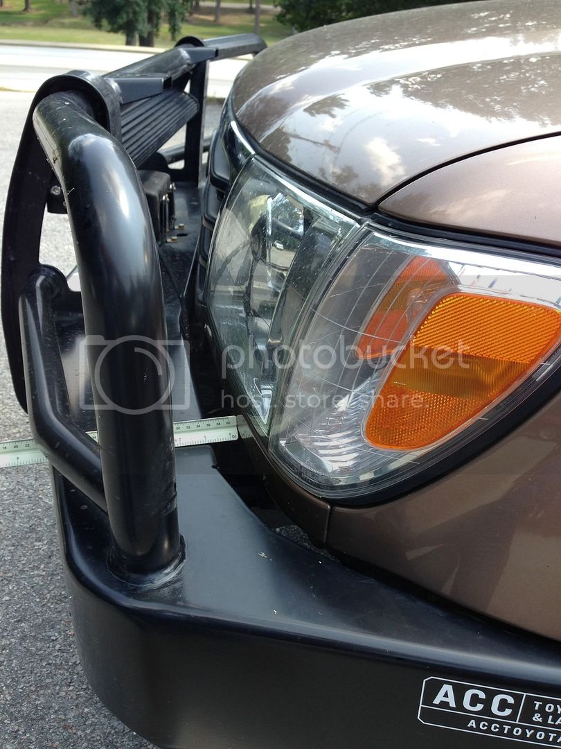

I've studied your photos closely. It appears that the brush guard tubes are somewhat taller than either the TJM or ARB bumpers. Are they too high in your opinion?
Also this photo of an installed TJM gave me pause:
http://i15.photobucket.com/albums/a363/tabraha/IH8MUD/DBM100/null_zpsf0c31b49.jpg
That gap struck me as huge. Is there a gap in that area with the Ironman, and if so how big is it?
Your excellent photo of the winch cradle showed some pretty big slots for adjustment. Are those slots large enough to minimize gaps (obviously they need to be big enough that there's no "crunch" as the frame and body flex differently)?
Thanks Again!

On the switch, I just had one quick comment. If it were me, I'd use the existing OEM fog lamp circuit and "switch" and then use this new switch for the driving lights that of course must be added eventually!
That's exactly how I'm running it. I'll use the Ironman switch to control Dualies eventually.
OregonLC ...Thank You for the great photos, detailed commentary and general thoughts.
The height is just barely visible over the hood from the driver's seat. The only 'too tall' then would be from the perspective of working on the engine, such as doing a 90k job. It's easy enough to remove that I'd probably just pull it off if I was going to be leaning over the nose for any length of time. I'd be happy to measure if it's of specific concern.

No gap, unless you want one. It's completely adjustable in three dimensions. Mine is set pretty 'loose' in the pic, I could tighten it up quite a bit. In fact, there may be enough adjustment to make up for slop in a body lift. Don't know on the latter, I'd have to take a look at where I'm at on the vertical range.
I think if the bumper was aligned to close the gap in front of the headlamps, the wheel well opening would look off.

Edit: here's my front 'gap'
Double edit: as long as I'm updating, this isn't from the seat, but this is about how much bumper is visible from the cockpit. Real view is slightly lower so less exposure.

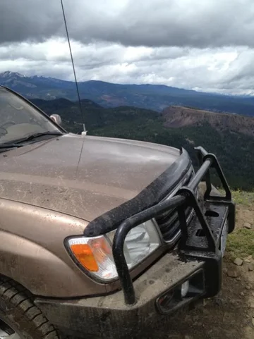

Yes, the hoops are slightly taller than an ARB, but they don't appear to be "too tall" once installed, at least on the LX. Also, the round tubing is a larger diameter than what's on an ARB. I'm extremely pleased with the build quality of this bumper. I've owned several ARBs and I have built several custom bumpers myself. The Ironman is a great value, especially at the sale price.
