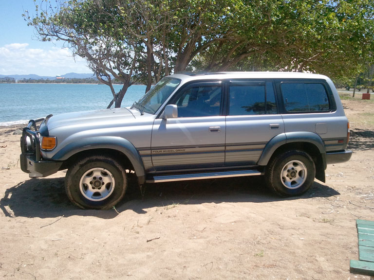

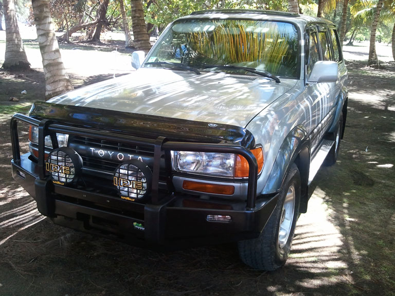

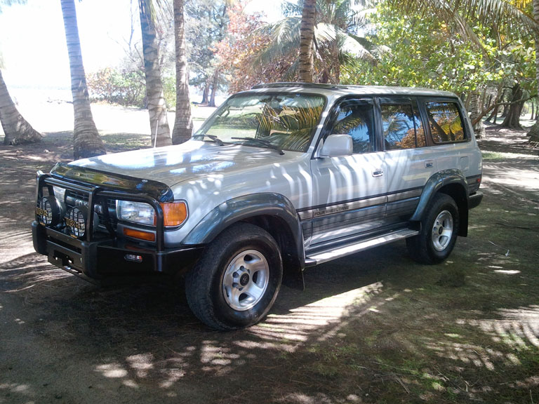

Someone asked to see how much an Ironman BullBar affected the Stock Front suspension a while back. I fell no change at all with the front bumper. Had a chance to take some before cell phone pics while at the beach today.

I am curious as to how close you are to hitting the bump stops on your front axle when you are parked on level ground. My stock springs are worn and I only have a couple of inches of clearance, but everything is completely original. I am almost certain a bumper like the Ironman or ARB would have me riding or almost riding on my bump stops.

I just checked the space left on the front bump stops and its about 1" +/- with the bumper installed !!!
I havent felt any bottoming out, and the bump stops look new.
I guess that 4" lift is going to come in just in time.

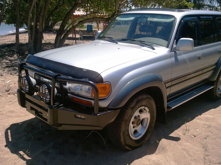

Can you please get a lower shot being even with the bumper? I'm interested in how much it will protect the AC dryer.
Thank you.
Sorry an my way out to airport, but I did get a chance to take this pic.
Looks like my dryer sits a bit higher than it should, which is a good thing I think:hhmm:
It also seems the bumper has the dryer covered by a few inches.
Here is a pic I posted before.
Its take at almost level, just a bit higher, making the bumper look really low, but I think its just my cell phones camera lens and angle of pic.

Looking good!!!!:grinpimp:

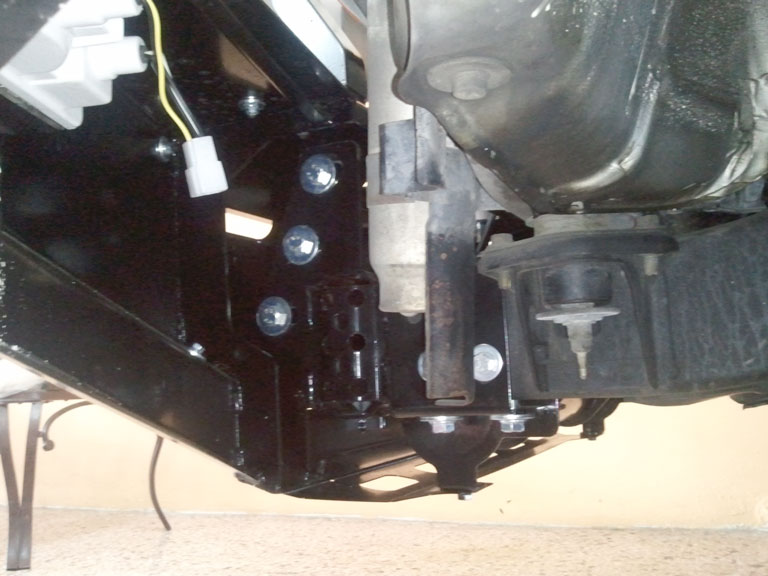

Was it hard or easy to install?
It was a piece of cake to install. Stock bumper comes off in 5 minutes. Winch mount goes on in 5 minutes, using bolts into existing nut plates. Outer bumper goes on to winch mount with 6 more bolts. It took longer to unwrap then it did to install.....

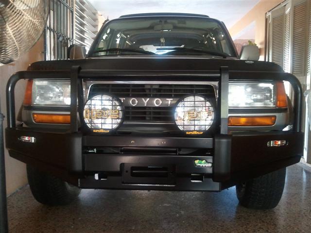

So by this design it looks like you mount the winch to the carrier / subframe - and the bumper is a "floating" type thing?
Or do you mount the winch feet to the back of the face of this like an ARB?
