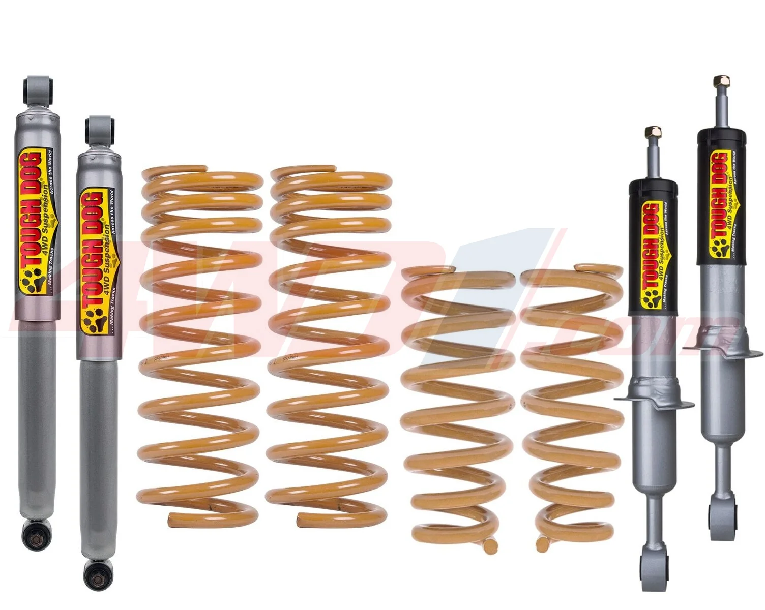

IRONMAN 4x4 FOAMCELL PRO
TOUGH DOG 40mm Bore 9 way Adjustable Dampening Shock
*Tough Dog is 9 way adjustable dampening, Ironman is not adjustable
*Ironman has bigger diameter shocks
*Ironman is height adjustable on the front, Tough Dog I think is fixed height.

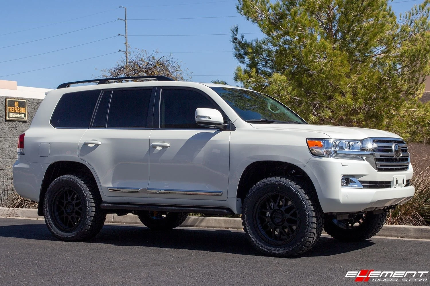

4. I want to have level height stance front and rear (no rake) SIMILAR TO PHOTO

I have around 20,000 miles on my Tough Dog Adjustable 45mm shocks/lift kit. It’s about a 2” lift. The ride is fantastic with the ability to dial in the firmness. I generally run on settings 3-4 for daily driving. This allows for a pretty soft, cushy ride but with minimal to zero body roll during cornering and braking.
I have around 1” of rake with this set up and the height is not adjustable.
Adding a lift doesn’t allow for bigger wheels/tires. It will just delay the rub point during the suspension travel. Keeping the tire size at 34” and smaller will allow for an easy fit. Any larger will require much more effort to fit. Wheel offset play a big role here in what what rubs and where.
