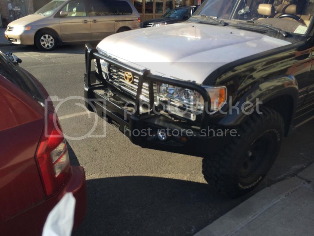

ok terrible pic but, i will do a better one later.
the only issue i had was other than the instructions sucking , was 1 nut and bolt were missing for the side frame bolts and none of the top and bottom frame bolts fit , they were all to big . so i will have to buy those somewhere .
i also had a huge problem installing the bottom plate and could have roached it during the install . i emailed IPOR to get advice . maybe i will hit up ironman next
its not that heavy , but its heavier than the stock one and because of that i can feel the suspension is a little softer now . dont know if i like that part yet.

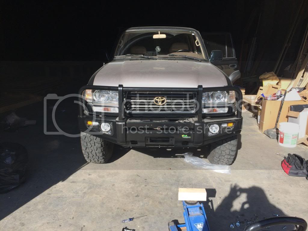

Are you sure that your bumper is as high as it can go? The gap between the bumper and body looks like mine did before I adjusted it up and back further. I really had to muscle it into position to get it to fill those gaps. Mine is close enough now that I had to remove the little fender flare stoppers and have just a little gap between my flares and the side of the bumper (to account for body movement).
I didn't have any missing or wrong sized bolts in my kit either so I can't help there.
The bottom plate is really kind of cheap and bent on mine when bolting it up as it looks like yours is too.
Take a side shot of the gap between the bumper and flare if you get a chance.
Posted late your bumper can come way up closer to the body to fill those gaps.
Try to adjust it some more. I will take some pictures of mine tomorrow and post them so you can see the difference.
i would appreciate that , my friend and i were yanking the crap out of it to move but thats as far as we got and keeping it even looking .
i would love to get it closer.

when I first mounted mine I had a gap but then I messed with it some more to get it all of the way up to the rubber bumpers on the bottom of the flares.
You can see the gap in the first two pics and then I had moved it up in the third. If you plan on wheeling it hard you may want to leave it lower. Someone on here says they saw one flex and pop the flares. It may have not been mounted right with the last four bolts that need to be drilled out.
