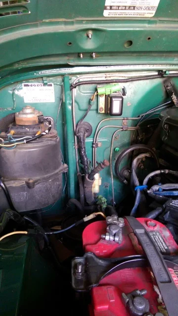

I haven't had any updates on additions this summer. I've just been driving it. After almost two years of tinkering its been amazing to do just that. Slowly I've been going through the POs "updates" to the engine and was wondering if someone could shed some light on what this is? The tube coming up comes off the side of the gas tank, into a hard line that runs down the frame and up into the engine compartment where the PO capped it with a bolt. Is it a breather for the gas tank? Some return line?
I have a weber carb and the PO has done some de-smogging work. The engine runs like a top right now, but I do get a gas smell when I up shift so I would like to track that down eventually.
Looks like one of the charcoal canister hoses from the size of it, but I'm away from home and can't look at mine right now. The canister/vapor recovery system does keep the gas odors down.
If you have a Weber and that line comes from the inboard side of the fuel tank, it's the stock fuel return. Does it run side-by-side with the fuel line along the frame?
That line does run parallel with the incoming fuel line. I was looking for a return port on the weber, but I cannot seem to find one.
