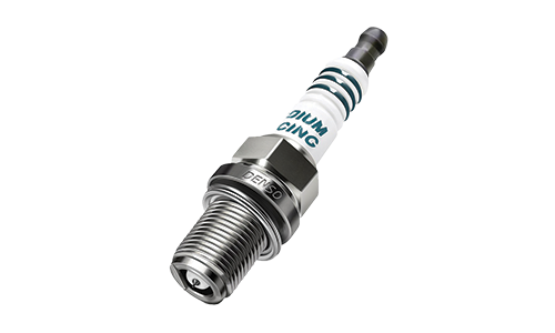

Has anyone had experience with iridium plugs on their supercharged 80? I am considering going this route, have read some internet forums where guys prefer them over platinums in boosted applications (everything you read on the internet is absolutely TRUE after all). My local NAPA has a part number for Autolite plugs ASPXP3924, but I don't know if I can get them in a colder heat range. Any help would be great, thanks.

I run Denso MR2 turbo Platinum plugs. One heat range colder than stock and the correct gap out of the chute.
90919-01180-83.
Thanks Dan, I did see your post suggesting those before when I searched. I guess if it's good enough for a turbo Toyota, I really don't need iridium.
In Toyota's factory forced induction engines they use platinum plugs that are one heat range colder than the naturally aspirated version of the same engine. It seems to be a natural choice.
I found this write up from Denso densoiridium.com/faq.php lends some credibility to iridium under boost applications
On the other hand Denso is the exclusive service parts supplier for Toyota :meh:
