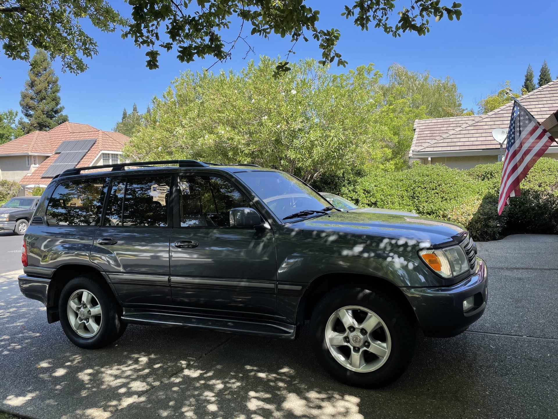

After years of off/on looking I finally found a super clean 100 with 120k miles. The gentlemen who sold it was the original owner and is getting older and not driving it much. Don't think it's ever been off-road.
My summer project: Tires are the first order of business as the current tires are below minimum tread and old. Lots of small cracking at the edges. It has 18" wheels so the 285-75 BF Goodrich KO2's I plan on putting on are $350/tire. ARB Sahara bumper with a Warn winch and a 2" lift are next mod's.
Tire advice needed: I'm trying to decide if a smaller wheel would be preferable. Either 16" or 17". Hoping some of you will weigh in on this debatable topic.
Looking forward to meeting some of you as I get this rig ready for action...

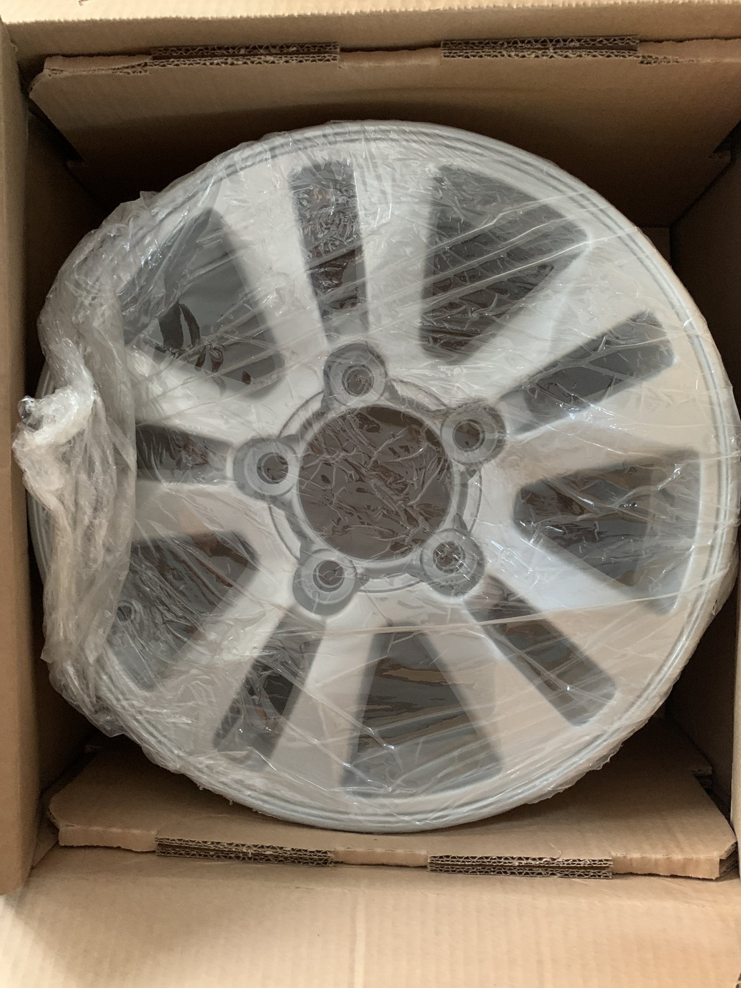

I found a set of 17’s online, from one (3) of the factory wheel restoration shops. Kind of had to piece together a set of 5, paid from 99.00 to 180.00 each shipped. Haven’t put tires on them yet, will have a set of 5 RW wheels for sale pretty quick.
