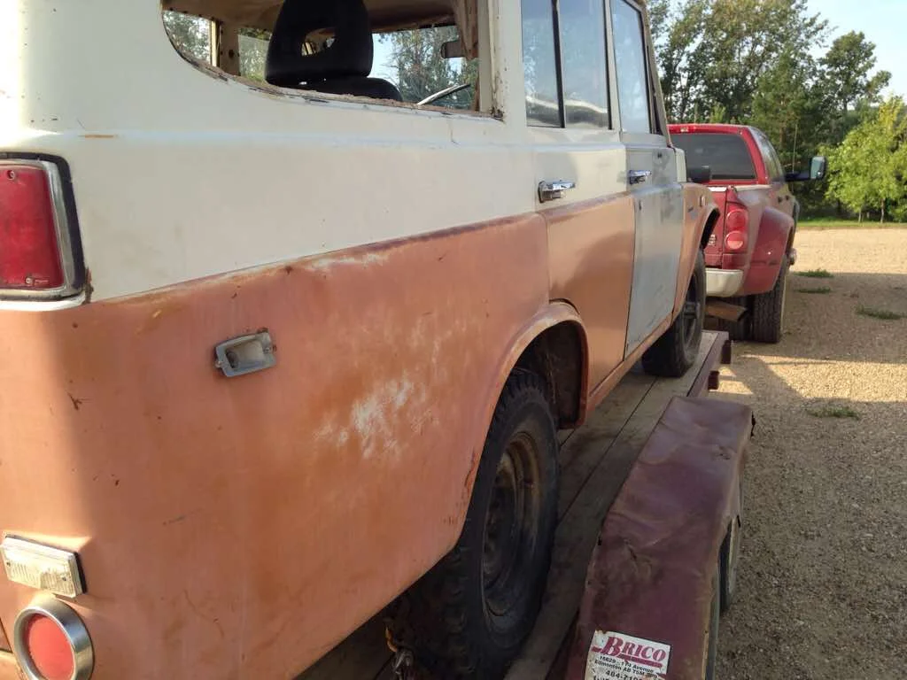

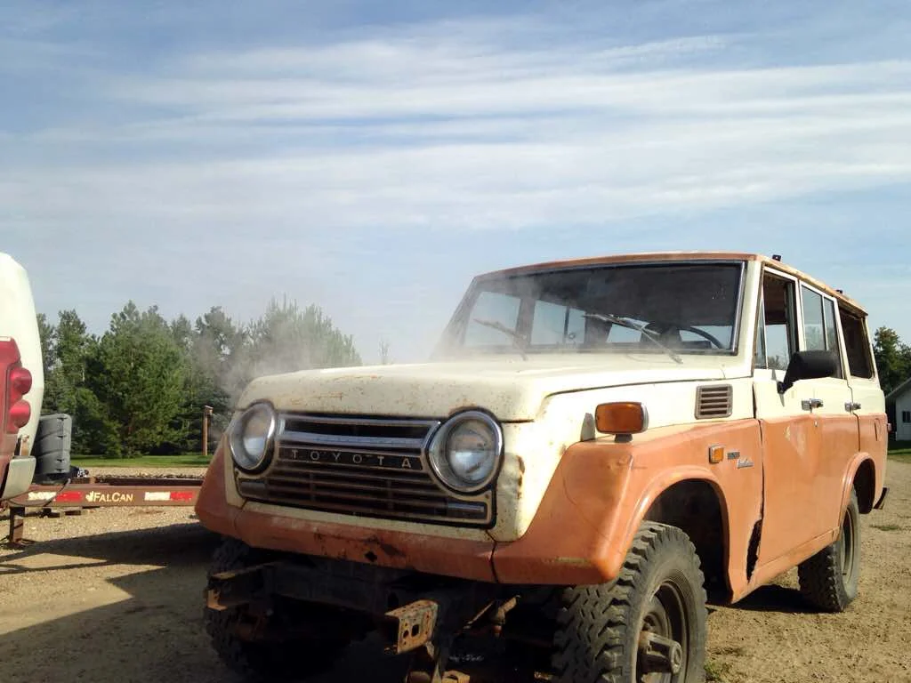

First test drive done and as expected

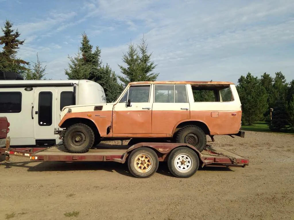

Details to follow
:pig: Looks solid :bounce2:
Ty's or Chars? Looks in decent kit! A wee bit smokey...
What are the plans?
This little piggy is mine… not sure on plans just yet. get to know it for now. Drives pretty good as is.. needs some brake adjustment and that sorta thing but generally pretty solid…

I suspect it would be wise to put Rottingham back into storage and bury those NOS 55 mirrors I have somewhere out in the back 40.
Sept 71. How'd you narrow it down? (I only know about my 73).
No quarter vents, small reverse lights all point to pre-'72, but the grille does not have the built in running lights.
Quarter vents came in 9/72
Small reverse lights ran until 9/72
The grille w/ running lights I guess only ran for '68 & '69, but I thought I saw some '70 with them.
So I guess I got lucky, it could have been a '70, '71 or '72!
