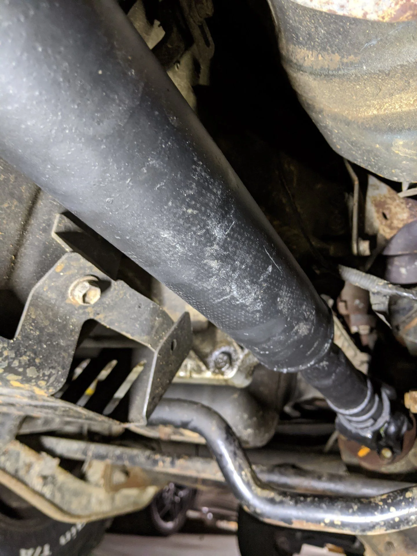

Rebuilt the front driveshaft and found the vibration problem was probably due it being out of phase by two teeth. Nice and painted now...
