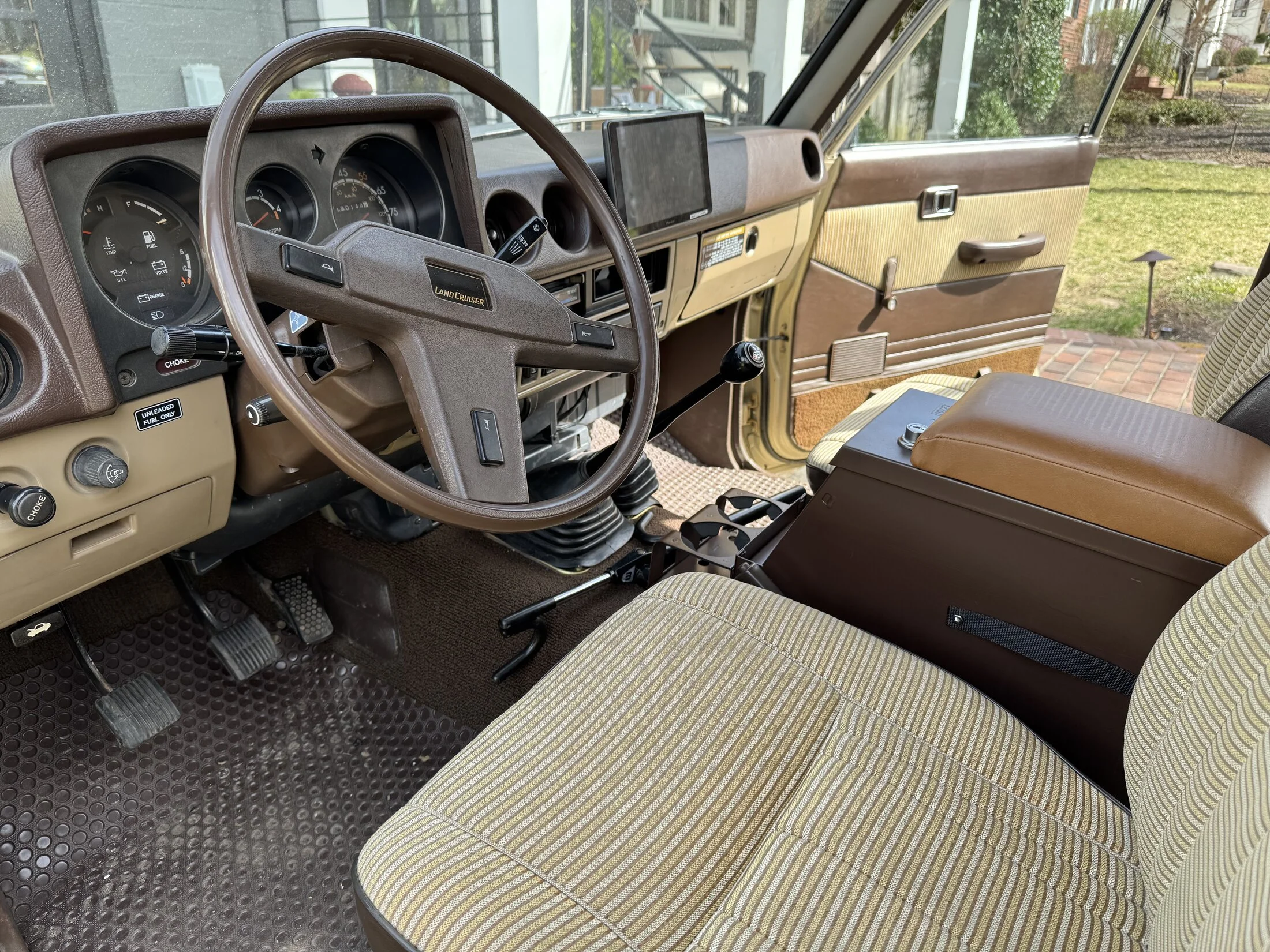

In January of '25 I was fortunate enough to come across a 60 that fit the bill, and that is what you see below (photos are from the previous owner...it just made it's way to me this week and I haven't had the time to take proper photos in it's new locale).
Original paint and I believe original OEM graphics (can any experts chime in/confirm on the graphics??) and spent the majority of its life in Arizona (hence the Arizona flag on the tailgate....which will stay, part of this trucks story), then Colorado for 2 years and now it's made it out to the East Coast. The truck has been well maintained (large binder with service records, most of which are handwritten) and is as rust free as a ~40 year old car can be. The truck has great, original paint and patina showing some of the signs of a well loved vehicle and my goal is to keep that character.

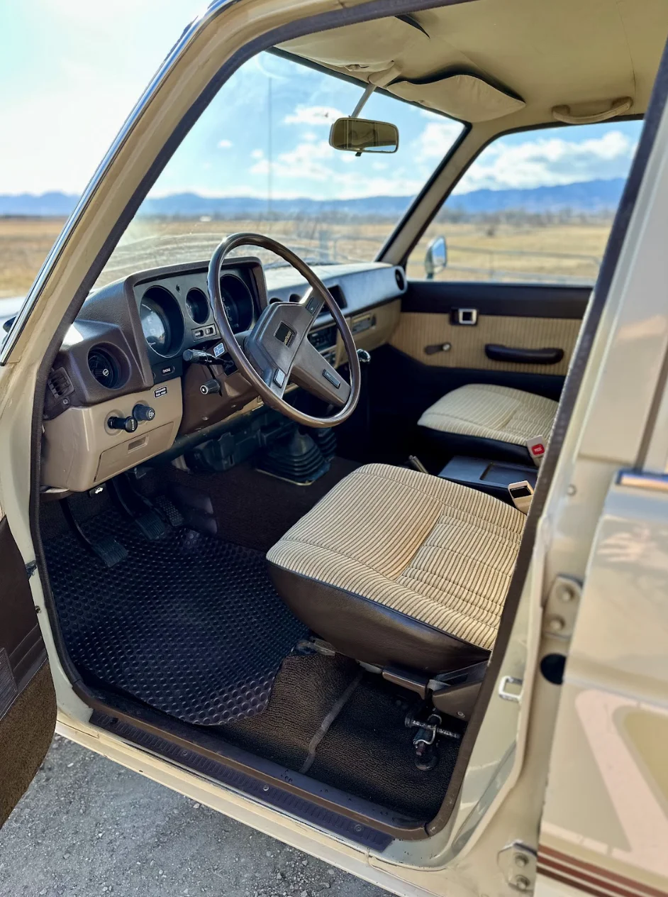

-Rear seat from a FJ62 with OEM headrests
-All seats have been repaired with OEM fabric and thoroughly cleaned
-New interior carpet
-New Dash Cap

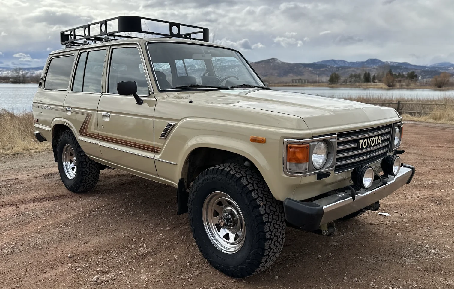

Not an update, yet (but that's coming - hopefully parts arrive this week) but hoping for some clarification from some of the experts here.

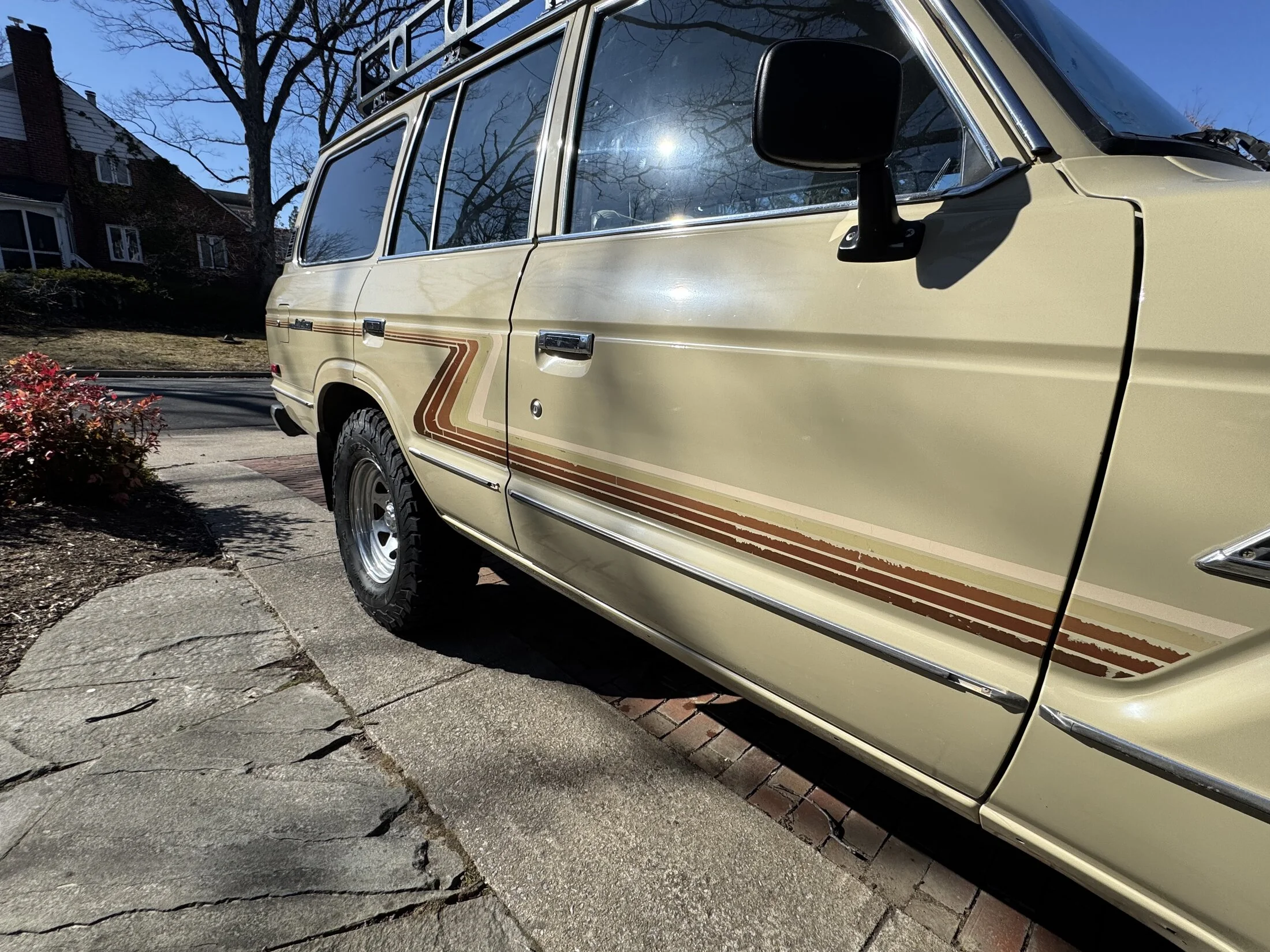

Can anyone assist in determining if these are original/OEM graphics? Would this be a DIA (Dealer Installed Accessory) or was this something Toyota did at the factory?
Thanks for the help!

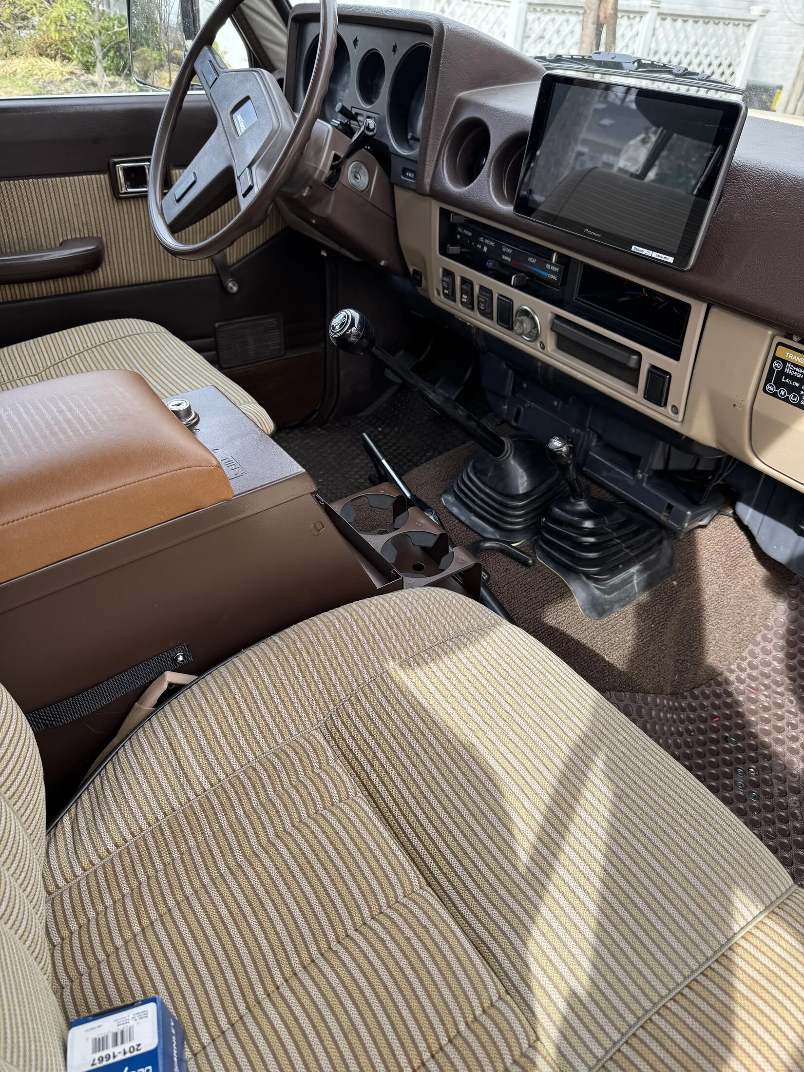

I added a Pioneer 9" touchscreen display (DMH-WT3800NEX) and paired it with a Pioneer back up camera....works seamlessly and is pretty nice to have Apple CarPlay in the car as well as the back up camera. Found out during the install that my back up light switch had failed, so one of those is on order so my reverse lights actually turn on. So, project isn't officially done...oh well. Here's a quick video showing how it works
In addition, I replaced the front door speakers with Pioneer 5 1/4" speakers (TS-G1345R) speakers which fit seamlessly behind the stock grilles as the truck still had the original speakers from '84 and those were toast.

Graphics likely dealer installed or aftermarket. Same with the door trim.

In regards to the door trim...thanks for the input, I had a post here about it and initial consensus seems to be aftermarket/dealer installed.

Was able to get a few hours over the past few days and got my @TRFarmers new dash bezel in as well as my Tuffy box. I followed @AggiePE 's write-up for the Tuffy install which went pretty well....happy with the result.
Went with the Spice 8" box and painted the base RustOleum Dark Brown (241239 color code) which, along with the spice armrest compliments the stock colors well.

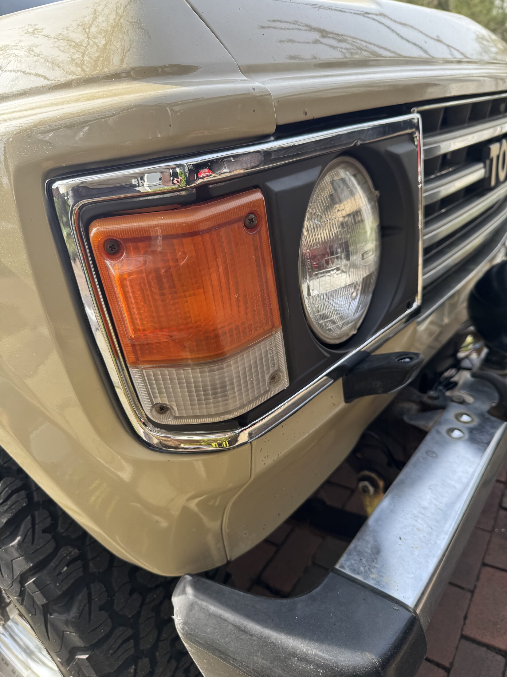

Got a little bit of time today and was able to use @thecadefire write up on using Bushwacker fender trim around the headlights. My old gaskets were non existent and this was a quick and easy update.
Highly recommend.

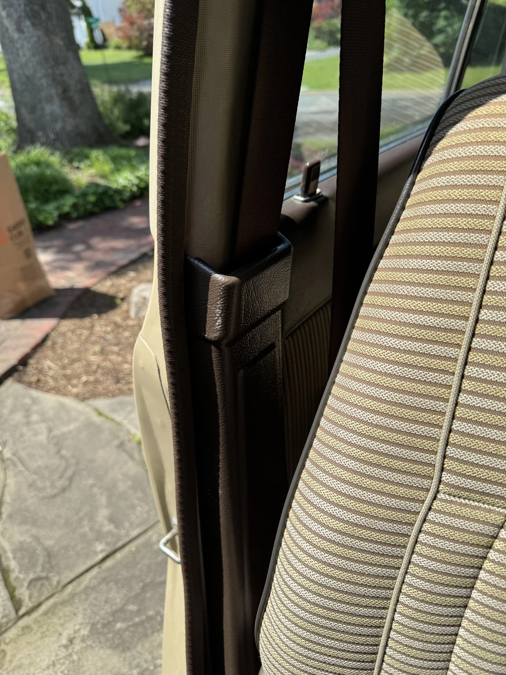

Got my The Rust Farmers (@TRFarmers) B-pillar replacements in - great product, fit and finish. Thanks for producing these! The first photo shows what the top of my original B-pillars looked like....a definite cut/scratch risk and the next two show driver and passenger side with the replacements in. The replacements are a spot on match and a bit thicker so should hold up for another 40+ years.
Slight note, I have aftermarket seat belts, so I had to cut the bottom of the B-pillar replacements to clear the retractor; took all of 5 minutes and a Sharpie and Exacto knife.
