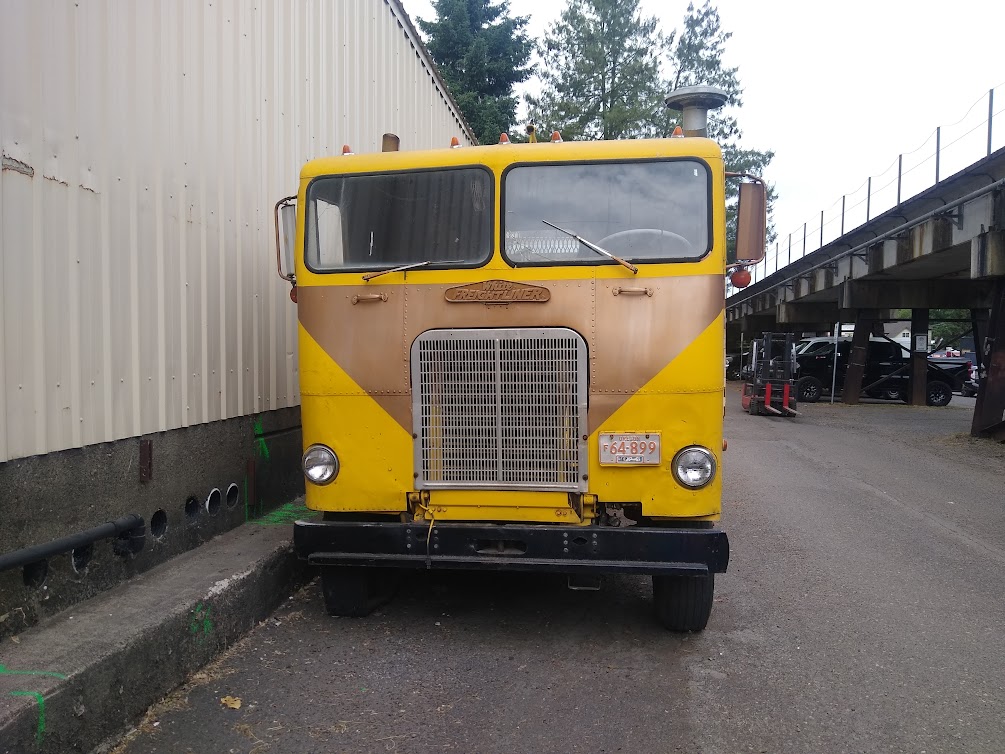

I have a 1960 White Freightliner COE sleeper I have been slowly working on for years. It runs pretty good but it was a farm rig from a big horse ranch in Montana I think and so things like garden hose air lines and tape that holds electrical connections together are all standard equipment.

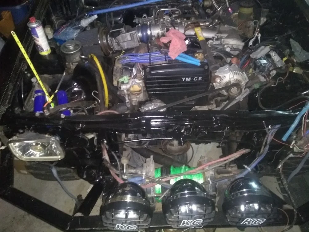

I am familiar with custom fab, welding, most mechanical aspects of regular trucks, I have a 87 4runner w/ 7mge, and a 85 regular cab p/u 22r and have been wrenching for the better part of 25 years.
My question is about the steering, on these trucks there is no power steering and no brakes on the front wheels, they are just there as casual suggestions on the direction you wish to go. However I am not as strong of a Man as we used to have in the 60/70's and my delicate sensibilities desire power steering. From building truggies I have put on full hydro and hydro assist where you tap the steering box, but this truck does not have anything to start with and most hot rods have after market kits that have been designed for them and this is kinda... different than a small hot rod.
I swear there is a power steering add on for trucks without power steering and where you do not remove the steering box, does anyone have any suggestion on keywords to search or maybe for bonus points a vendor that may have something like this.

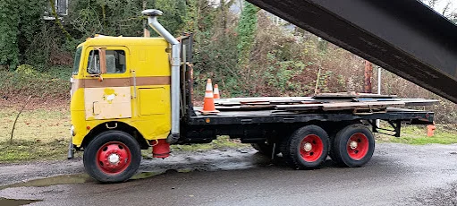

It is going to be our mascot for the local car show, I am going to put some big banners on the back and park it around town for promotion every year. We are calling her Rubber Ducky and I am working on some fun swag to give to kids when we take her out.
That is good advice to not get left stuck, even though I am only going to drive it once in a while it is high blood pressure trying to make a turn with cars all around and hoping I don't screw up and get stuck and brick out a whole intersection. It is already hard enough with the transmission, reverse if basically in the seat, so you have to lean over push the stick all the way in to the side of the seat and kinda pull the seat to the side to get it in. That must be nice with 2 boxes, even my f350 psd feels like the steering box is undersized for it with stock tires. It would be cool to see how they built that system.
