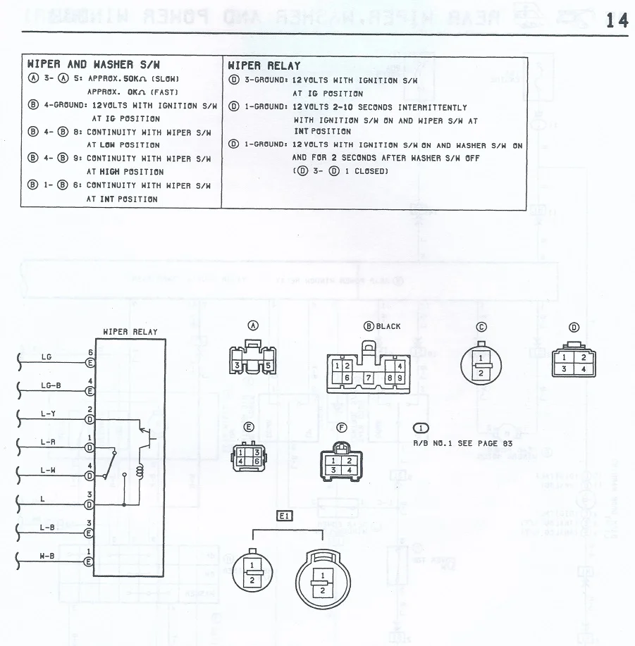

Short answer, yes. Here is a scan of the 4Runner wiper circuit, 2 pages. Relay is on page 2.
Awesome! Can't tell you how long I've been looking for this diagram!!

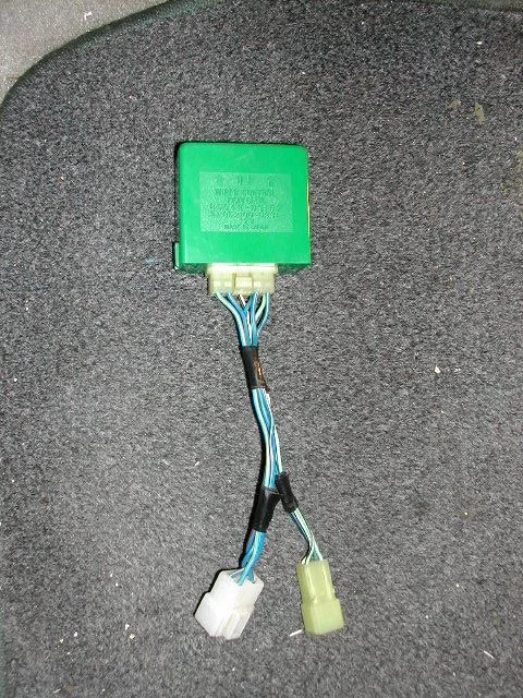

You wouldn't happen to know or have a pic of the relay itself? I kept the whole loom and the fuse boxes out of the surf, so I should have it some where, just need to know what it looks like
Many many thanks

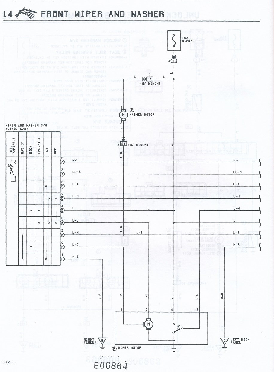

Just looking at it all again, I'm not sure this is the diagram for my surf.

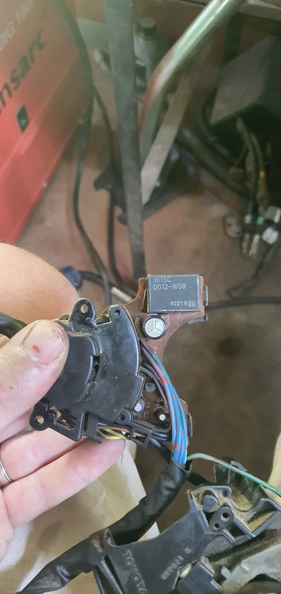

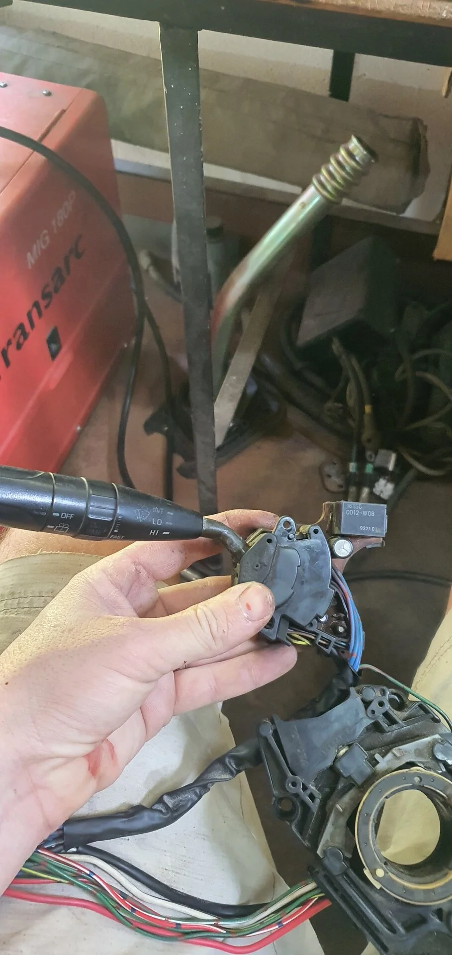

Here's a couple of pics of the combo switch I'm working with....
Is this supposed to be the intermittent relay here??

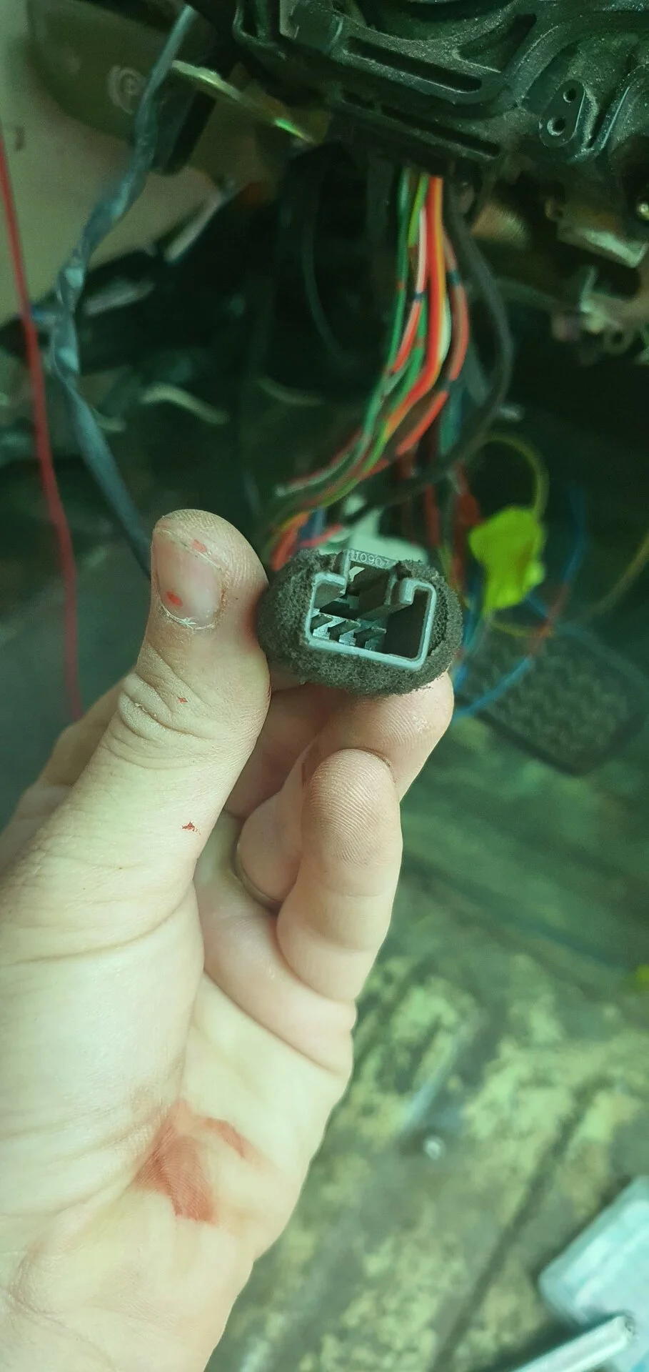

And then this is the pig tail and plug I'm not sure about, but thinking about it, it must be for the rear wiper, right??
Here is the wiper relay on my truck.
OK great, thanks. Will go through them all again but fairly sure I don't have that. I'm not sure if because mine is a JDM spec LN 130 it has the relay integrated into the combo switch or if I'm just missing something
