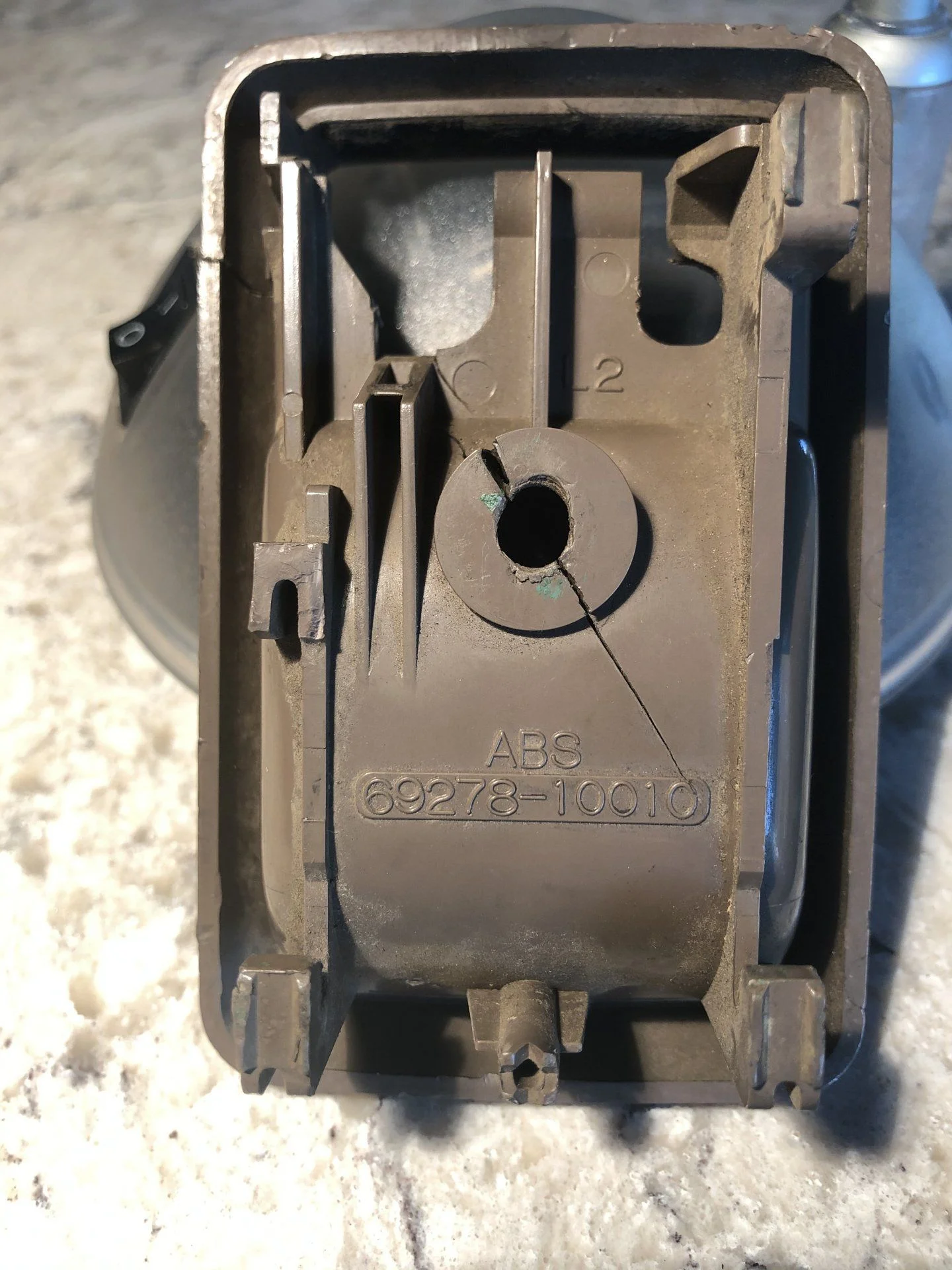

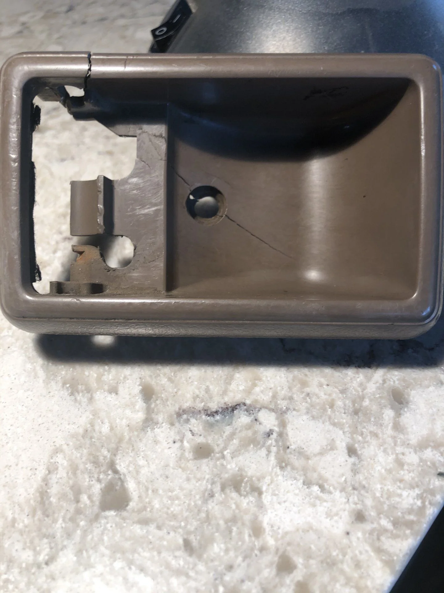

Trying to find the inside driver’s side door opener trim piece. Part number says ABS 69278-10010 but i can’t seem to find it. 1993 FZJ70. Thanks for the help.
69278-10010 is the part number for the bezel itself and is assembly line/supplier part number to Toyota.
Since it's color-coded, you will need the 2 digit suffix at the end of the 10-digit part number.
In this case, the suffix is -46.
The part number you need, then, is 69206-10040-46.
