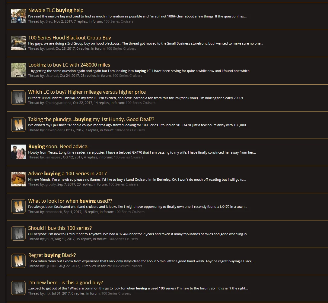

Hi all, I've tried searching the forums but can't seem to get a hang of it. Anyway, I am currently in the market of buying a SUV and I have narrowed it down to the 100 series (LC or LX470). I am located in Canada, so there aren't many options available. I am considering coming down to the states and importing one (as long as it's not over my budget).
From my preliminary research, it appears that 2003+ are the ones I want. I read something about an upgraded engine, and possibly interior as well - but could someone advise? Also, is there a link somewhere that gives a breakdown of each year like from here 4Runner.
Next, I am wondering what the reliability is for these vehicles. Like how much should I expect for maintenance each year, how much can I drive before the car "dies". Is 200,000 kms alot for these vehicles?
Any help is appreciated.
