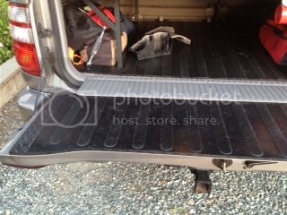

Another idea. I used a 1/8 inch sheet of black abs. Drilled holes similar to the existing particle board I removed. Used the existing fasteners and then glued heavy duty truck bedmat material to it. Very durable and washable, and stuff doesn't slide off. 80 bucks for a bed mat (without the wheelwell cutouts) was enough to cover the tailgate and entire cargo area.

http://i1260.photobucket.com/albums/ii574/1407driver/6c1b52bcd9657a4c5c4aac2c2283fd11.jpg
Hope that worked. Never posted pics before....
Trying again
Sorry, no pics of in progress...

Thanks, guys. If you go this route, I would recommend new fasteners. The rubber is heavy enough if you slam the gate too hard one pops loose. No biggie, you just slap the mat back in, but if you are OCD like me...
Oh, and carpet tape will not hold it to the plastic in the heat. Tried that first. No bueno
