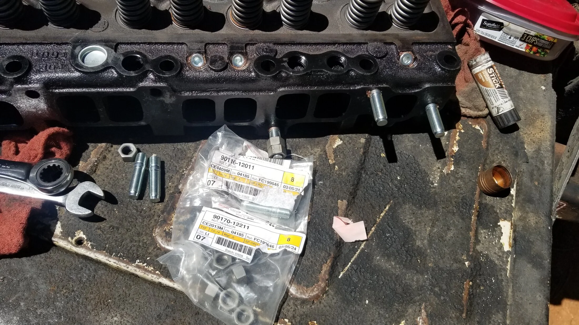

Just wondering if anyone is using Loktite on the intake/exhaust bolts/nuts. I have the new SS header from Pablo Cruise along with the Remflex gasket supplied with it. From what I have read torques from the center out at 20-23 ft lbs?

Nope, not Loktite. I use anti-seize on that stuff.

Throw that gasket away and use either an oem or fel-pro, then go with the torque specs in the fsm.
I made my own custom brass stepped washers to apply equal pressure to the two different flange thickness between the header and the intake manifold. I made longer studs to accommodate the stepped washer and the double man-a-fre header gasket that I soaked in warm water for about 1/2 hour to soften it up. I had previously planed both the header and intake on a big piece of glass with sandpaper to get them flat. I also use stainless nuts with hi temp anti seize compound torqued in 1/3. After I heat it up good by driving for a half hour I retorque them again. A few weeks later again a retorque. Been there a long time and have never leaked.
