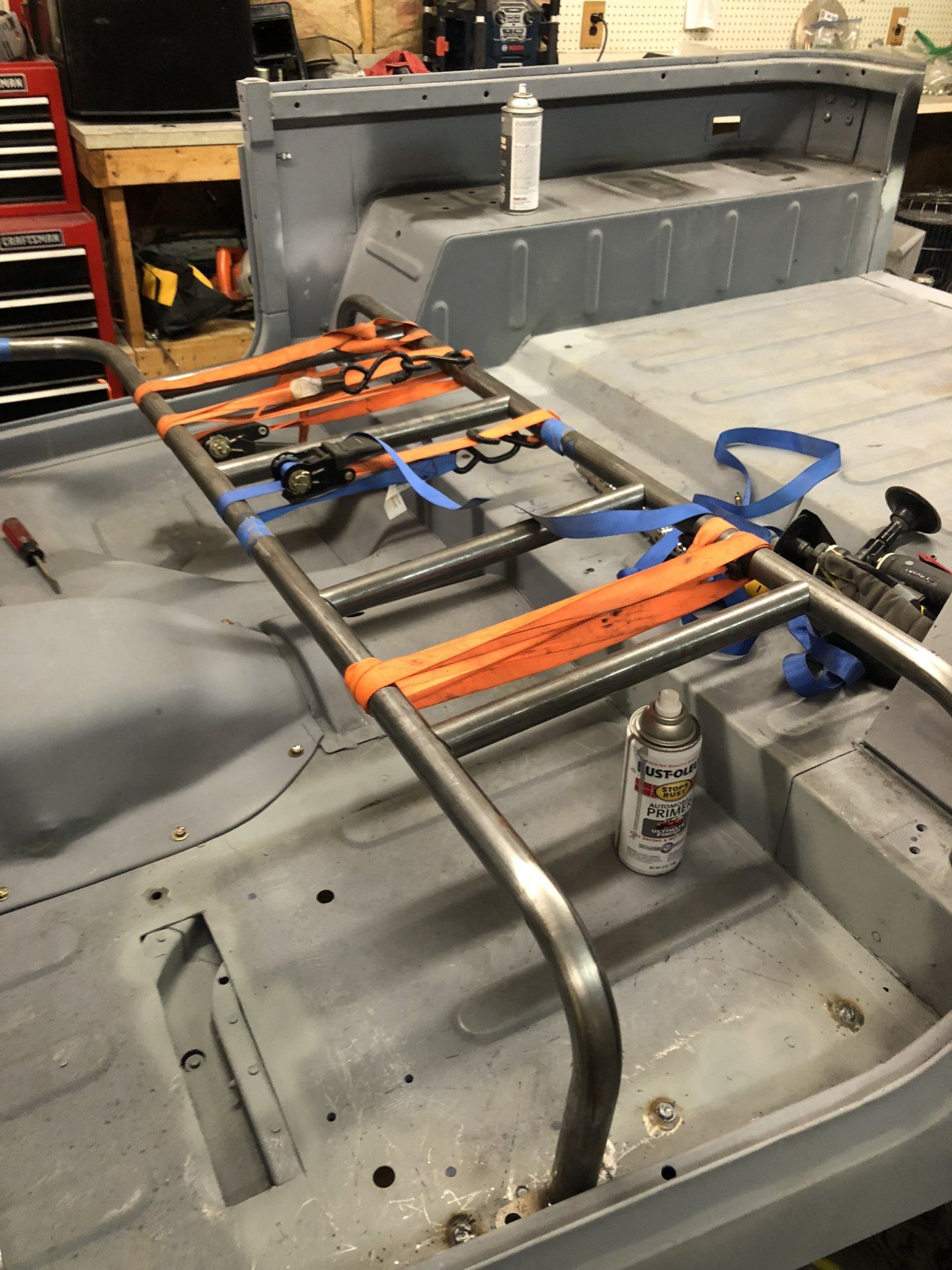

I'm in the middle of doing this to my 72 right now, I didn't care about my tool box so I removed it. You can go with the later model brackets but I don't think they will fit with the tool box install I could be wrong. Or you can go with a custom made bracket kit like I did. I will post up some pictures of my setup in a few. I'll be running pro car seats in mine if I ever get it back together.
Ps I have a full set of later model brackets if you decide to go that route.

Yes, the tank was under the seat all the way up to the 80’s I believe. I’m running a aux tank in mine so I have removed the gas tank and door as I won’t have a tank in the cab. However the kit I got will work with the tank in the car. I can take more pictures if you need me to. I’m waiting for my seats to come in so I can mock everything up.

Interesting as I thought it was sitting up a little high myself. I was thinking about trimming a little off each of the legs before welding everything together.
Do you have any pics of your setup?

I am actually looking to gut the bottom of my passenger seat soon to lower it, right now it sits about 4” higher than my drivers seat. I fanned up both of my brackets and made the passenger seat bracket as tight as possible to the top of the fuel tank, nevertheless with to power controls on the bottom of the BMW seats it still sits too high.
@Xpnsv72fj Josh, test fit those seats and brackets with the body parts assembled, the top, doors, windshield frame, all of it you can. It will pay off in the end. My drivers seat is spot on, it was the struggle with the fuel tank that shot me down on the passenger side.

Just what is in my build thread.
Also in there you can see why I've ditched the factory tool box, there was not much of it left. To mount an aftermarket seat to it you would have some challenges beyond seat height. You'd almost need a boat seat that folds all the way down, especially if you added a roll bar there

Josh, I assume you fabricated your seat bracket. Nice job.
