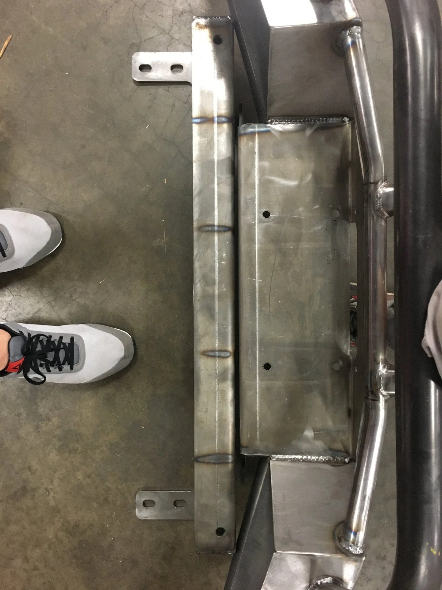

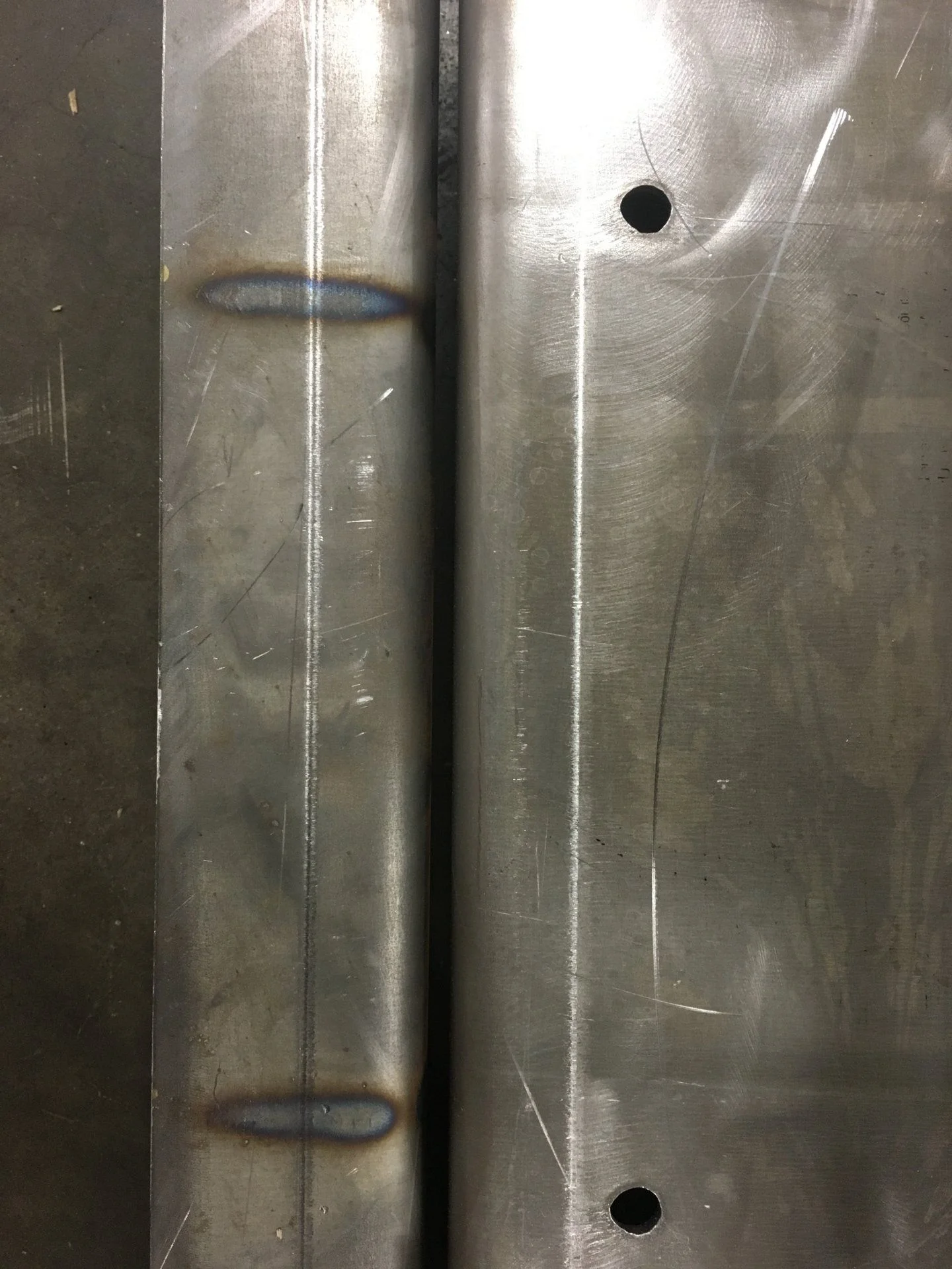

I got the bumper this morning. It looks good, but the frame mount it hitting the sides of the bumper before it sits flush, leaving about a 3/8" gap. The stinger is 1.75" diameter. Here are the pictures that people were asking for. Let me know if you have any other questions.

I am planning on cutting the corners that are hitting at an angle and then welding a plate in. We have the ability where I work to do this so it shouldn't be a big issue. I don't feel like test fitting before powder coating so I will keep my fingers crossed that everything else fits as should. I appreciate your concern but it seems like an easy fix.

Is this something that can be bent or pounded to fit?

I could have installed spacers between the bumper and mount plate. I ended up just cutting a portion out of the mount plate on each side. I was worried that I would have to trim the frame rails if I angled the corners too much. The OP had no issues with his, so this could have been a one time issue.

I got the bumper back from powder coating and installed it today. I am very pleased with the looks of the bumper. The install took a little extra work because this bumper is designed to fit a 98-02 LC. I emailed Scotty about the issues and he responded immediately and asked my to give him a call. He said the bumper was designed around a 99. I offered to modify his drawings for 03+ and he will send me a new bumper with my design changes and I will make any additional modifications and update the drawings again at that point. I am lucky enough to work at a company that does metal fabrication. The previous issue I posted about seems to be a fluke and he will send me a new mounting plate as well. I am very happy with the outcome and I look forward to helping him make the design changes necessary for 03+ vehicles.
