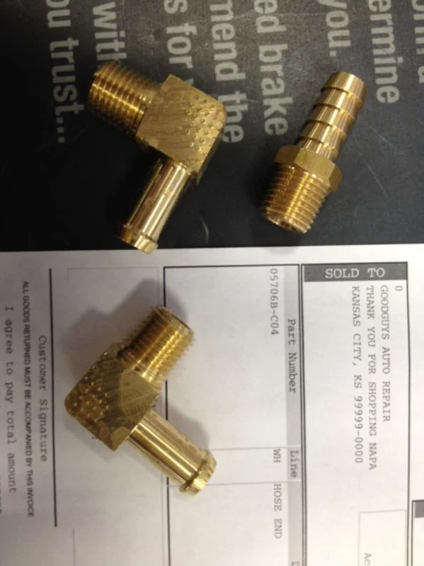

Found it in NAPA

What size barb am I looking for on these fittings? Anyone have the NAPA number?
They are just 3/8" male thread to hose barb fittings used for air tools. Find them at any hardware store, the filter too.

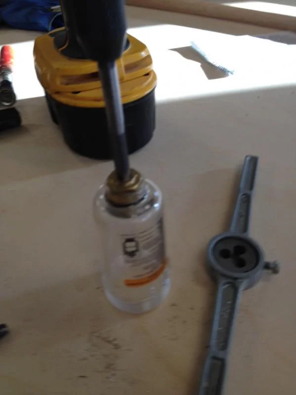

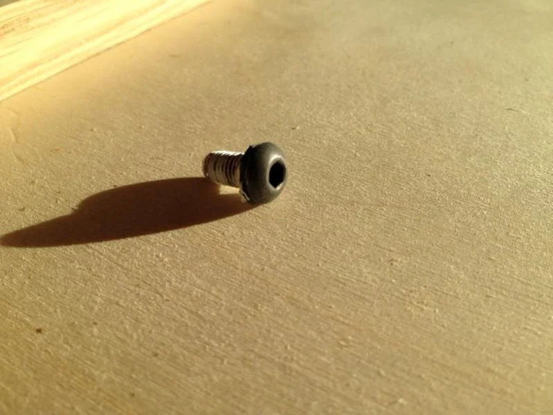

Pics of my try
So I took out the spring-loaded valves, then threaded the brass insert with 1/4 28 threaded Cap hex bolt. The brass would spin so I took it out and put it in a wood vice to do the tap work. Had to use some epoxy to glue it in and keep it from spinning when putting in the Hex bolt.
Made a rubber washer to seal it up, as it was too late to go to Ace Hardware.
I put on air fittings and it held tight at 60 PSI.
This way if the bottom glass bowl ever seizes up , I can just pull out that hex bolt
