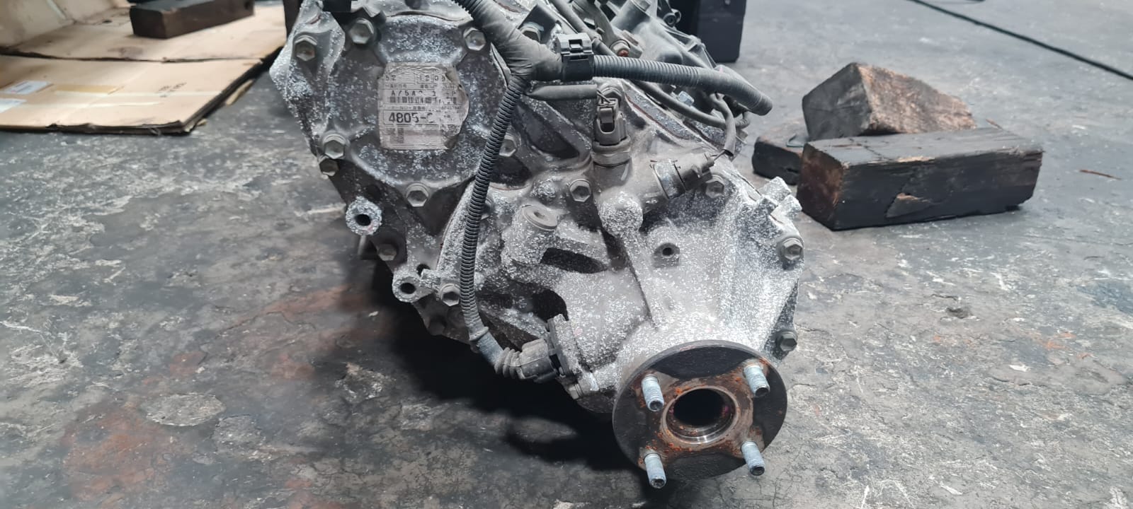

I want to swap both the engine and 5 speed gear

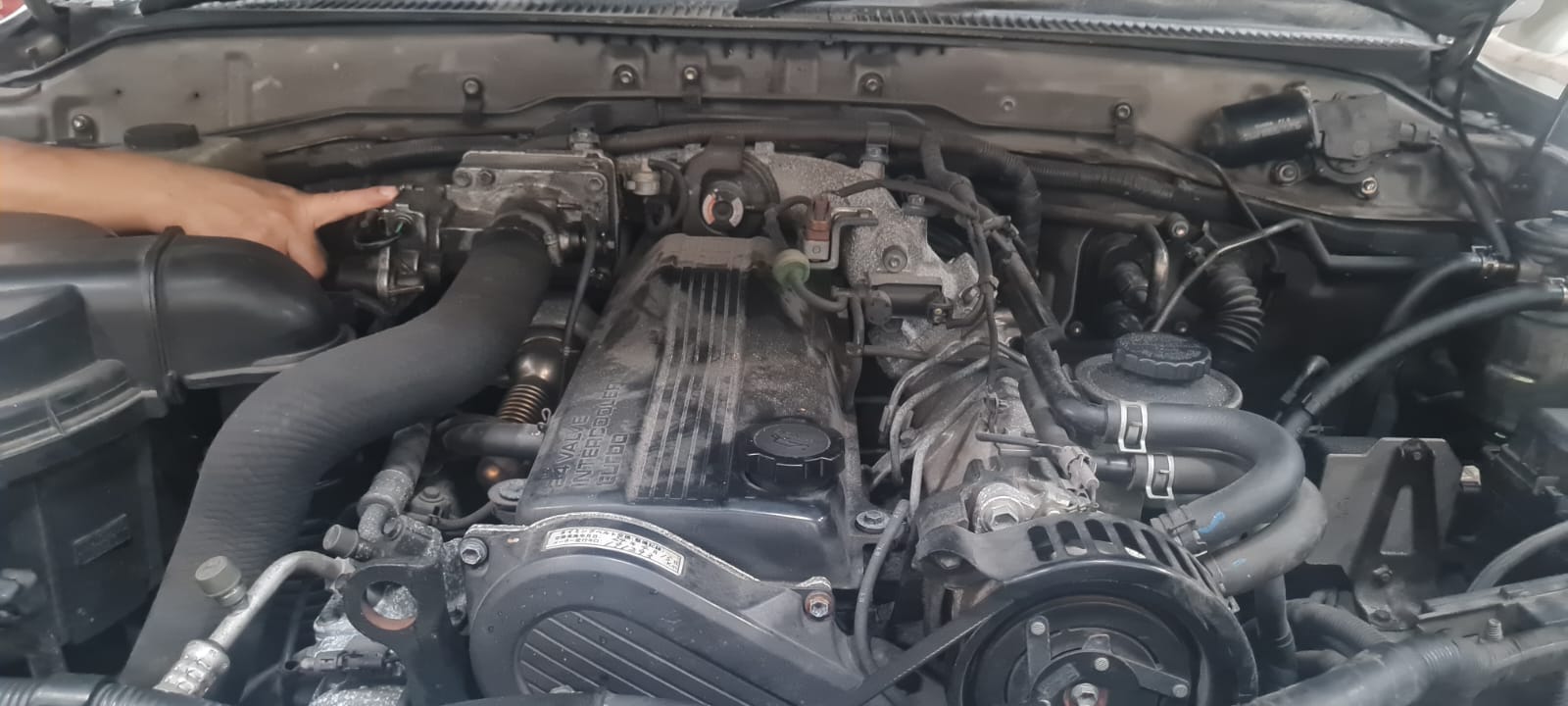

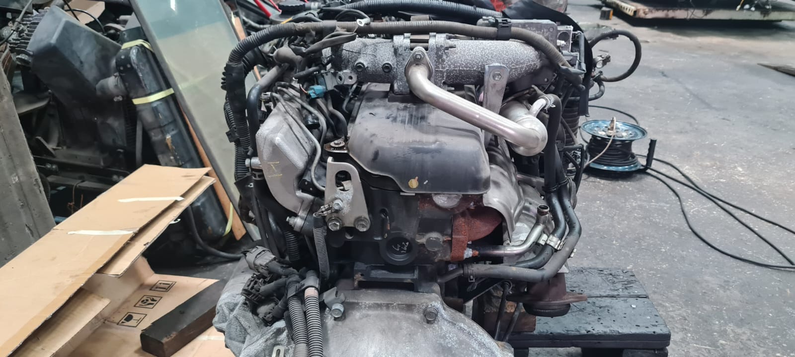

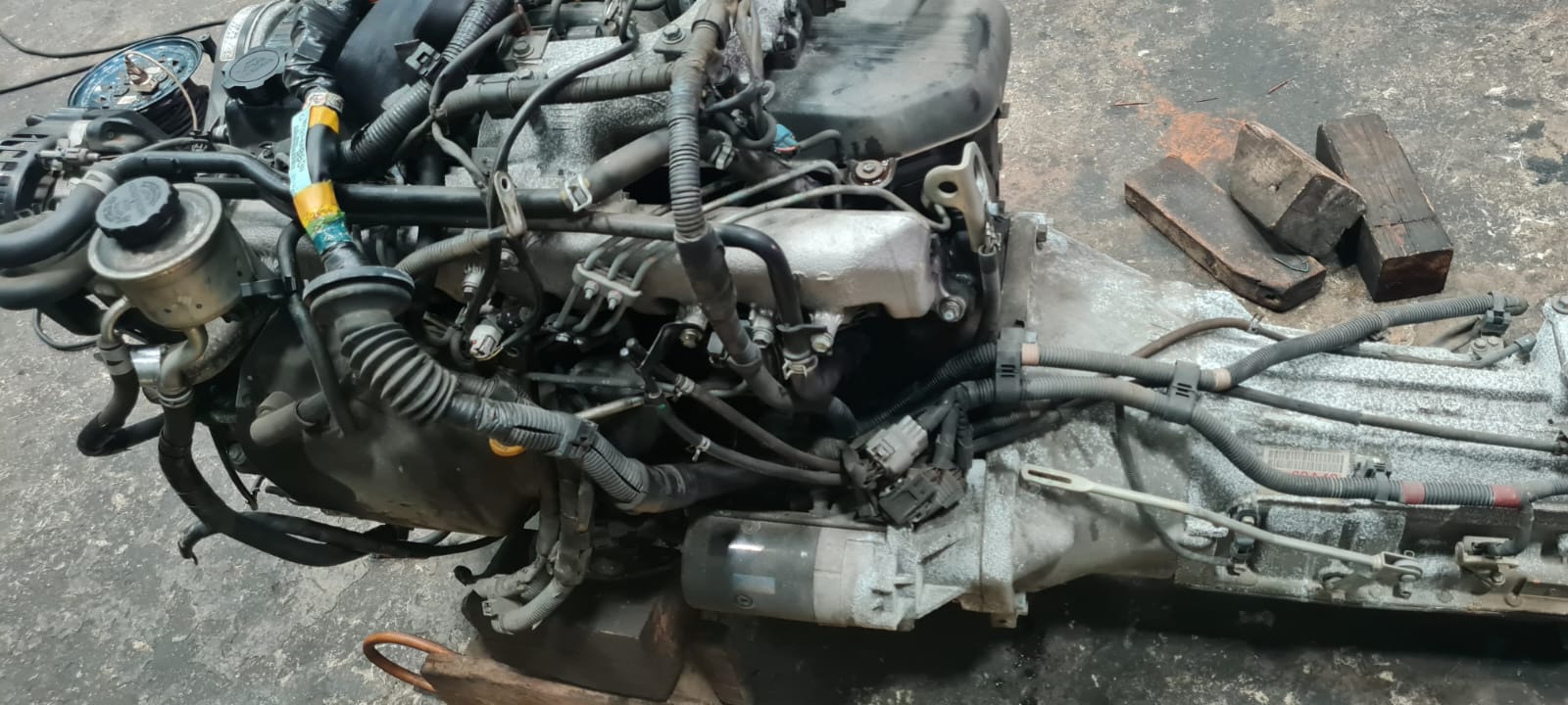

Thank you very much for your advise. It is very helpful. I just bought the engine and the gear. It has been imported from Japan and it is still in the car. It comes with everything.
Planning to use the dash from 100 with some modifications to the console.
I say one and the guy had moved all the sensors from the 100 to the 80 for the immobilizer. The key will be changed to the 100.
I have a choice between the 3 engines. Waiting to start and check them.next week.

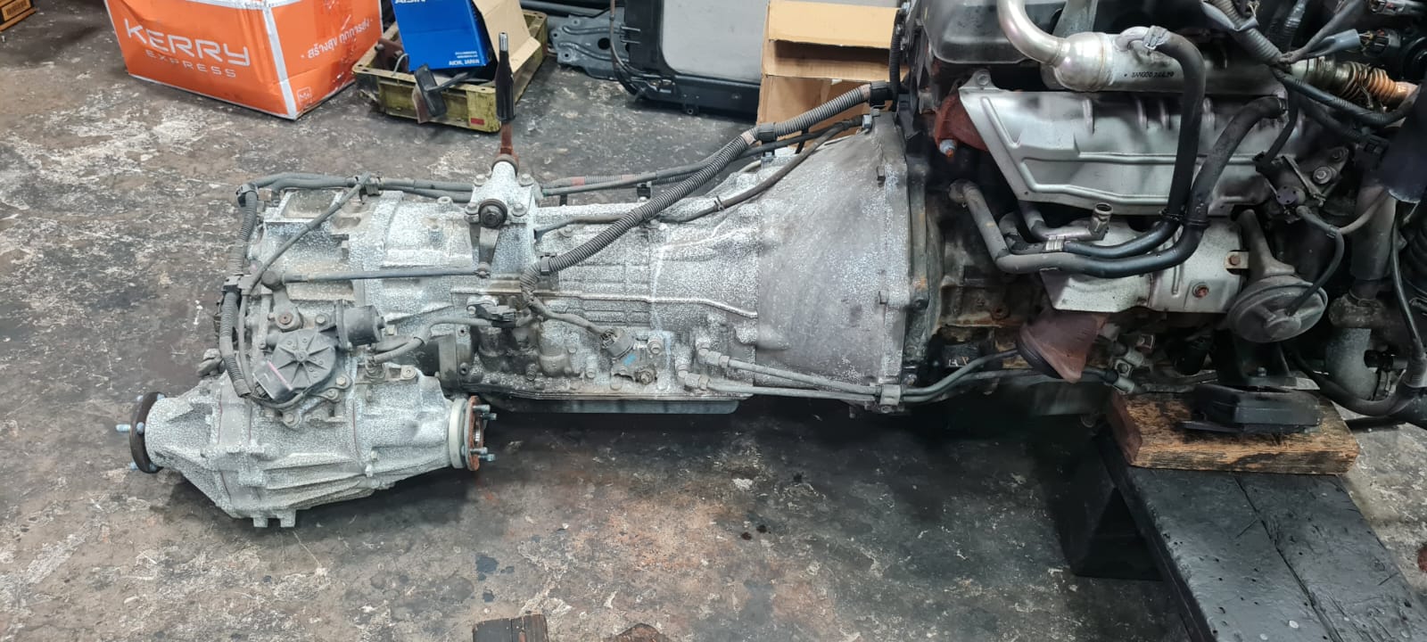

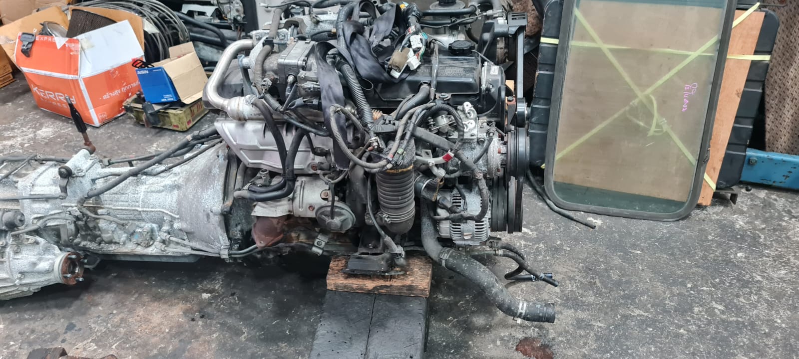

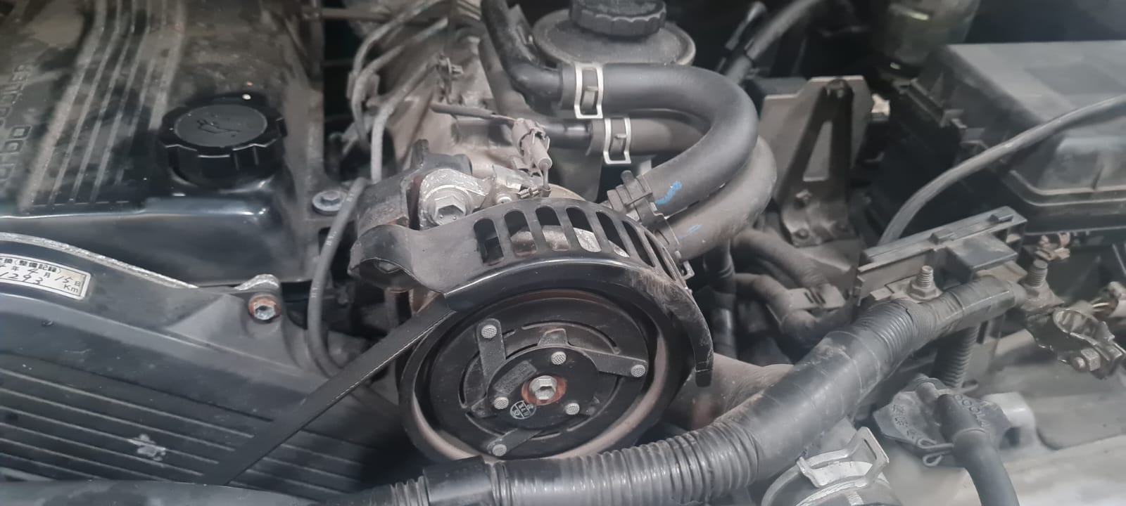

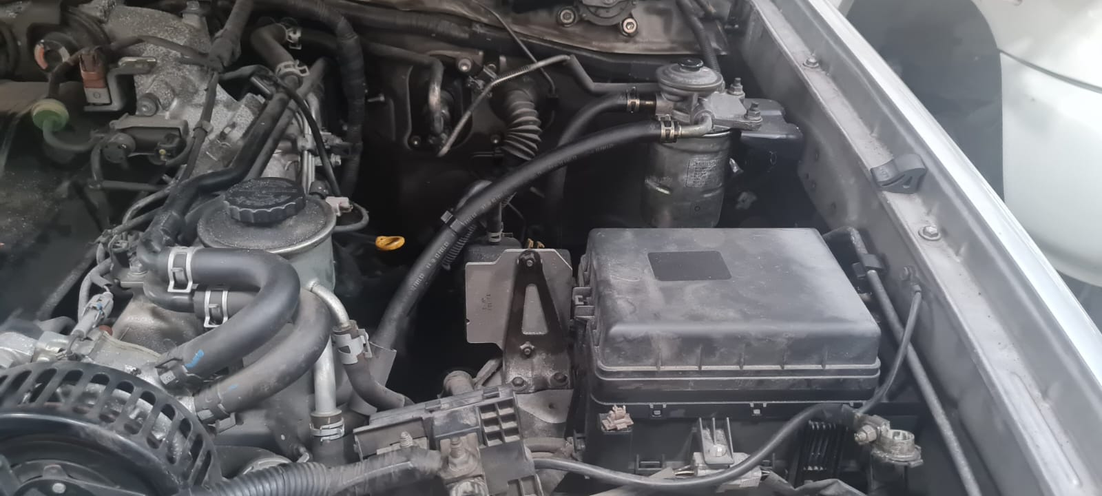

The project is now complete. I successfully installed a fte with a 5 speed automatic transmission in my 80 series. If took me 6 months to complete the project. I am happy to say that I am having a lot of fun with it. The power is amazing so is the fuel
Consumption. On my last 2000 KM trip is got an average of 10.3km/ltr (I did push her a lot). On my previous trip (80 - 110km speed) I got 11.3km/ltr.
I will add a few pictures soon.

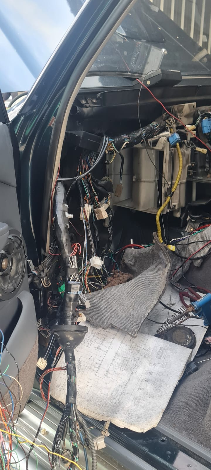

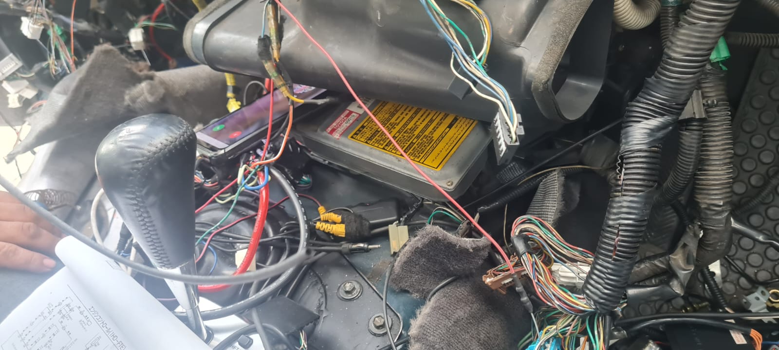

I did not get rid of the immobilized. It is in the car. The original key from the Fte engine is inserted and is kept behind the console. I use the key from the 80 series to open the door and start the engine.
Everything works as normal except the 2nd start and cruise control. Waiting for a module for those 2.

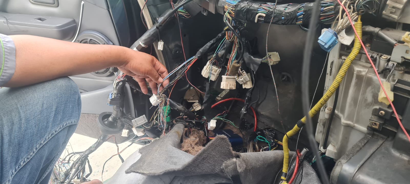

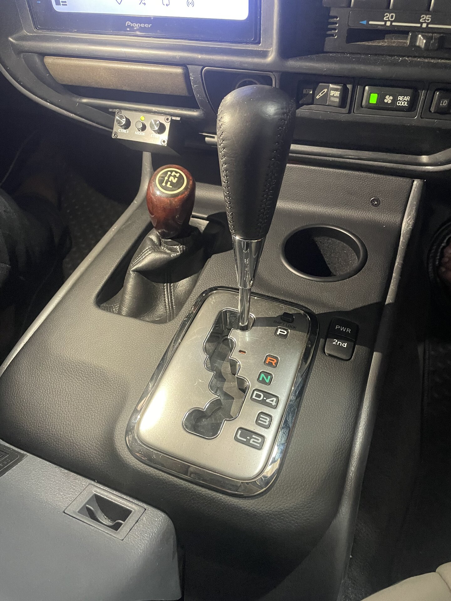

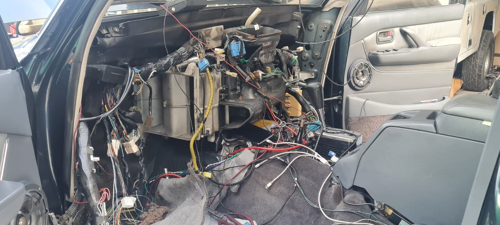

Had to customs build the wiring. Have combined the wiring of the 80 and the 100. Very happy with the result. Got a custom build center console and looks good. Will be adding pictures soon.

Wow. You kept the viscous heater too? Does it work? If so, I'd love to hear how you wired it to work without the 100-series climate control connections.
Hi
Yes it does work. Had to do a bit of a custom work to make it work. We got the wiring diagram of both the cars and matched the wires to make it work.
