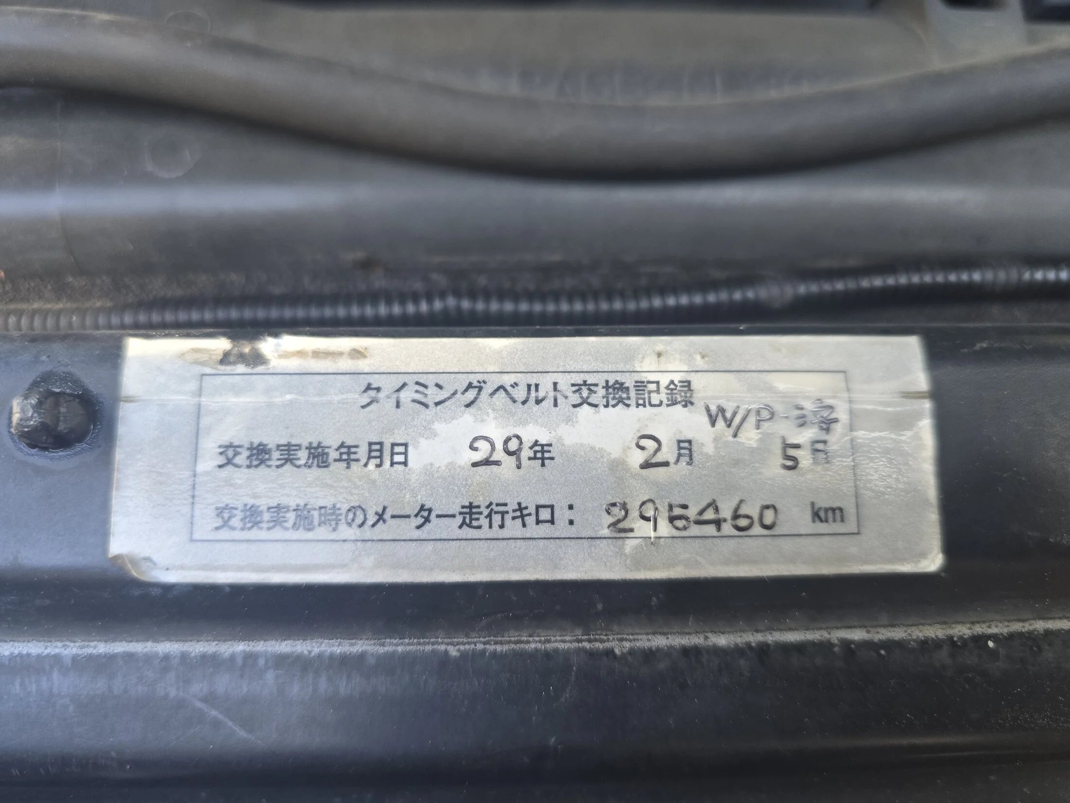

Well I feel like slight dumbass, I ordered the timing belt and water pump kit before I got home to see the truck myself. The only sticker I saw in videos was on the timing cover, had two more on the core support.
Last changed at 295,000km. I guess I'll have one on the shelf for when I need it.

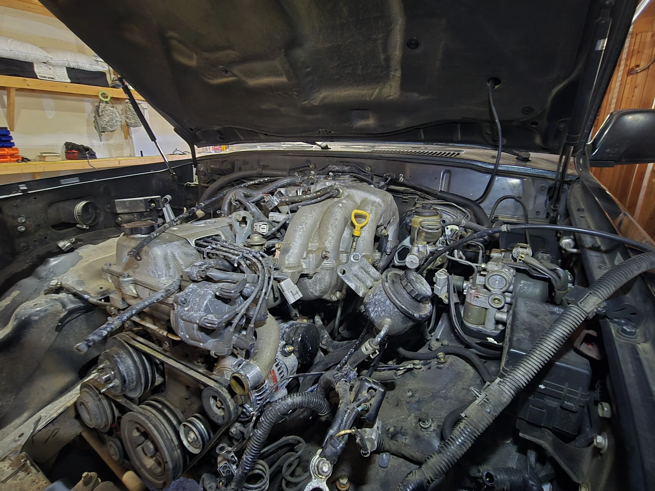

This weekend im going to start tearing into the 80, my goal is to have everything prepped to pull the engine when im ready.

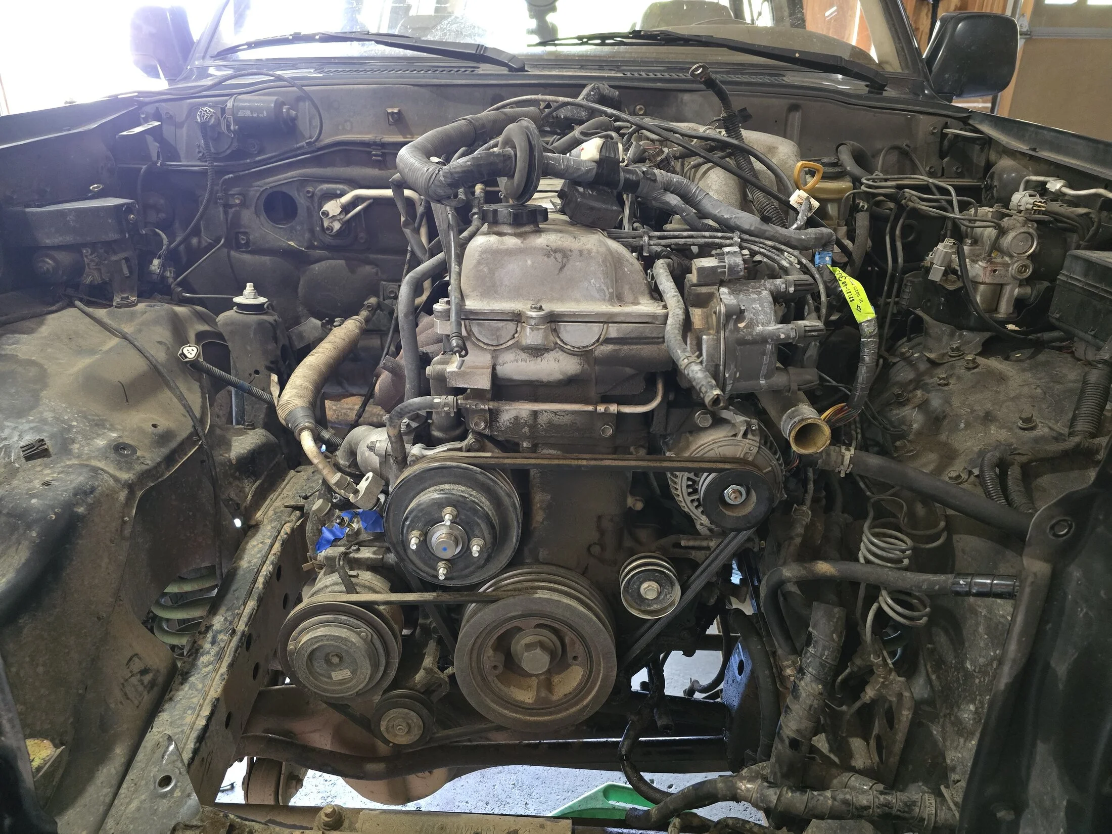

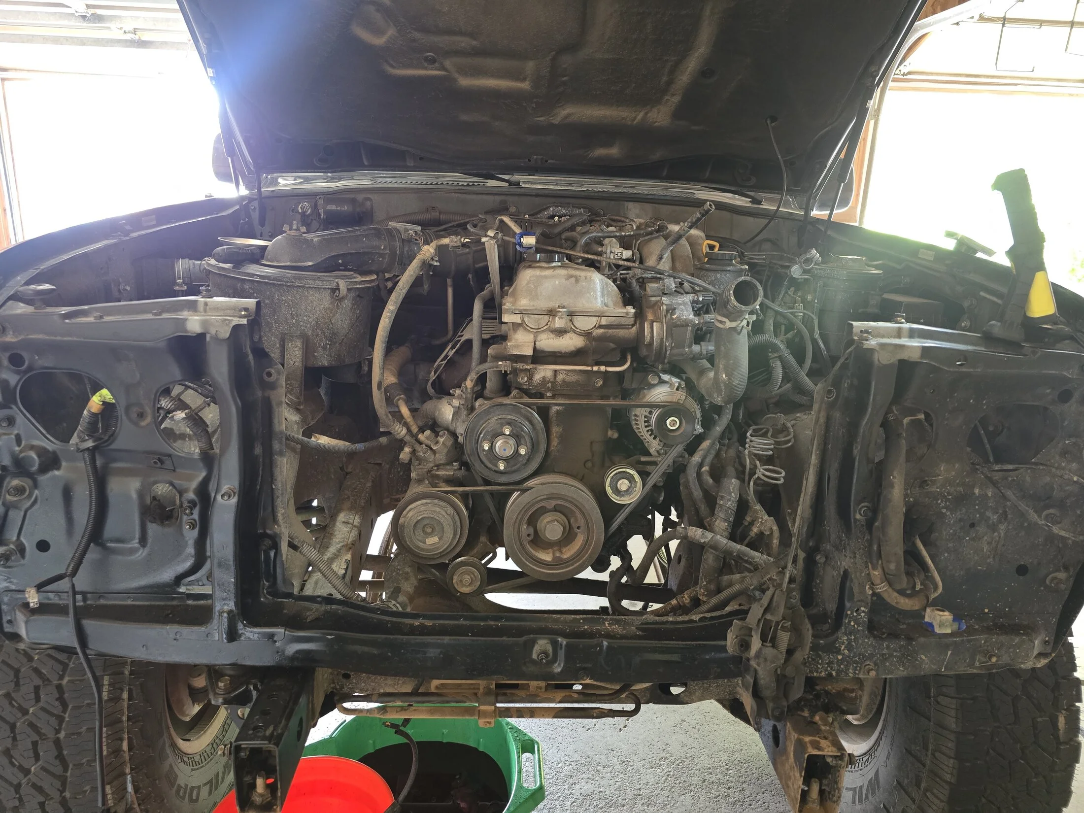

Her current state, done for today, got this far in about 3 hours or so. No fancy tools. Just hand tools made it go a little slow. But its progress and I've made the leap.

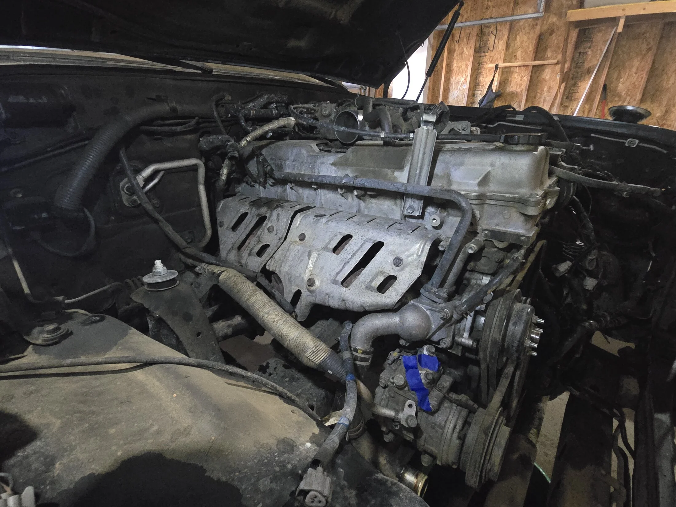

We're getting closer to pulling the motor, got the rest of the wiring harnesses and connectors dealt with, drive shafts are out, which were an absolute bear...
Got the exhaust disconnected at the collectors? Where the manifold meets exhaust, whatever that's called.
Tomorrow im going to start with the shifter console, and the rest of the small things that has to be done from inside the rig.
Following the Holy texts to make sure I get it right.

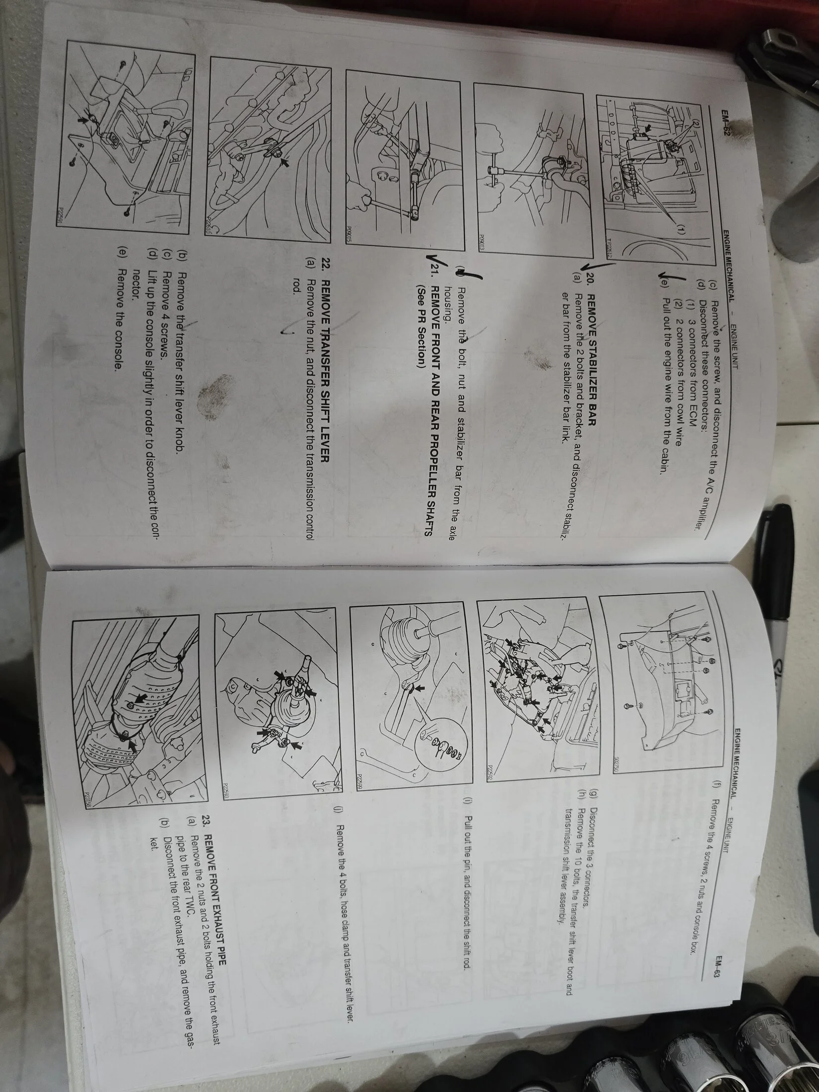

It hasn't been too bad, I think I'd be more meticulous if I was worried about getting the 1fz back in, for right now. If I pull a bolt/fastener I just thread it back into the body once I've removed whatever I've had to, I'm always taking a s*** load of pictures which I then mark up and save with more info if I need it.
Tomorrow the goal is to have everything done except the trans cross member, saving that until im 100% ready to pull it.

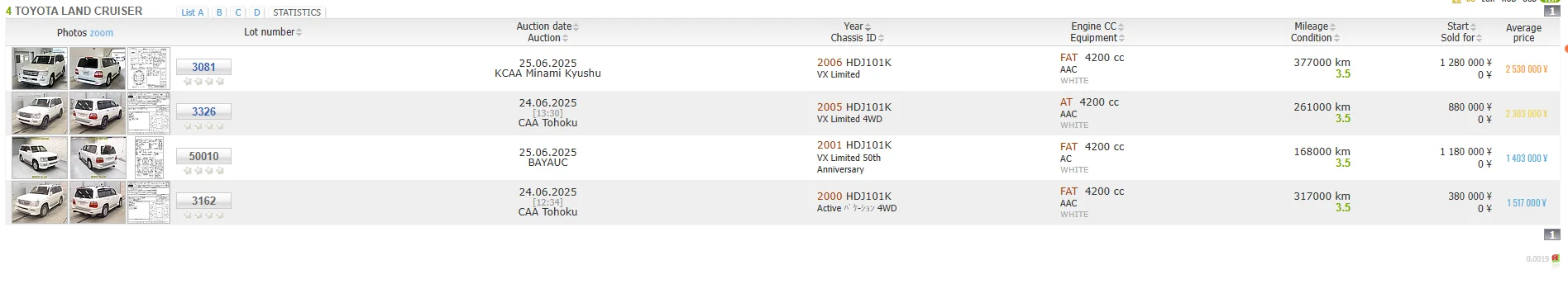

I highly recommend Import Quality JDM Cars from Japan | Japan Car Direct - https://www.japancardirect.com/, make an account and start looking at auctions, you can get an idea of what HDJ100's are going for, I got mine pretty cheap. I think average was, at the time around 11-12k USD. Lower mileage nicer ones would go for 15k tops usually. I saw a few as low as 6-7k but they had problems most likely.
Thank you. I will take a look later tonight.
