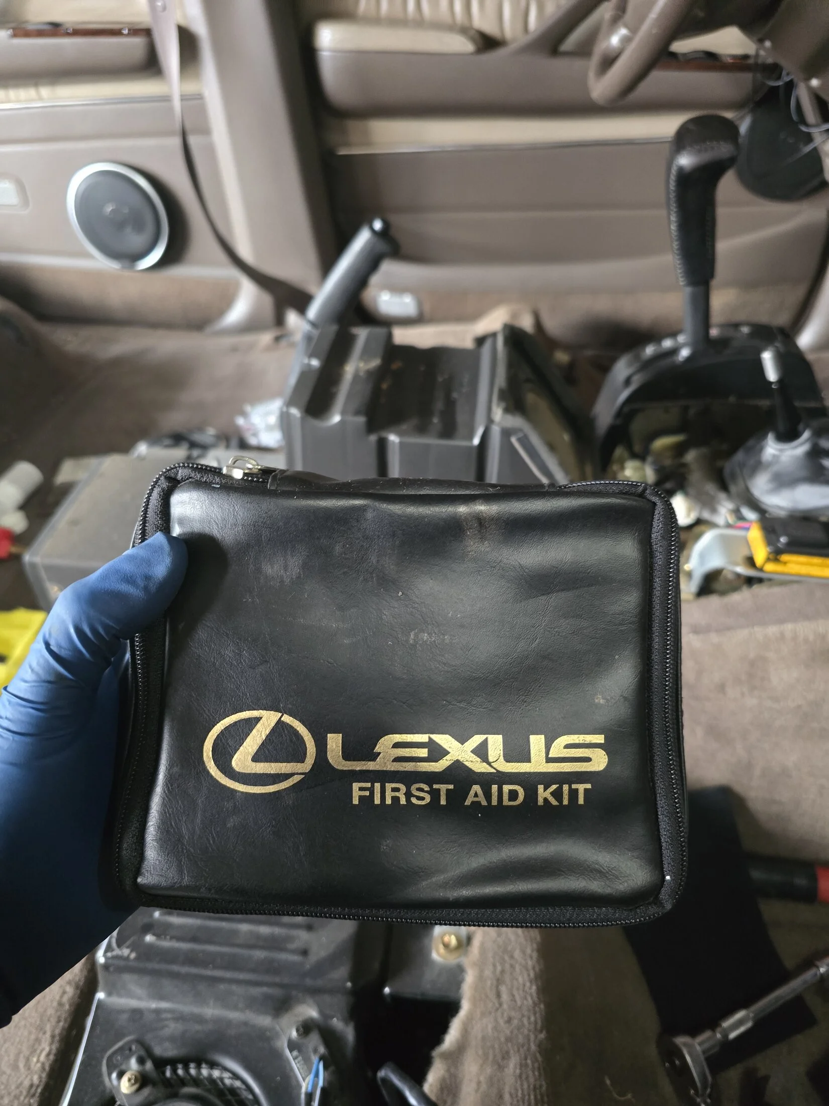

I was just going to pull the shifter console but said screw it. I've had some killamat laying around forever so im going to put that down sometime.

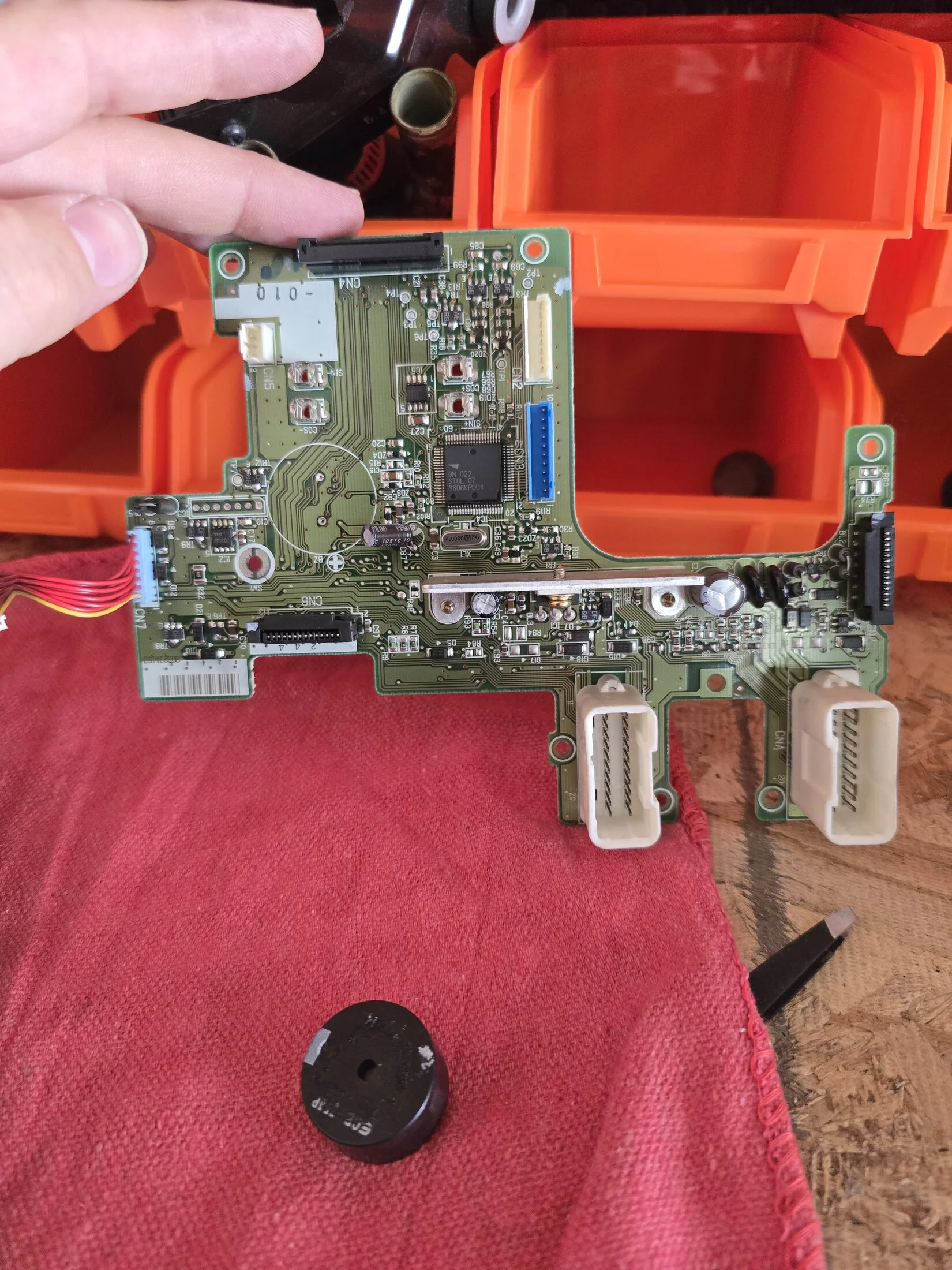

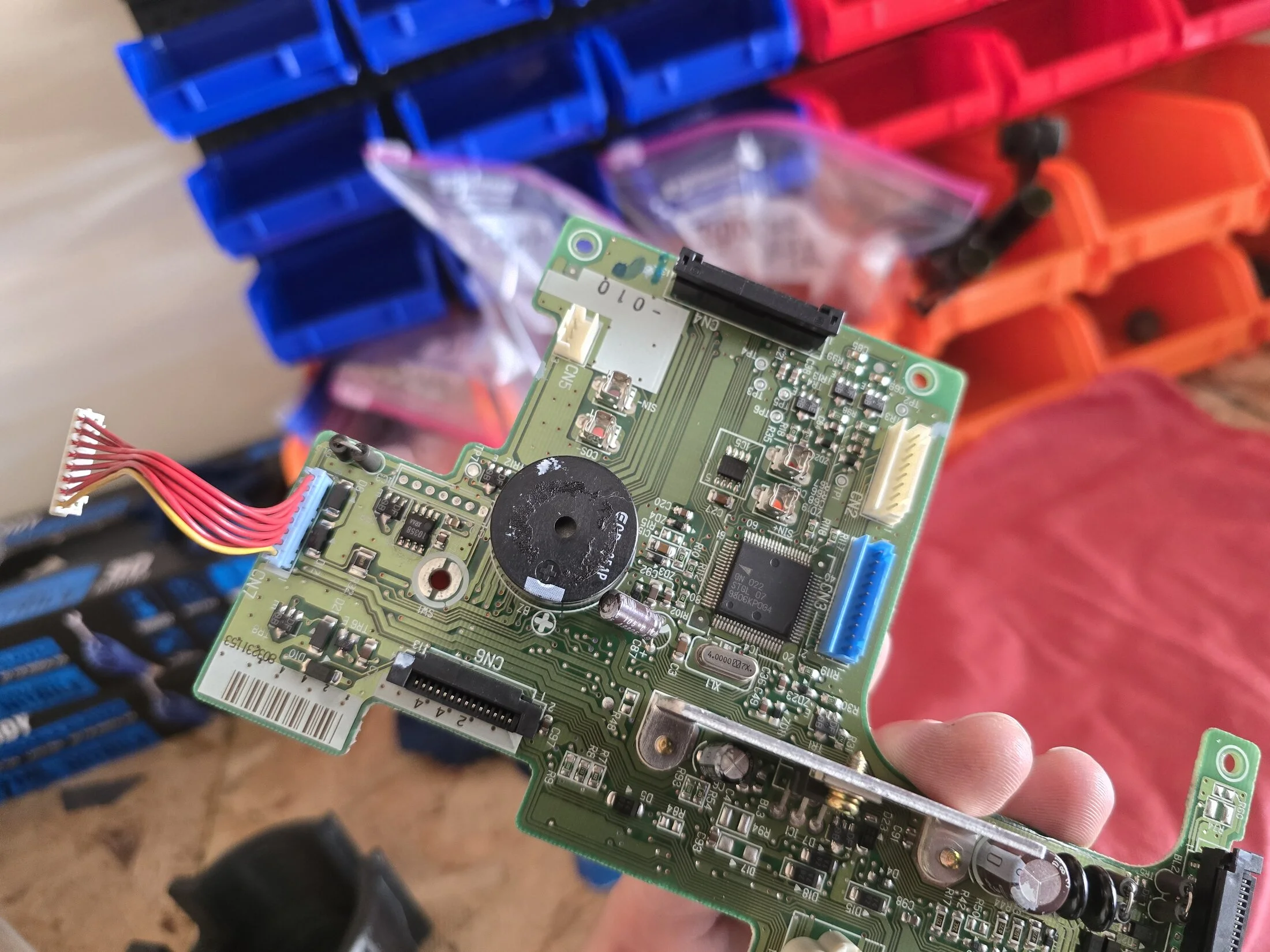

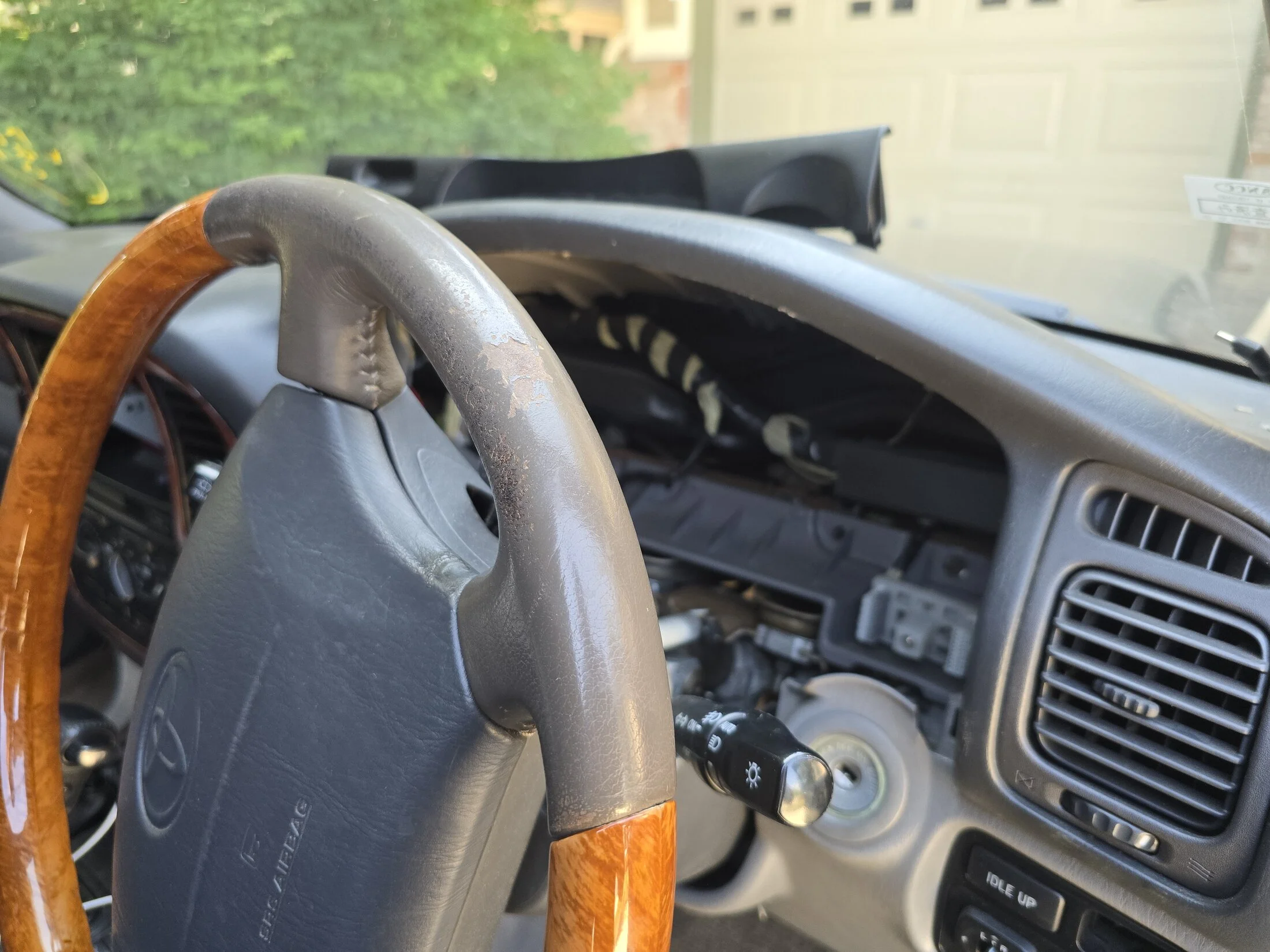

Today's sidequest, some of the early Japan spec HDJ100's came with a over speed alarm, and reverse alarm. That speaker is built into the cluster circuit board. Not anymore though.
I've been driving the HDJ as a daily, so its been annoying as hell having to hear a chime go off anytime you go over 62mph.

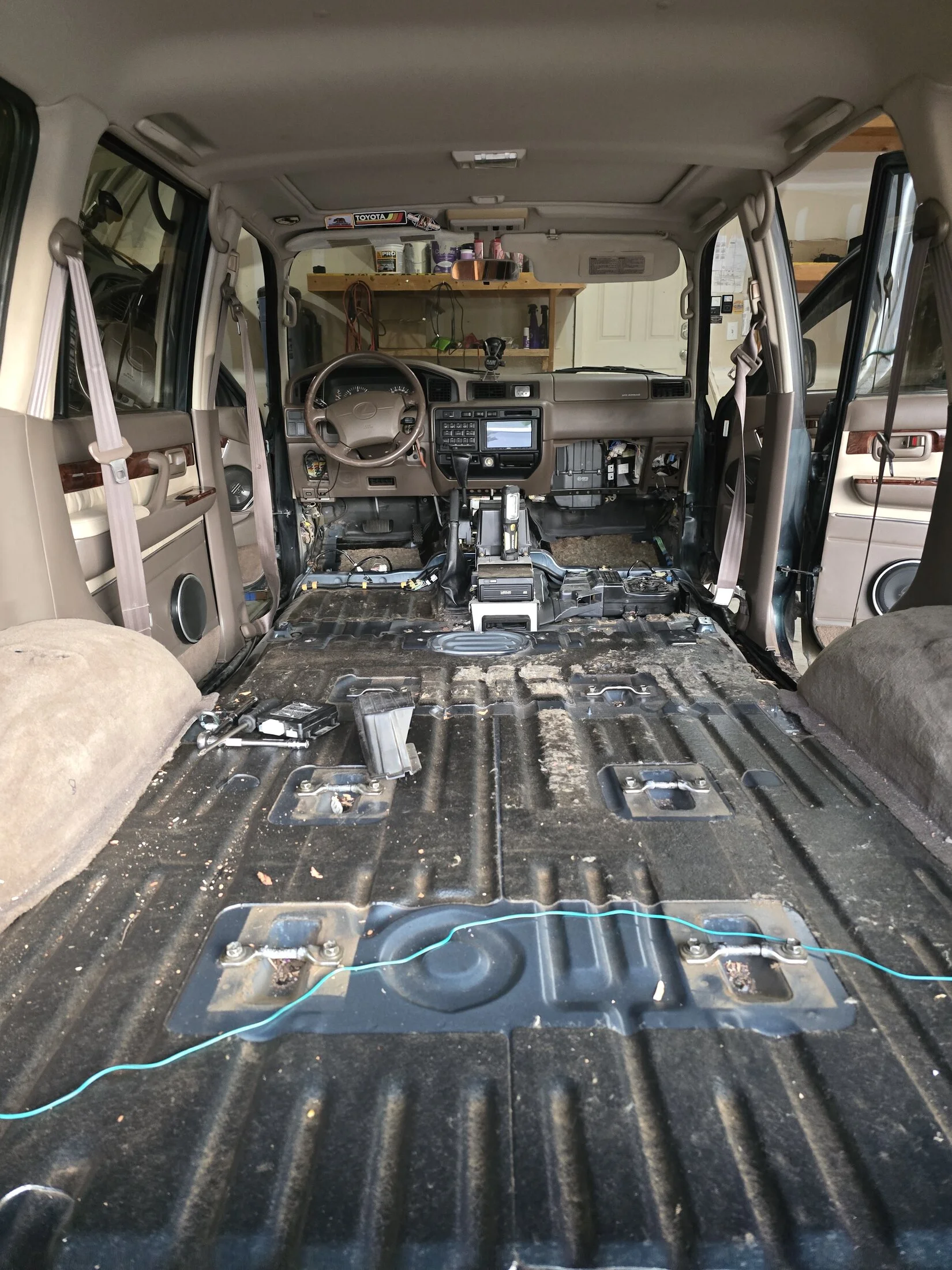

Stopping here tonight, have a few more connectors to unhook on top of the trans, and maybe pull the transfercase shifter.

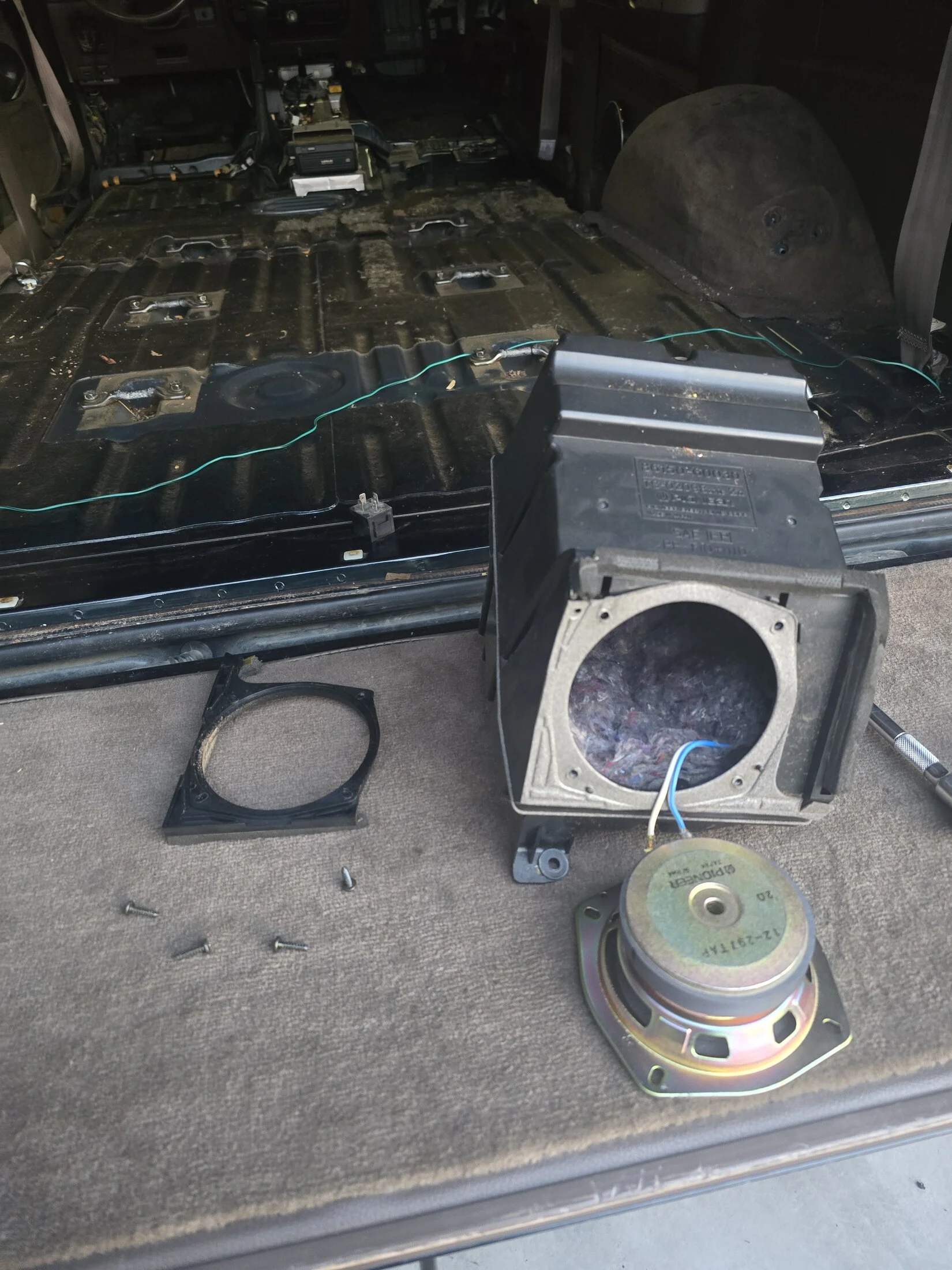

Pulled CD player assembly, speaker assembly and transfer case shifter
Measured the speaker for the center console.
Ordered this pair, we'll make one fit, ill just wire the speakers into the fronts. If it sounds like s*** ill just disconnect it.

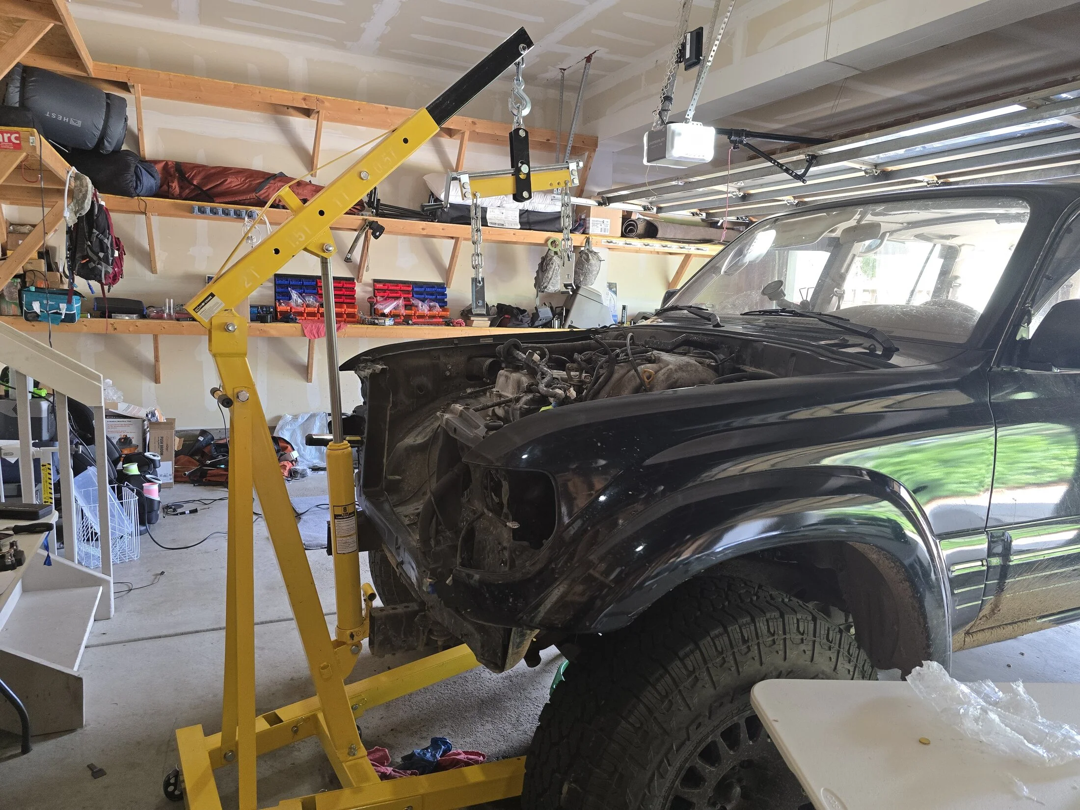

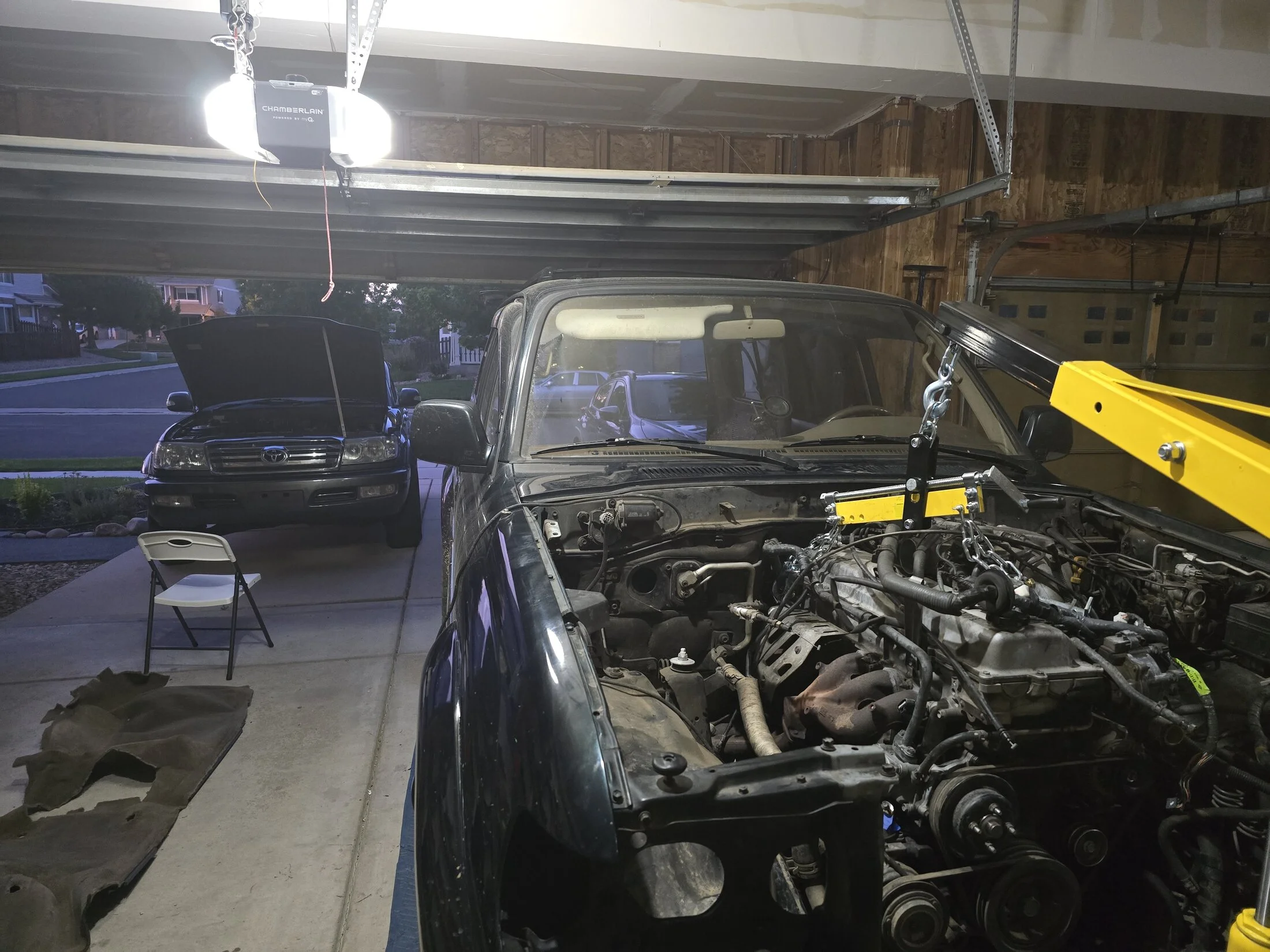

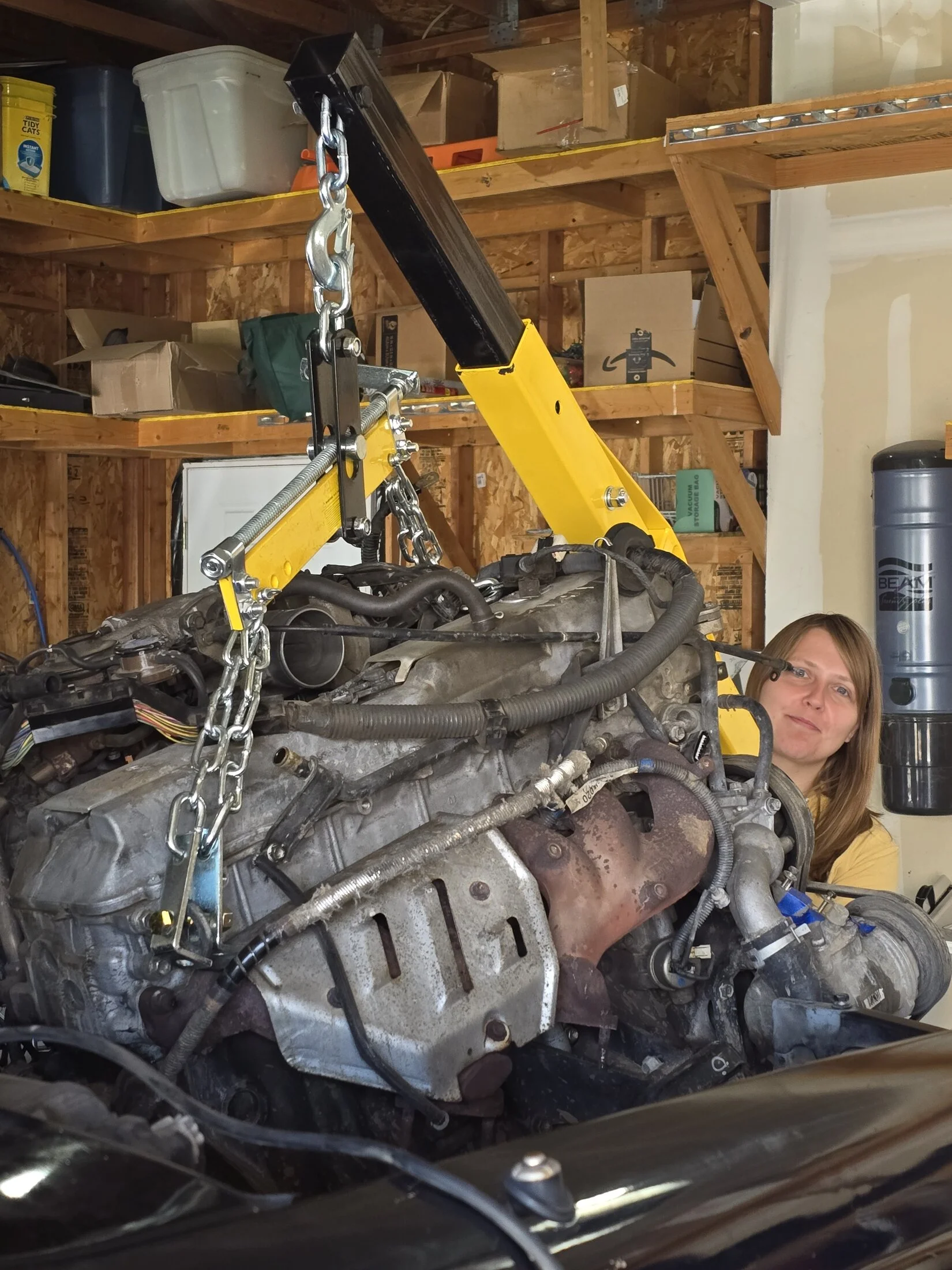

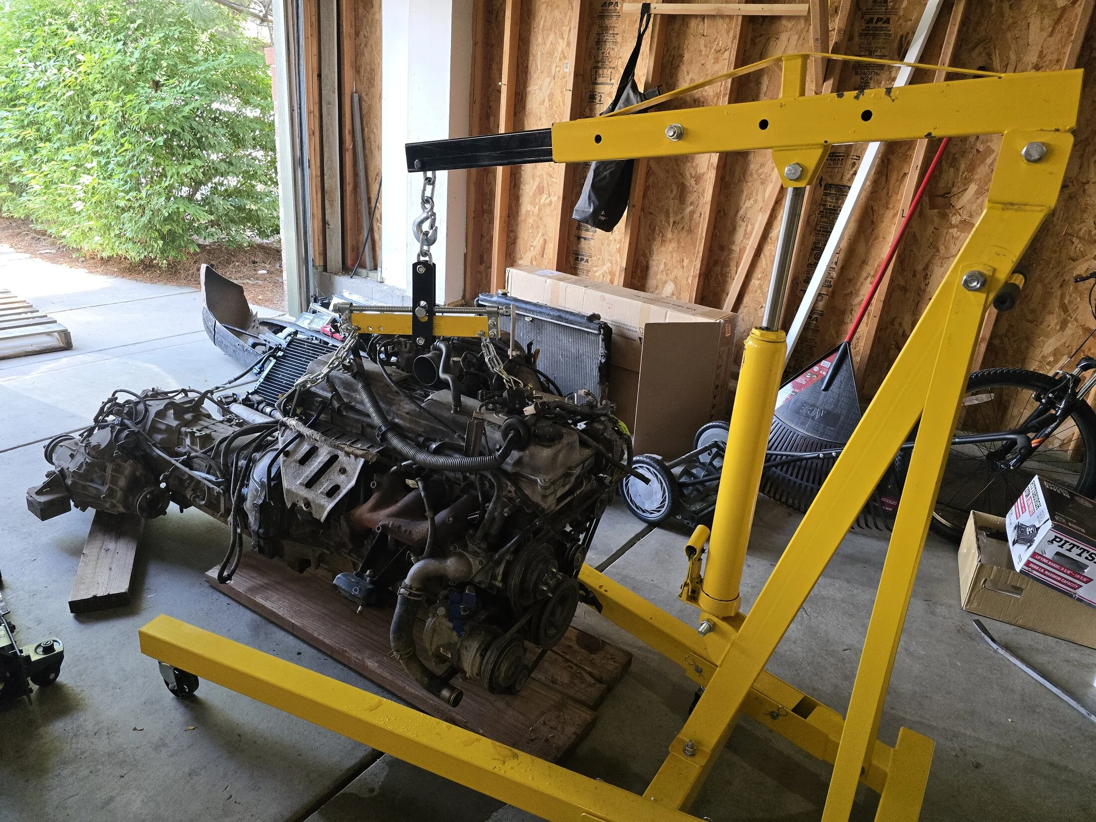

And the state of things, pulled it all together, once i actually had it ready to pull, if only took about 30mins or so, got hung up on the exhaust for a sec, had to take pry bar to it so it would let go, then it got hung from the transfer case at the front core support, took the air out of the tires, and i was able to lift up on the transfer case and push while she pulled the cherry picker. She's out.
Now for the slow part of the build, im going to clean up the engine bay, and the interior, i sent mick fte a message on FB regarding a harness, so we'll see.
Is there anything specific youd replace while you have the room? Let me know.
My wife was a huge help
Also, I'd like to say, if anyone wants to do this, but feels like you may be over your head, just do it. Buy the FSM, get a few hand tools. I have nothing special in the tool, department. Just the basics, and was able to make this happen.
This is also the first time I've ever pulled any engine, plenty of youtube how-to's as well.
