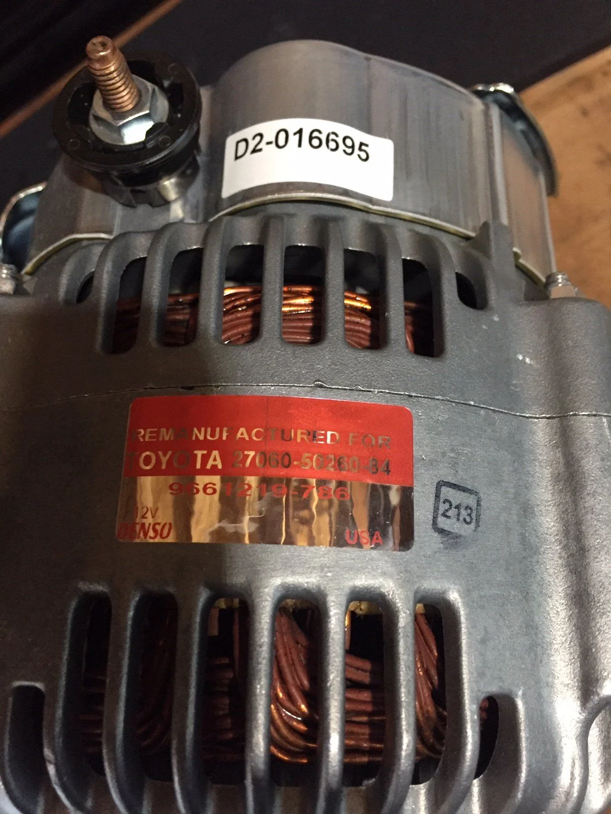

Before I put it in, I thought I would share some pics and some differences from the O'Reilly's Ultima brand reman that failed on me. I wish I had gotten pics of the Ultima before I returned it to O'Reilly's.
Here's the top of the case, and you can see the charging lug and sticker. Remanufactured in the USA, as indicated. This looks identical to the Denso 210-0565, based on photos of the Denso. Compared to the Ultima, the plastic collar on the charging lug is identical to what was on the original factor alternator, and different to what was on the Ultima. The factory plastic cover piece did not clip on to the Ultima correctly.

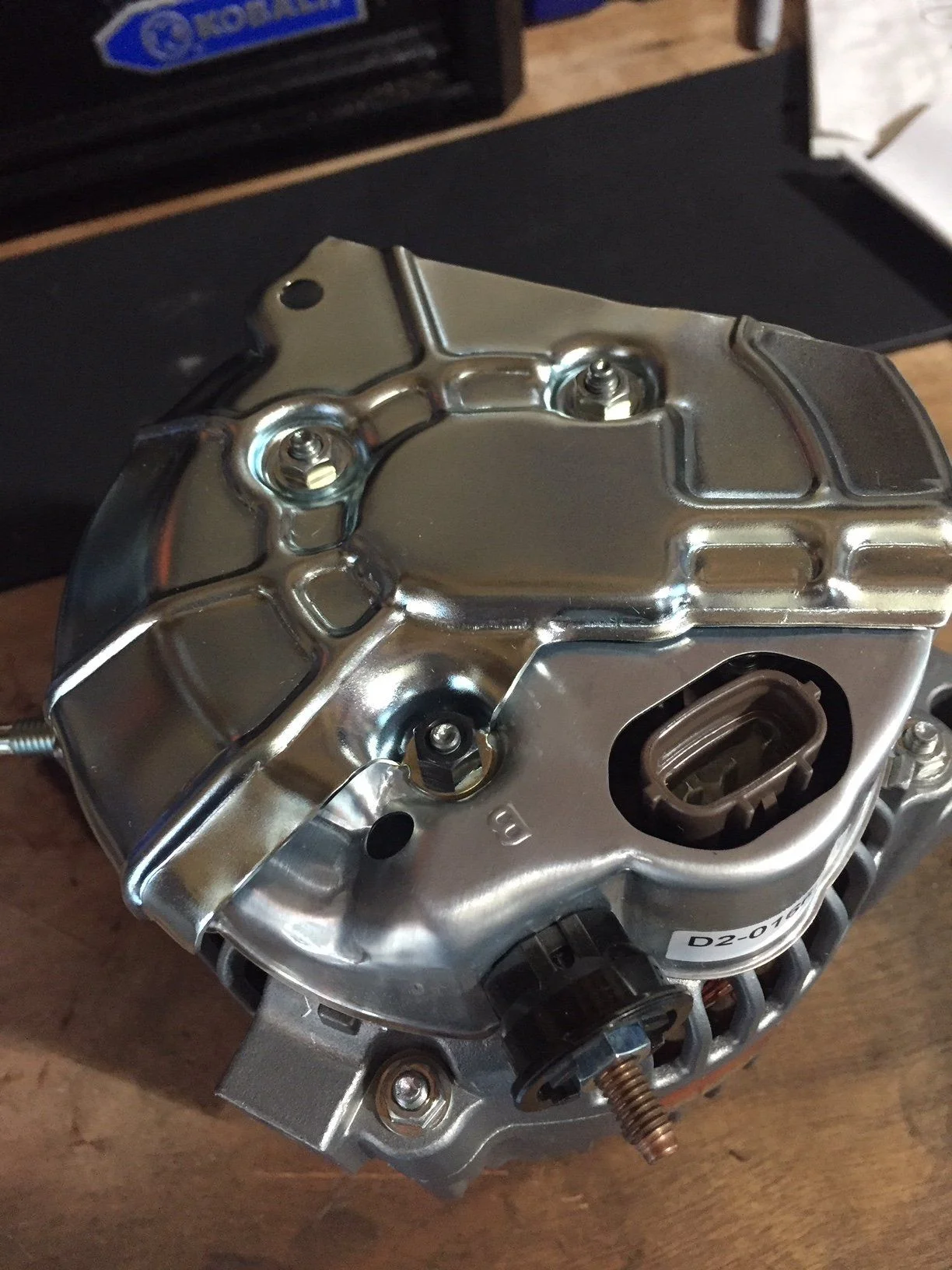

Here you can see the correct outer heat shield. The Ultima did not have this, and the studs to which it mounts were too short to allow it to be mounted.

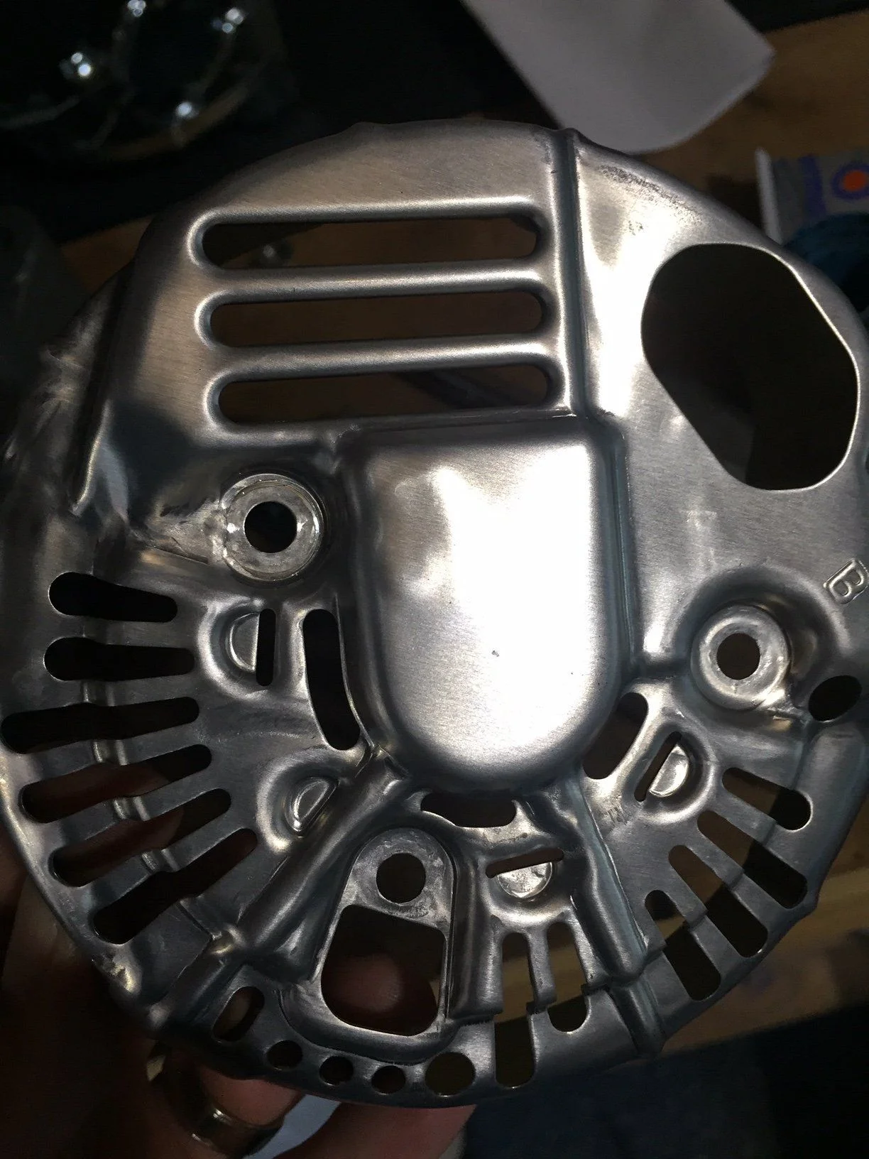

Here is the rear cover, which is a new piece. Note that it does not have "ND" Nippondenso logo that the original would have had. The Ultima was a Denso core, and it had the original rear cover, which was painted gray. It did not fit as tightly to the case as the this one.

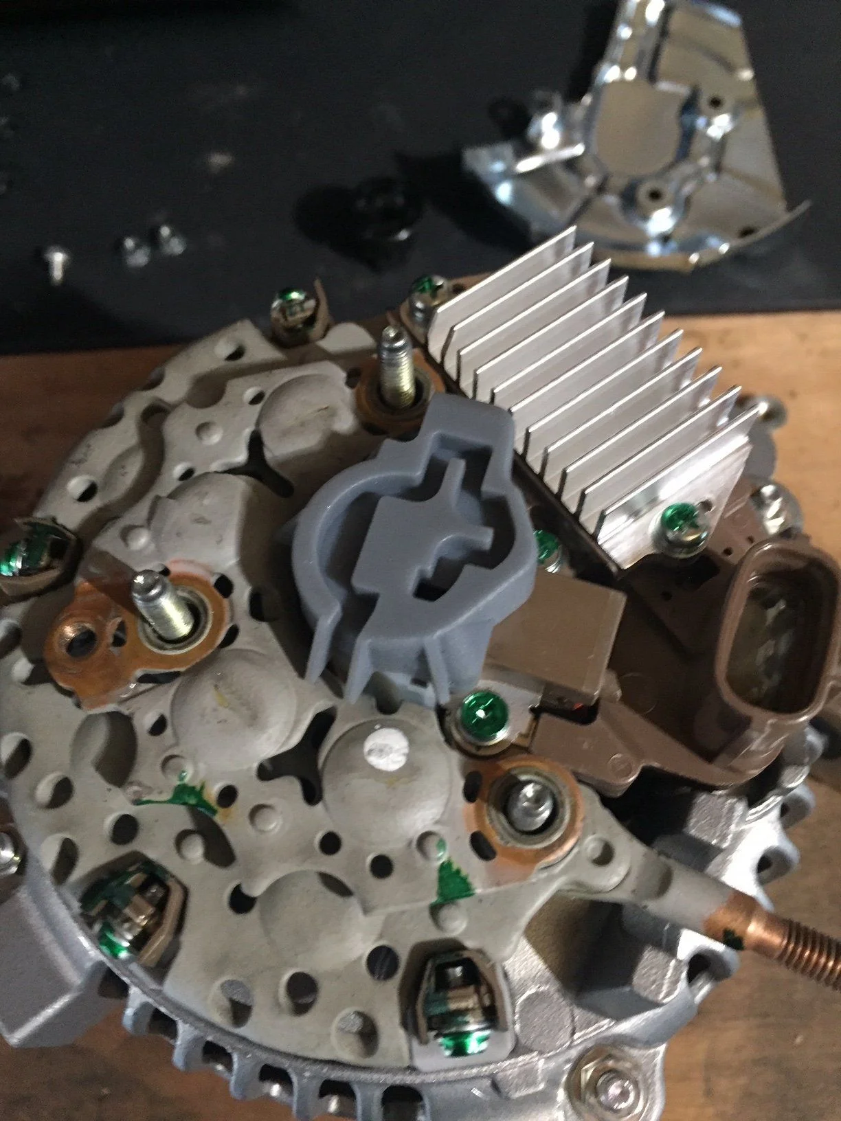

The new one has this gray rubber boot on top of the brush holder. The Ultima did not have this, nor did the original Toyota.

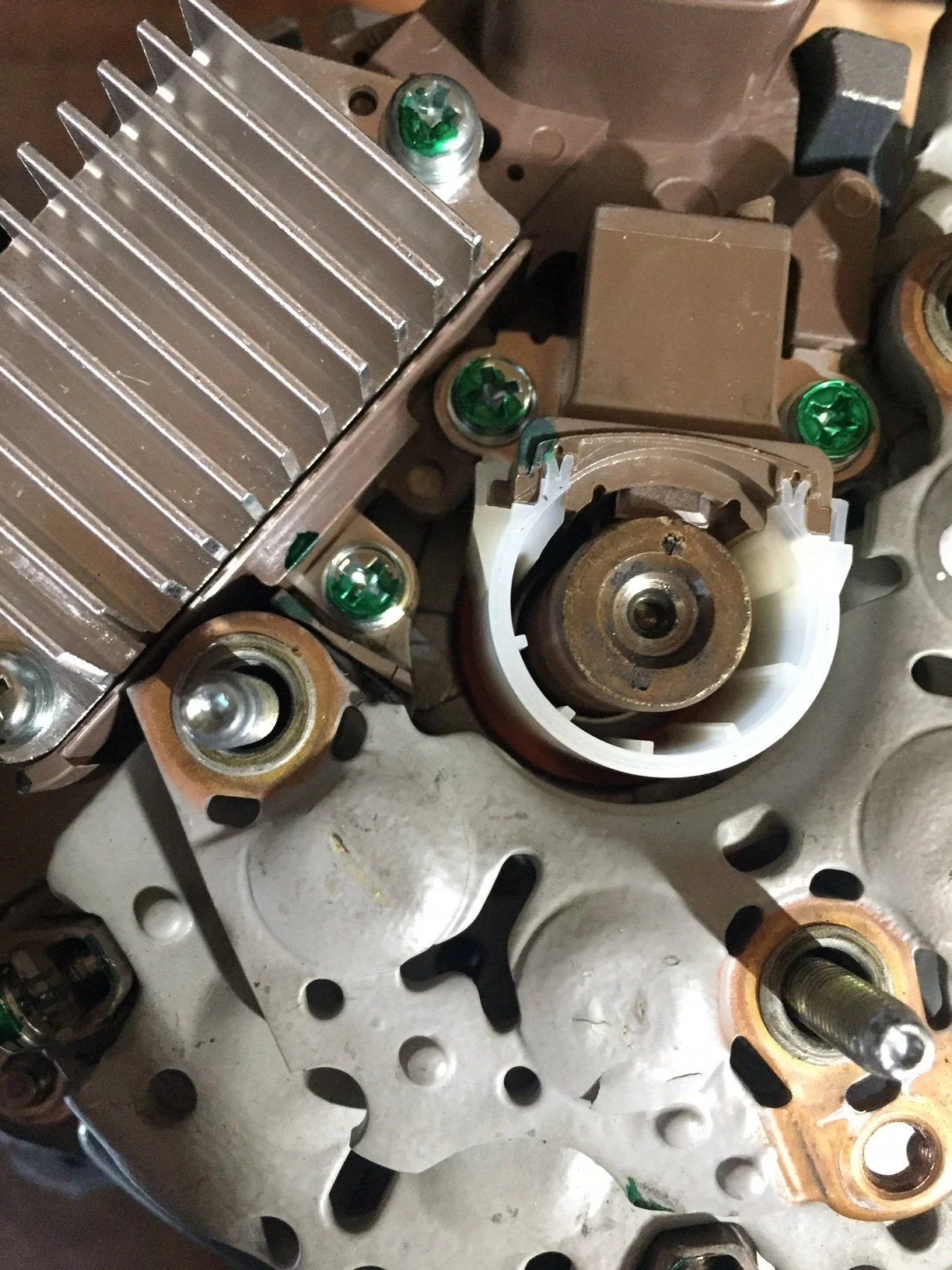

It's hard to see in the photo below, but it also has the correct orange foam gasket under the brush holder. The Ultima also omitted this part.
You can also see the voltage regulator/rectifier assy., which is new and is the correct Denso part. The Ultima used a 3rd party rectifier with a different style heat sink and made of a cream colored plastic. Similar, but not identical, to the one pictured in this thread.
