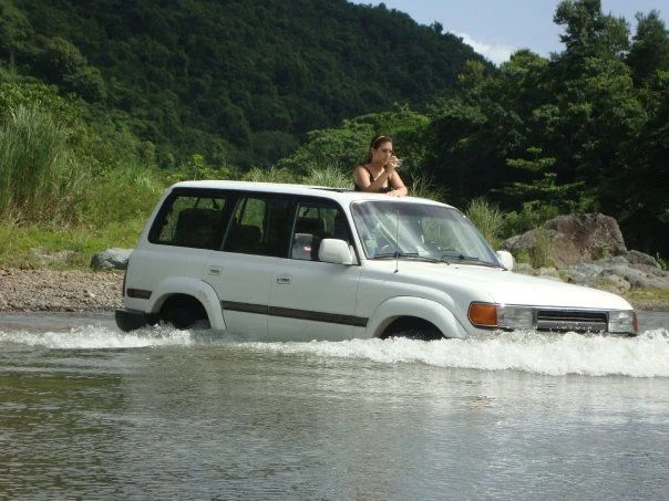

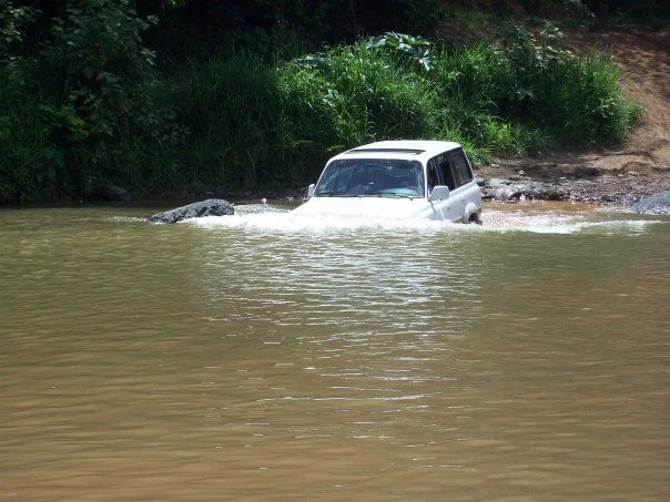

Have you seen my pictures in Ciales??? I don't think it doesn't matters if you have them or not...

It's time you get a snorkle.
:hillbilly:
I didn't know you were a chick.:rolleyes:
