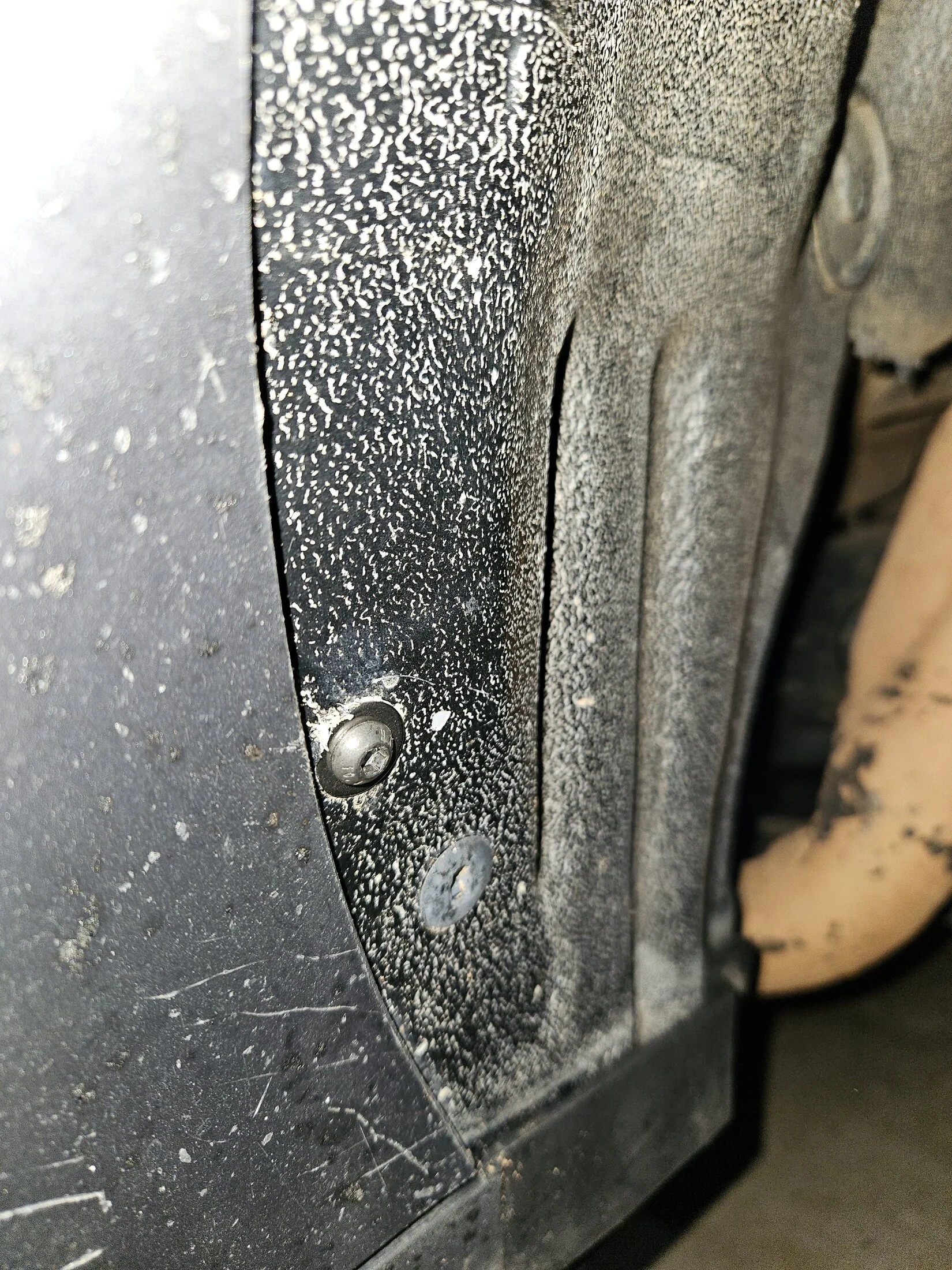

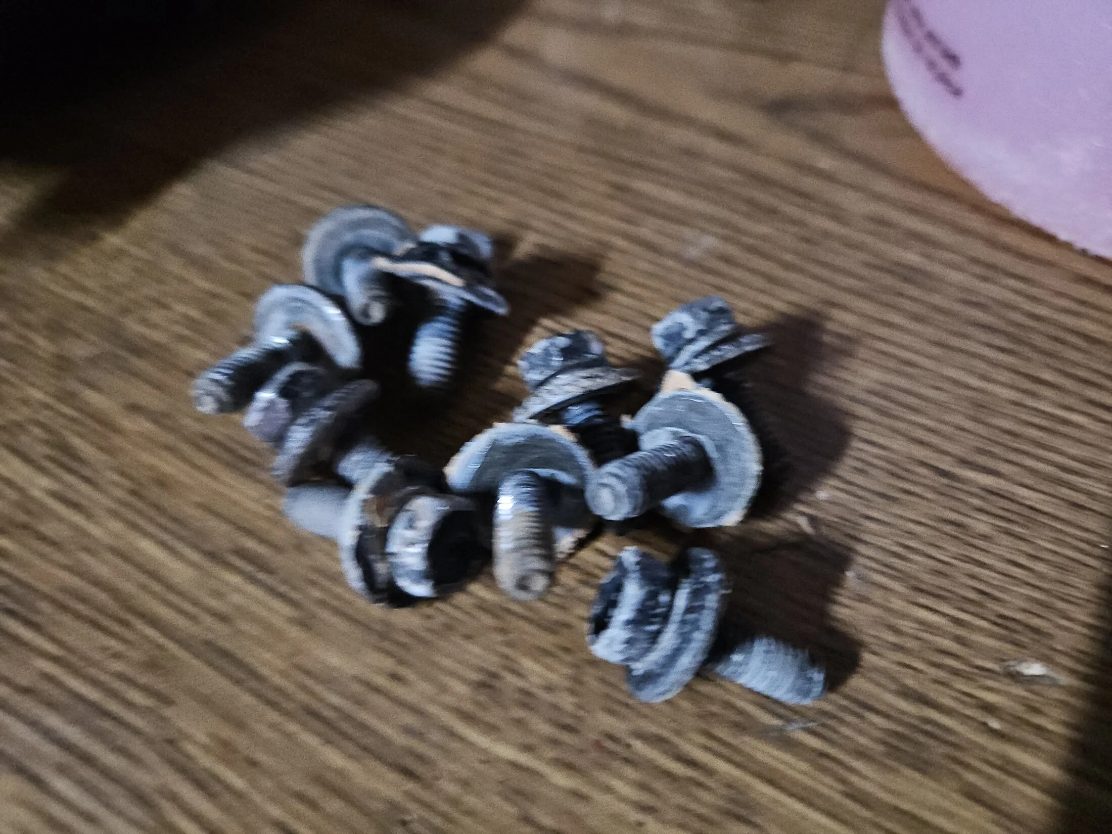

After two friggin hours with the power washer, I got these swapped over tonight. If anyone else ever needs to know, mine were M6X1mm X 20mm with 10mm heads. As it turns out, I have a whole small-parts drawer of button head M6X1mm X 20mm screws.
Got a photo of what you're working on?
I can't believe it, but replacing those bolts has resolved 90%+ of my front tire interference. I drove over some pretty serious moguls today (enough pitch to get hung up on the sliders) and nary a peep from the front tires!
You could go even flatter
Wafer head socket screws
