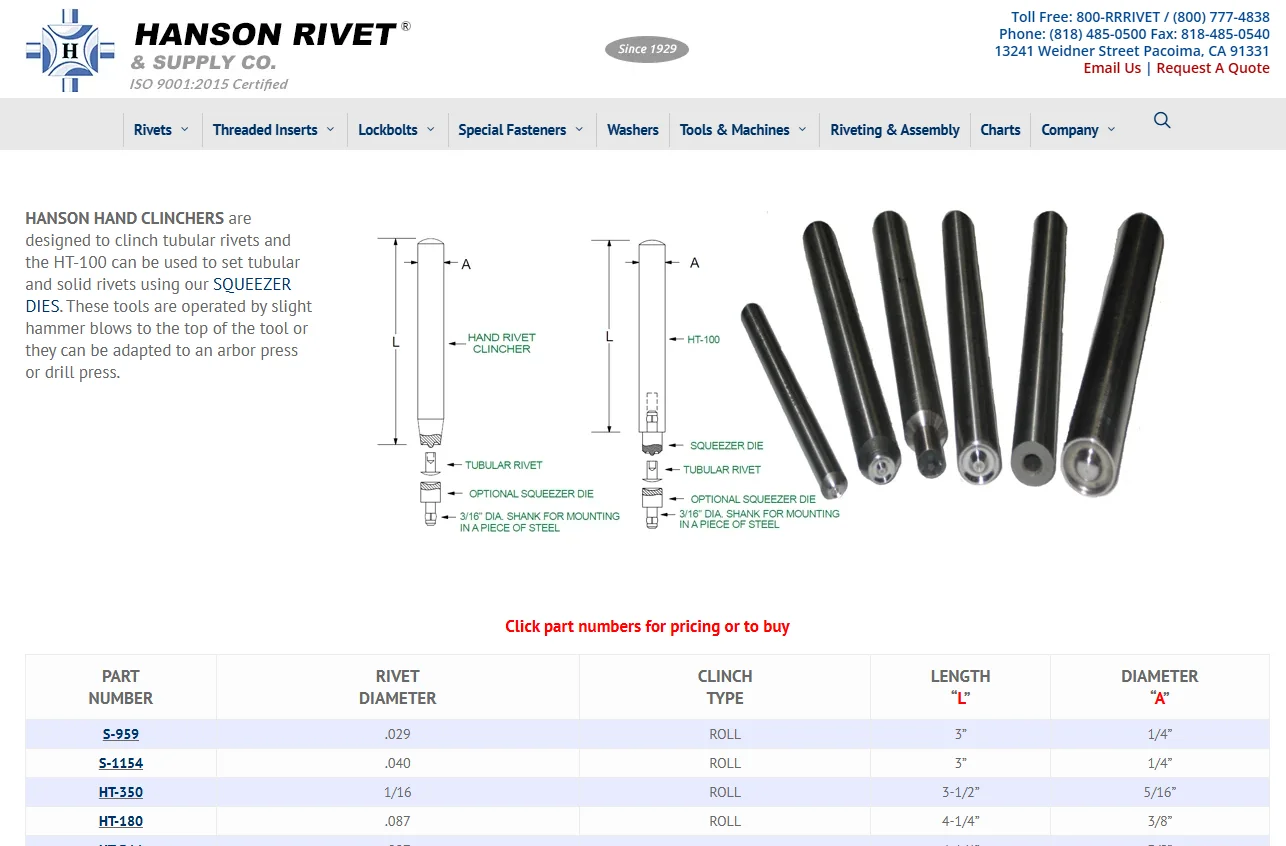

We tried heating before we put the rivet in the hole when I put the rear cross member back together after cleaning all the rust off and replacing the braces. It worked but not great, then we tried putting the rivet in, clamping it tight, heating the rivet and then using a air hammer that we made a tool to shape the rivet head to the correct shape and that worked so much better. They turned out tight too!
Have to look at which way you put the rivet in so that you can get the air hammer to the rivet.
You mean like these?
