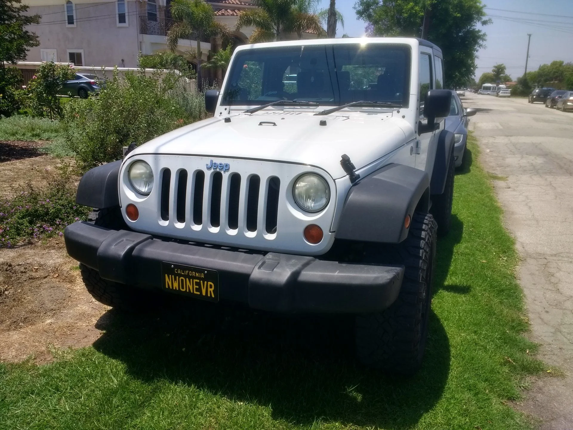

Saw this Jeep today and talked to the owner.
She said her mom brought it over from UK.
I really don't know what to say about it and how it got registered here.
RHD too. That's what started the conversation.
