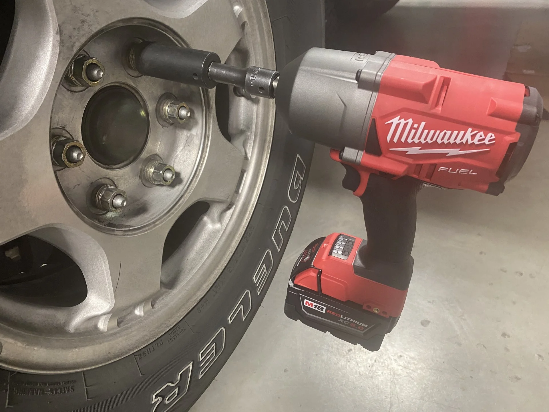

I used to use a pneumatic 1/2” Matco impact gun in the shop.
I now added the Milwaukee M18 Fuel 1/2” impact with three presets for different torque values.
I use the 3/8” Fuel M12 impact for engine peripherals. Small and somewhat compact it packs a decent punch.
No hoses to get in the way sure is nice.
Like MR.1911 stated, every tool has an appropriate use.
Otherwise I would only have one or two Milwaukee cordless tools.
