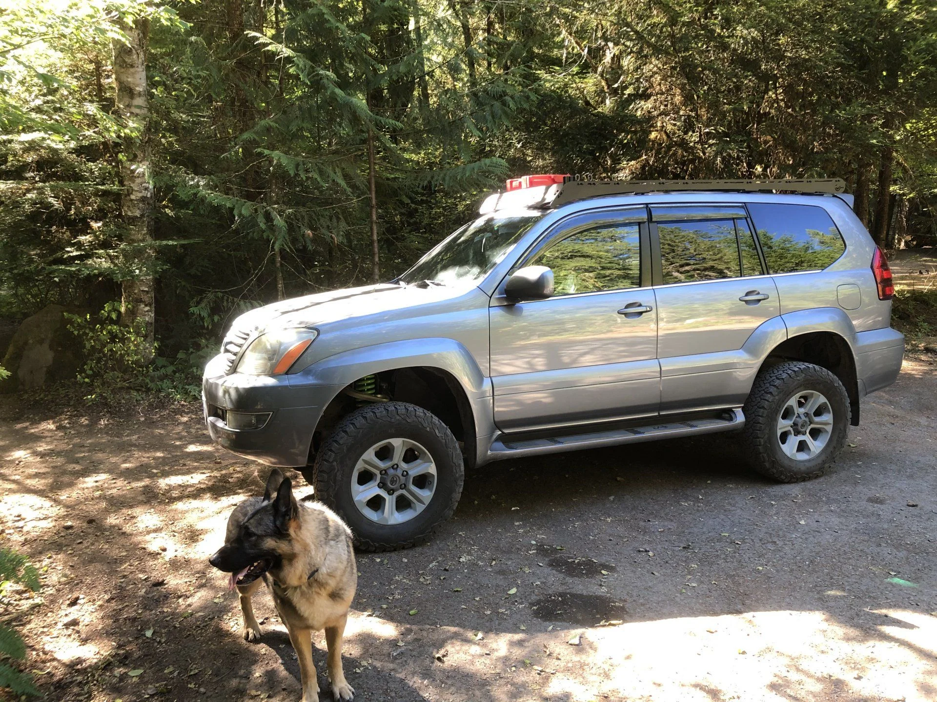

255-75/17 (32’) do not look too bad with a lift. It’s a good size...narrow so weight and rolling resistance are down, available in a “C” rating so more comfortable, yet capable size-wise of most light and medium-duty off-roading.
My personal preference is BFG KO2, but there are a lot of good tires out there.
Picture is with the above tire (with about 20k on them), and an IronMan stage 2, foam cell pro kit. Roughly 3” lift.
Thanks @McDuff123 — the pic is super helpful 👍

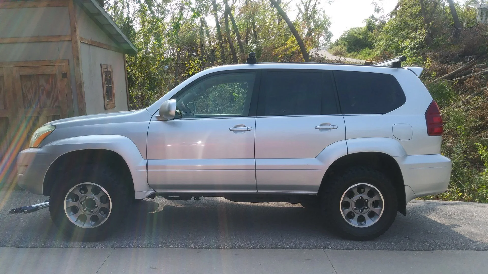

Here is mine with a 2" Dobinsons lift with comfort shocks and progressive rear coils. Cooper ST MAXX in 255/75/17 bought new for $600 on deal from Discount Tires.
WOW. That's a helluva deal. They're coming up at $940 for me at DT.
Yup not sure that deal available much anymore. It was a limited time offer. Free shipping too.

Just my opinion and experience, but a 2” lift does not require aftermarket UCA’s. Going higher probably does.
Steering will feel a bit “twitchier” but you will get by.
Exactly the look Im hoping our will have
