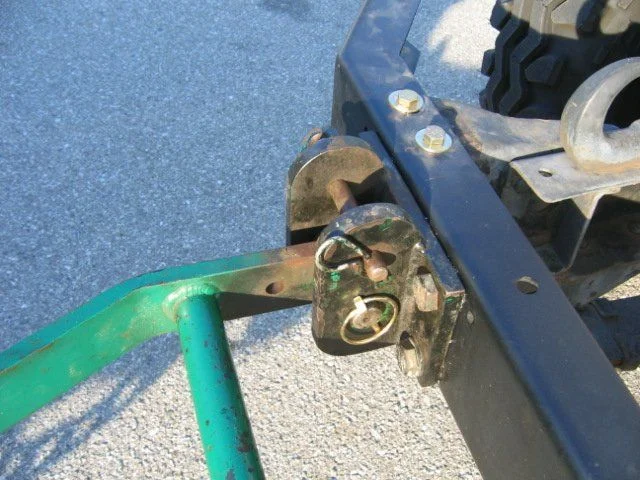

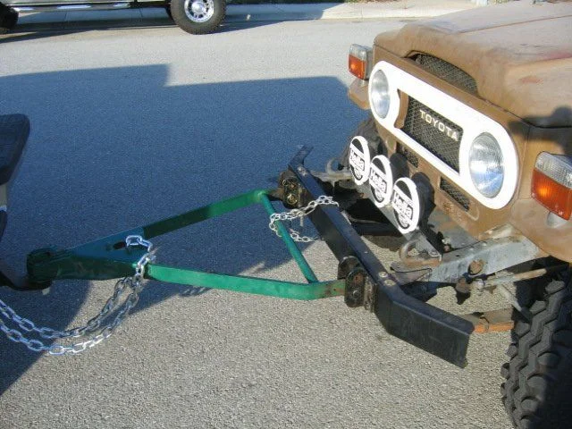

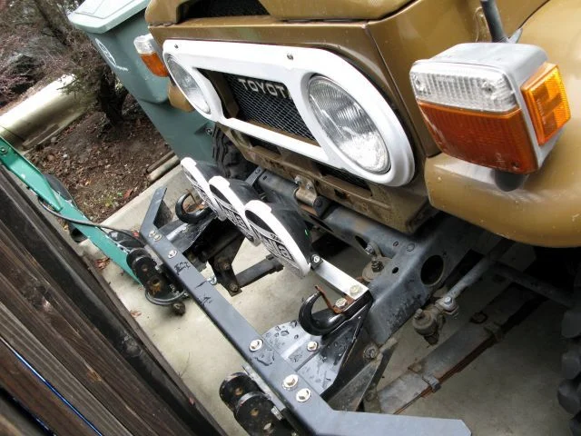

Here's mine. Beefy. Probably more like 8000 lbs rated. It kept my '40 from rolling over once and paid the price with not more than a little tweak.
I always promise myself to recommend towing with nothing less than a big dually, so there you go. Even a SRW 3/4t is pushing your luck if you hit a wet spot unless you have some kind of towed-vehicle brakes. Even with DRW, we tow like a paranoid old grandma.
The chains and lack of bumper gussets in the first two pictures were temporary. The bottom picture is complete.

It is 1/2". I think 3/8" would have been enough. Maybe it was originally made for something bigger? The pins are machine-shop tight. It's great when they're clean and freshly lubed with light oil. Once they're all dirty, they need some persuasion. I bought it from Slickrock 2 years ago.
My bumper is also 3/16". The tow bar attaches right where the bumper is bolted to the frame rails with the gusset plates on top, so it's very strong at that point. All the HW is grade 8. No crumple zones in a Cruiser.
1/4 maybe 5/16th.
How thick is that metal on the tabs?
And the metal on the bumper? And what's the sheer strength of those two little bolts? Even though that may not be fatal, I wouldn't call that "beefy".
If that setup went through my accident, I'm 100% sure the '40 would have rolled all the way over. As it was, we drove away within just a few minutes.
