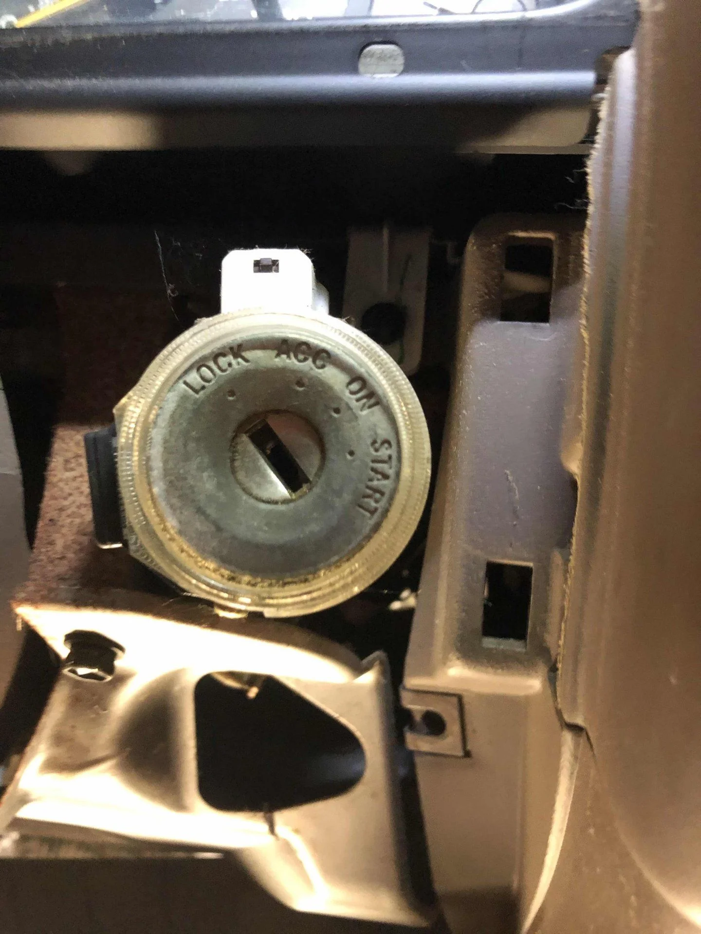

The light bezel around the ignition switch is missing on my FJ80. I have tried to look on partsouq and other sites for the name or part number of this item. I cannot find it. Can anyone help with what this is called?
And put a new bulb in it before you install it. I believe its a #74 wedge bulb.
There you go.

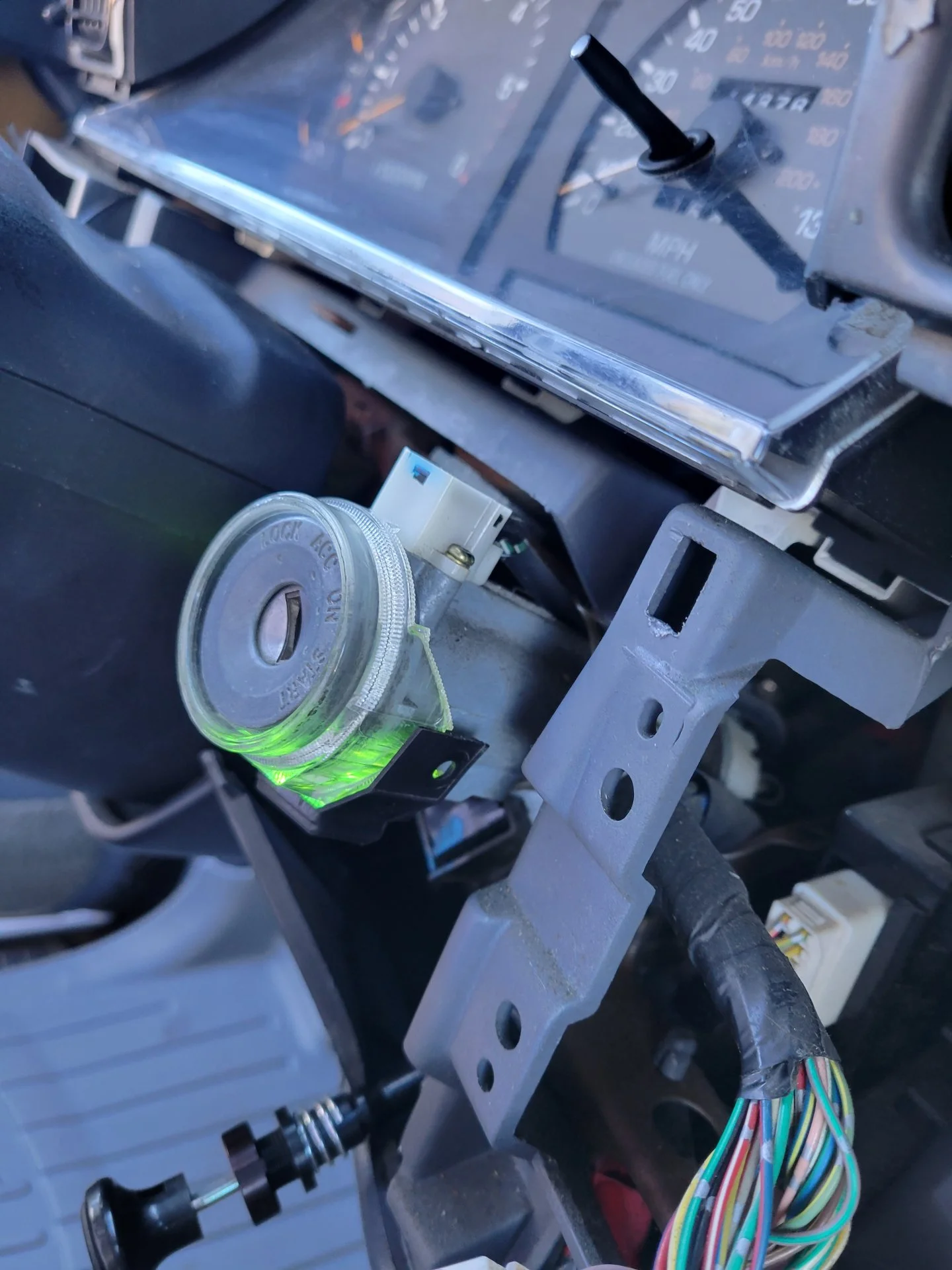

I found the slightly broken NLA Part No. Toyota 81870-60011 Lamp Assy, Key Cylinder 1992-1997 Toyota Land Cruiser 8187060011 behind the dash and the glowing green light next to the column.
After fiddle f'ing around I see how it is supposed to install. The one screw to hold the slightly broken assy. in position is MIA.
It threads thru the Black, (green light), holder AND plastic "illumination" ring.
Part No. 93315-14010 is substituted and I will order.
The purpose of this post: Has anyone found a source for 81870-06011???

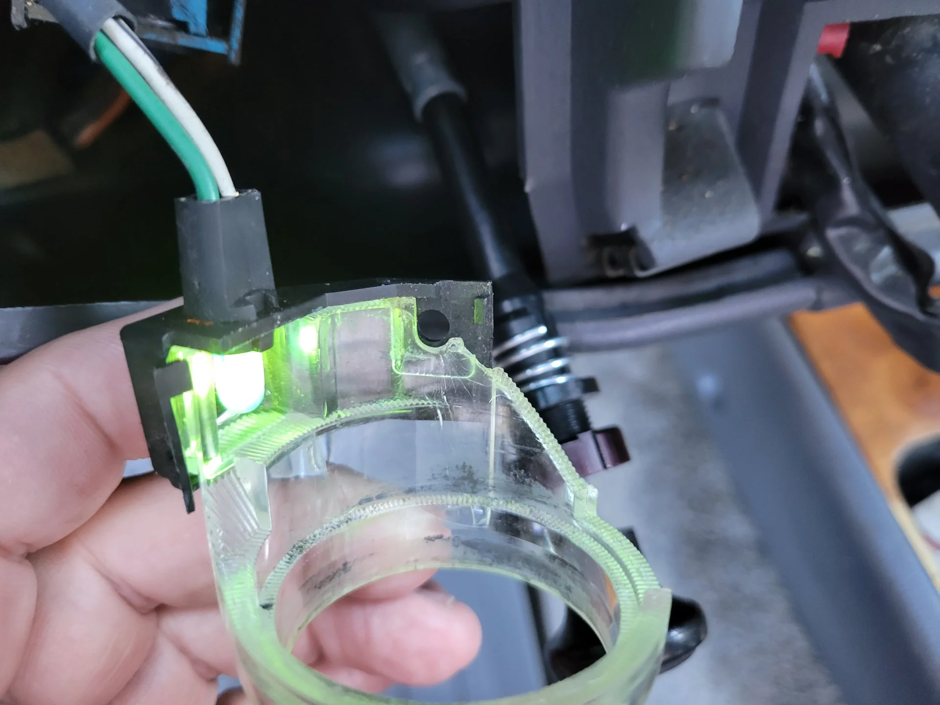

I make replacement rings, also make them without the light.
I have the ring, Just looking for the clear lens for the light, mine is decent but has cracks from being overtightened. I will be ordering some items from you in the future. Any plans on getting an SLA printer?
Would you happen to have any more of these ignition light assemblies?
I do, send me a private message and we can get something going. I should be able to have one in the mail Monday for you.
