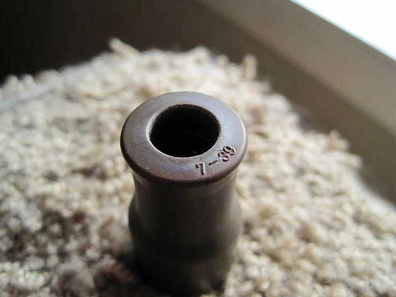

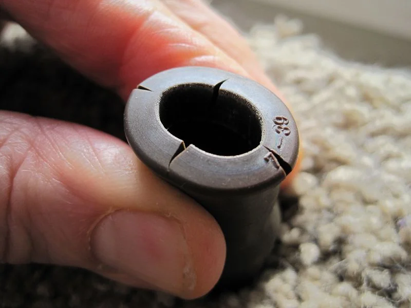

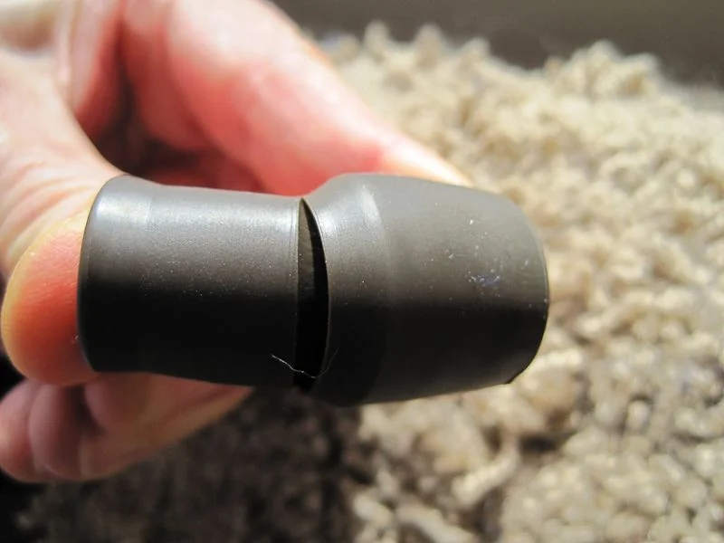

I was helping a friend with his hard to diagnose misfire symptoms.
The pictures of seemingly good ignition coil boot and what it really is after 155k miles.
I change them with every spark plug change. And I would add heater hose T to the same schedule...

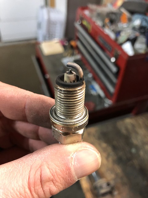

Do these look ok? Thinking that that boots/o-ring are probably original, plugs may be too as the one I pulled was SUPER tight in there, to the point I pulled the ratchet to make sure I was turning the right direction...

Spark plugs are more of a maintenance item and coils are more of something that you replace as they go bad. I would change all of your spark plugs at once and then address coils as they go bad. I did plugs and all the coil boots at the same time. Loose spark plugs and age can cause the boots to deteriorate while the coils may still be good.
What I've seen most often when working on other folks vehicles is spark plugs aren't checked and have backed out a little bit over 80-100k. This results in hot gasses escaping and in the best case drying out the coil pack boot. In worst cases its almost destroyed the coil pack and also damaged the plug.
I had a plug start working its way out last year at about 50k of use. Luckily I caught it (sounded like a very small exhaust leak so I started investigating) and only the boot on the coil pack needed to be replaced as it had dried out and split.
These boot kits and springs are cheap enough to replace that it just makes sense to do when you're doing plugs. A cracking isolator boot could increase resistance or in a worst case arcing to the tube. More importantly than this stuff though is to just make a note to check your plug torque at 30k service intervals when you're doing everything else. It takes 10 minutes.

On that note, when you change out your plugs, you should up the fsm torque spec by 3-5ft lbs to be safe. Then check every so often (36k miles or so) to make sure they aren't loose. They are long life plugs so they are often neglected.
