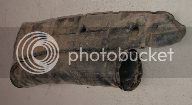

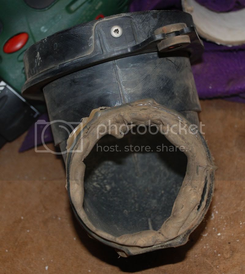

if you checkout the lcool.org sticky below (you'll need to join)
LCOOL.org :: Log in
you'll see pics like this:
and this
But to answer your question the [STRIKE]first gen[/STRIKE] older Safari like mine narrows down to about 2 inches in diameter in places and if the installers have done stuff like seen in the second pic above then it could be even more restrictive.
The "high flow" snorkel i have on my list is basically 4 inches diamter from the top all the way through the guard and joining onto the airbox unlike my Safari which varies from 2" to 3" at various spots. It is a custom fabricated, mandrel bent stainless steel snorkel. You see them a lot on some of the competition 4WDs down here and the occasional street registered 4WD too. Edit: maybe instead of "high flow" i should say "less restrictive" ? But you get the idea.
