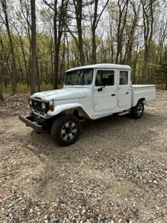

After doing a few things I probably didn’t need to do immediately, I finally did get my 14B Toyaota running very well. Got rid of the excessive white smoke, idle is way down from the near 2000rpm on startup. She starts up with 3 seconds of cranking when cold.
HOWEVER, I am still not fully satisfied that the idle is correct. My Conventional gasoline engine experience is substantial and I am not afraid to go bare block and rebuild. On a diesel …it give me great trepidation since I am not experienced in injection pumps, injection timing, or even the process of ignition on this truck. I would be unable to bring this vehicle somewhere to undo the screw-ups I create so I am really looking for answers on what I can minimally look into to get this properly adjusted.
