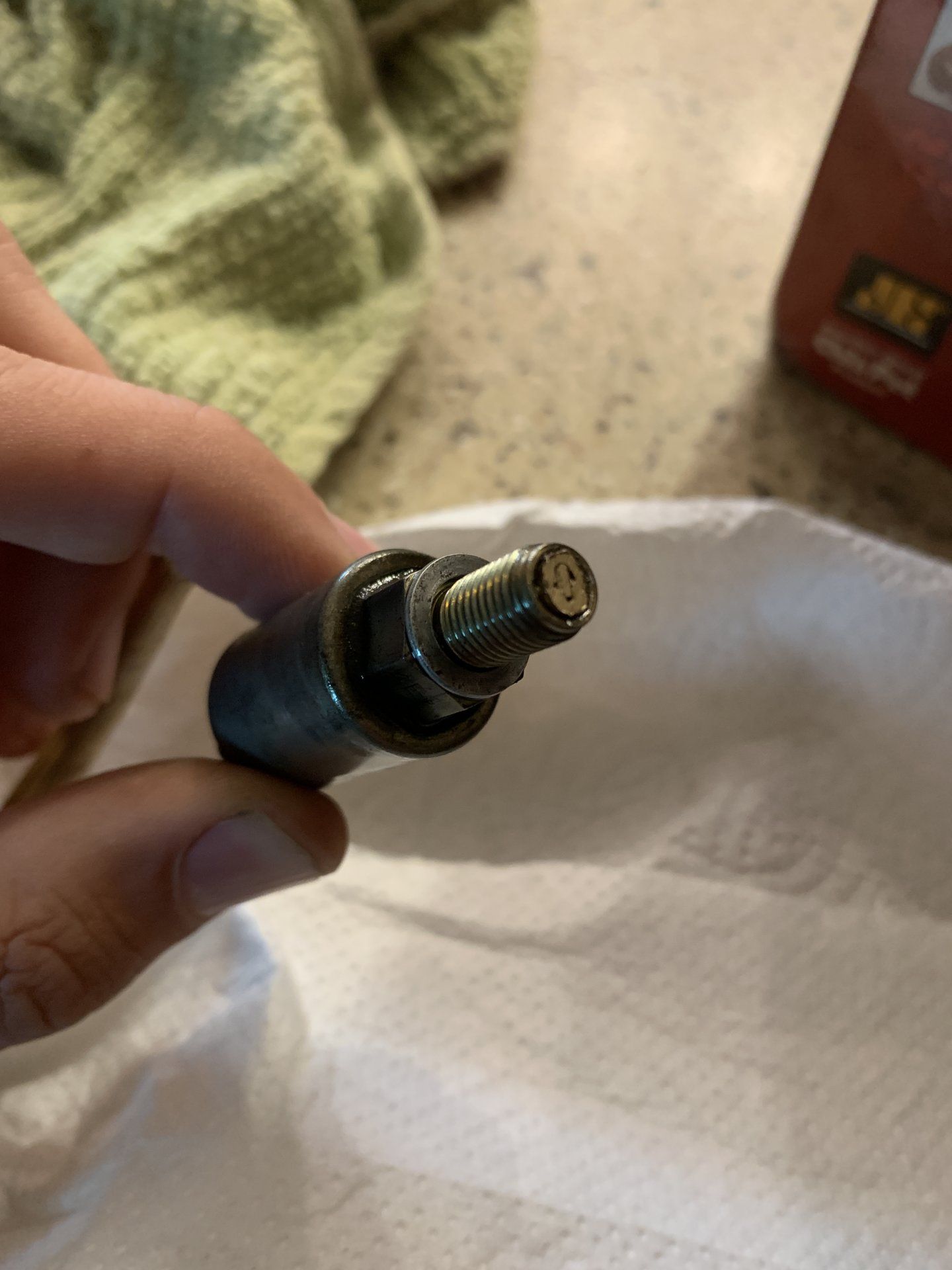

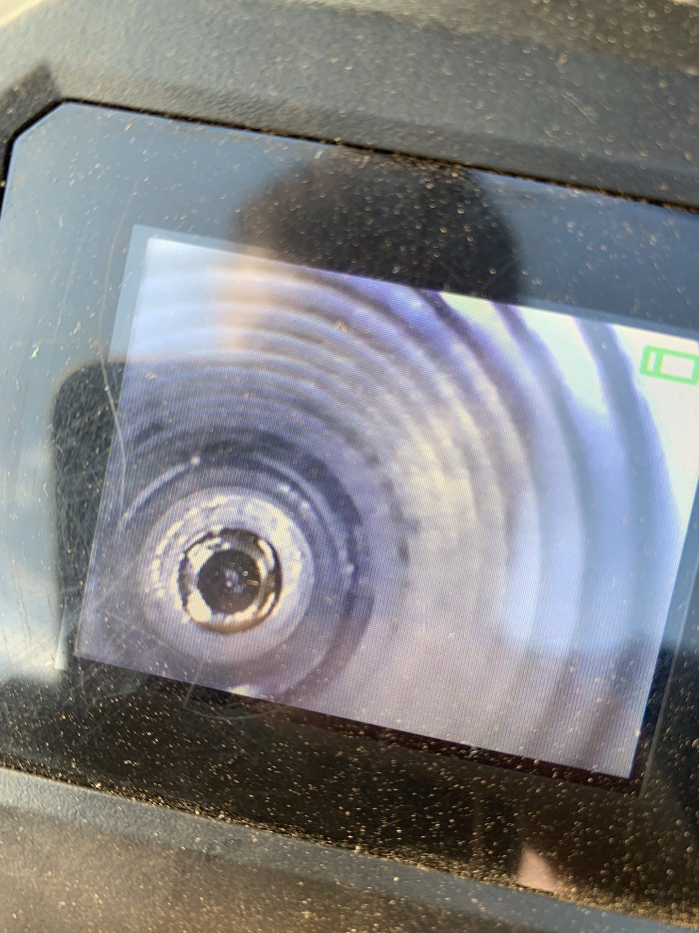

Hopped in my 60 last night to go to a movie. It was running fine all day, but this time I go to start it, it idles low and dies. Can’t keep it running, look on here and suspect the idle solenoid. Pretty familiar story.
Weird thing is, I pull the solenoid out (it’s not clicking with power, but definitely taking power), and it looks like someone took a dremel to the needle or something. Why would it look like this? Is it possible at all for it to have sheared inside the carb? Is there any practical reason for the PO to have done this?
First photo is of the solenoid itself, second is a snake cam pic of its cavity in the carb.
Looks like the end broke off. Pretty sure from memory that there’s more to the end of it than stopping at threads. It probably has sheared. You’ll need to pull the air horn (top section) off the carb.
Oh yeah, there’s definitely supposed to be more. From pictures I’ve seen, the normal, unpowered position is a piston head extended. But looking inside the port with the snake cam, I’m not seeing anything that looks like the part that broke off (which would at least have a rod still on it, I would think, given how this valve is “broken” off
What it’s supposed to look like, minus missing the o-ring. From the pic, it looks like the rest may be stuck in there, but it also appears it was cut off. I dunno!
I’m thinking it was cut off because since I’ve had the truck it’s sporadically diesel’d on shut off, and I’ve heard some people do this when their cut off solenoid goes haywire.

I had a carb I bought to rebuild a few years back snap off just like yours. Took me a bit to remember. I’m betting the end is in the carb housing.

No worries; having assumed all those things you described to be true, I reinstalled the solenoid for the time being.
I suspect, however, that replacing the solenoid won’t be the end of it. I’ve seen parts sheer and snap before, the pattern on the solenoid denotes a rotational instrument that left barbs on the edges. My guess is this solenoid was cut because it was operating opposite of how it is supposed to, or it was operating ok, but they cut it because trying to meet Cali emissions requirements, and still getting the vehicle to start was too much of a challenge.

the Solenoid Failed , or stayed closed during attempted engine operation as if NO B+ was flowing through it
so the PO , removed it , chopped off the end to allow FULL FUEL flow at Running Time , But did not know
the consequences of those actions ?
