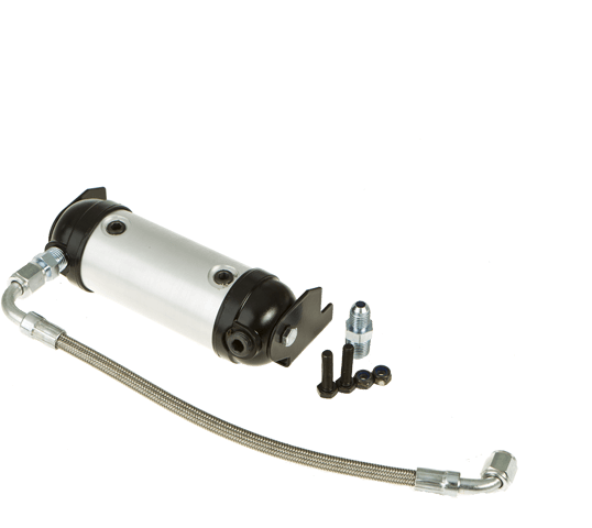

I’m going to add the little ARB manifold just for this reason. It’s designed for people who need solenoid valves for front/rear lockers and has an extra threaded port for air hose. I think the steel line to it, and the small metal manifold will take the air temps down some.
But I’m with you on the ARB twin performance. Super impressed with how much it puts out.
I’m going to add the little ARB manifold just for this reason. It’s designed for people who need solenoid valves for front/rear lockers and has an extra threaded port for air hose. I think the steel like to it, and the small metal manifold will take the air temps down some.
I should do the same. Post up the part number if you get time.
If the CKMTA12/24 compressor is used for prolonged periods and/or your vehicle is outfitted with ARB Air Lockers, the ARB Manifold is required. The ARB Manifold will offer two additional ports for each of the locker solenoids. It will also help dissipate the heat from the compressor which will allow it to run more efficiently.
