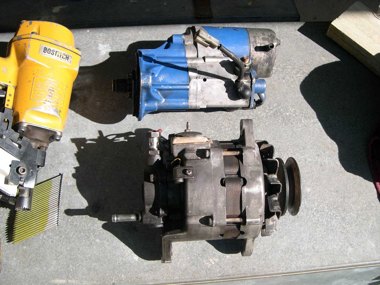

This is an alternator that I got with some other stuff I bought . It was supposed to be a 24 volt toyota but I don't think so. Can anyone identify it? Thanks
cool its got vaccum pump. post up the part number, its hard to read, some hear for sure will know it.
part number
Lt140-105 01a
23099 61560
Is there just one your trying to identify?
The 1st one you posted in the other thread with the part# 27030-68011 corresponds pretty close with 27030-68110 which is pre 85 12v for H ,2H ,2B and Diahatsu rocky diesel
The bracket centres should be 174mmx 106mm
There is a pic of a 12v 2H diesel alternator on aussie ebay and it looks the same as yours

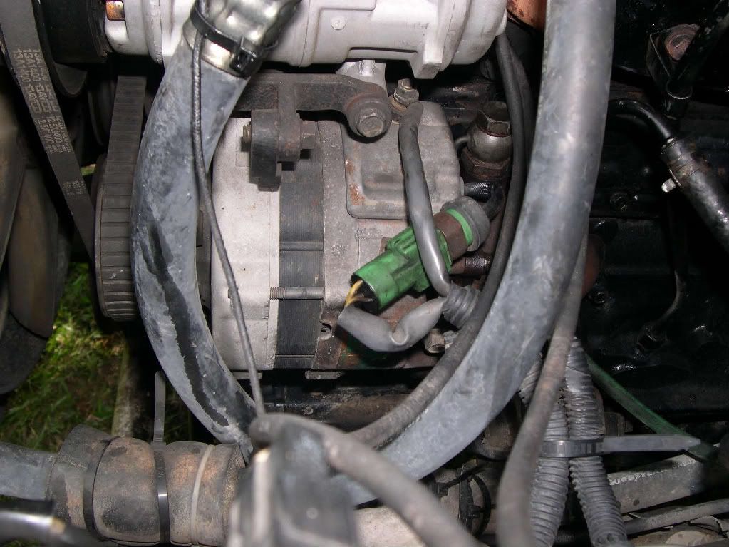

There are different alternators in each post. The first is definetly toyota. I have a 12volt aussie alternator and the oil line hooks into the alternator housing by where the vacum pump mounts, and the new one in the picture does not have the oil fitting. If you look at the 24 volt (used) you can see where the oil line hooks in. I have no idea what the other one is from.
The 12 volt aussie and the 24 volt canadien look the same
Maybe Im missing something ,but isnt the oil port on the vacuum pump,not the alternator housing :confused:
you are right
