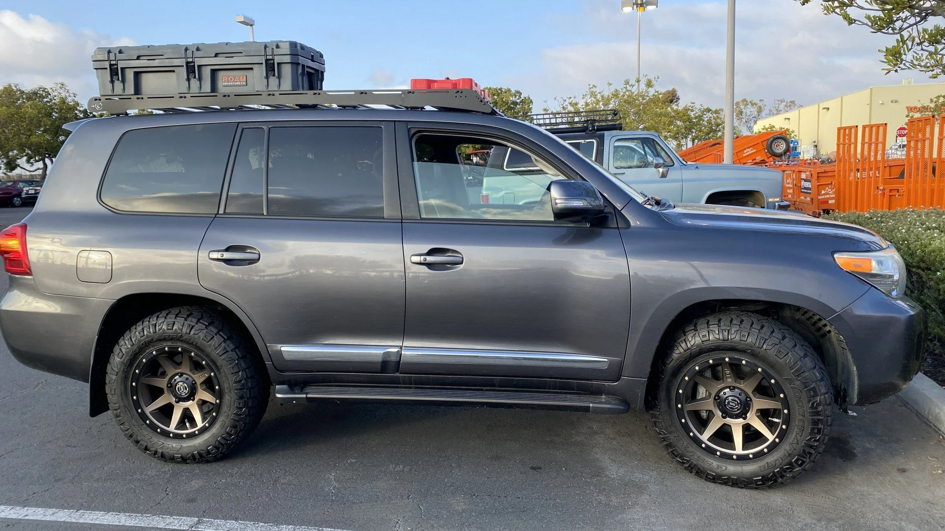

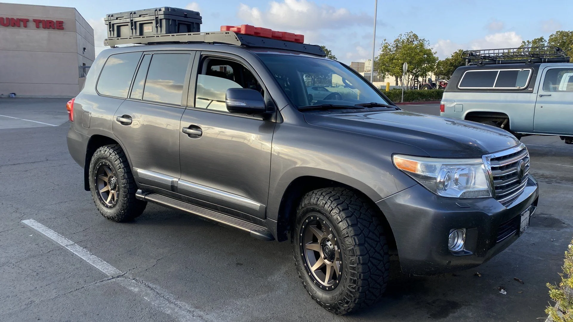

Hey guys, it's been a while since I've done anything new to my truck, so I've decided to finally pull the trigger on some new wheels, and it just so happens, AncientMariner recently posted the exact wheels I want on my same color LC, so thanks for letting me steal your pic! I've still got the stock 18x8 wheels with 285/70/18 Ridge Grapplers, so I guess the closest size available for Icon is 18x9, which I assume is fine. My question is about the backspacing. I've got the Spidertrax 1.25" spacers on now, and I like the amount the tires stick out, so I want to keep that look. Should I just go with the closest backspace they have to the stock, which for the Icon Rebound is a 25, or would you remove the spacers and get a negative offset wheel? Also, thoughts on the bronze with a gray truck?

Okay, duh...you're right, I had it reversed about how I was thinking about it, and I hadn't thought about the tire width. So, the stock wheel has an offset of 35mm and the Icon is 25, and the spacers are 32mm. So, if I were to go with the Icon at 25mm offset and leave the spacers on (just for arguments sake here), being that the wheel is 25mm wider than stock, it would actually stick out 40mm more than what I have now? But if I go with the 25mm offset (which is actually the only option from Icon) and get rid of the spacers, it will be about where it is now (in by about 10mm)? I'm sticking with the 285/70/18's because that's what I'm running now, and the tires are less than a year old.
Oh, and I posted a couple pictures in my original post...or rather stole them from AncientMariner. That's exactly what my setup will look like.

almost correct. You won’t be 10mm in from where you are now, you’ll be about 3mm further out than you are now without spacers with the icon wheels. However, your Icon wheel is also wider which will make the wheel stick out even further. This doesn’t equate perfectly as the tire size is the same. If you look at @kreiten, he’s running 18x9 +20 offset, no spacers.
