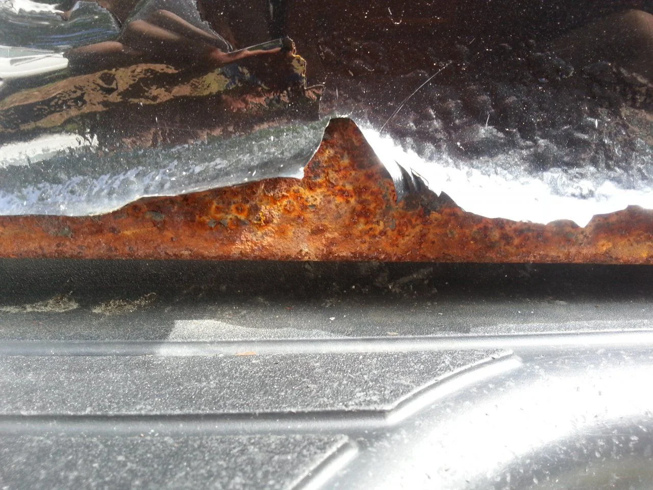

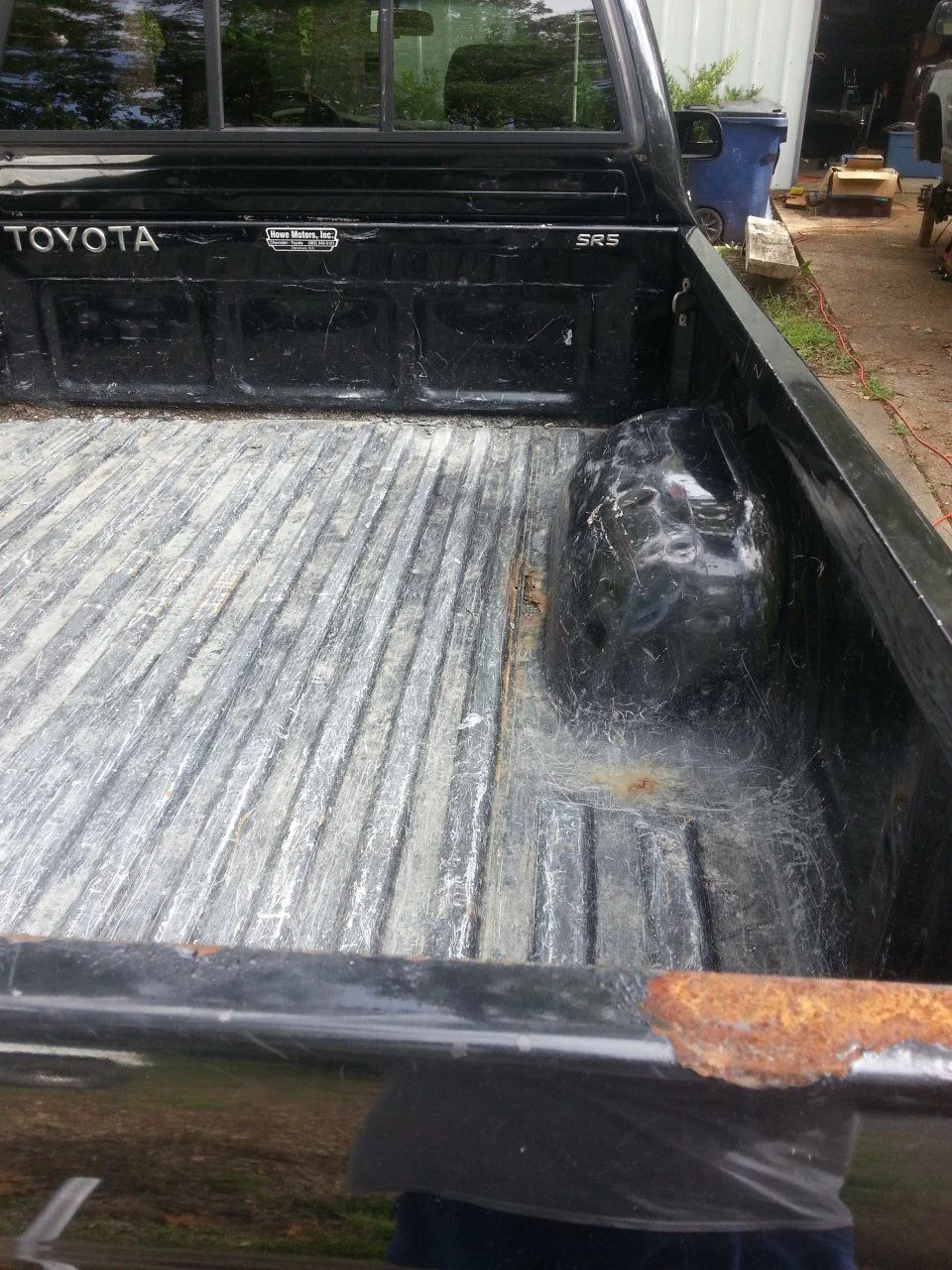

I'm afraid that this stage of the narrative isn't very well documented (certainly less so than other parts are), but I do have a few pictures to share. After several seemingly never ending days, the transport service finally rolled up in front of the driveway with my black 2002 Tacoma on the flatbed. I immediately saw that it was not nearly in the clean condition it was described as being in. But, I figured it's a truck anyway, it doesn't need to be perfect. Well, perfect it was not. Advertised as a non-smoking truck, that claim was dashed to pieces the instant I opened the door. Again, something I have no problem overlooking (by the way, as I'll later find out, the product called "Ozium," an odor eliminator, works fantastically to kill the smokey smell). Other than that the truck seemed fine; it started right up and ran with no problems. It arrived late in the evening, so I didn't feel like inspecting it more closely and decided to be content for the night. The truck arrived on a Friday, so I was up bright and early on Saturday giving it a real deal once-over. Everything seemed passable, until, lo and behold, I spotted perforations along the frame. And I don't just mean little ol' quarter sized holes. No sir, I'm talking holes the diameter of my fist and a foot long. Not good...at all...
Luckily only, as the seller stated: "A little minor surface rust in a few areas."
The seller must be a comedian. MINOR SURFACE RUST?!? That's just plain dishonest.

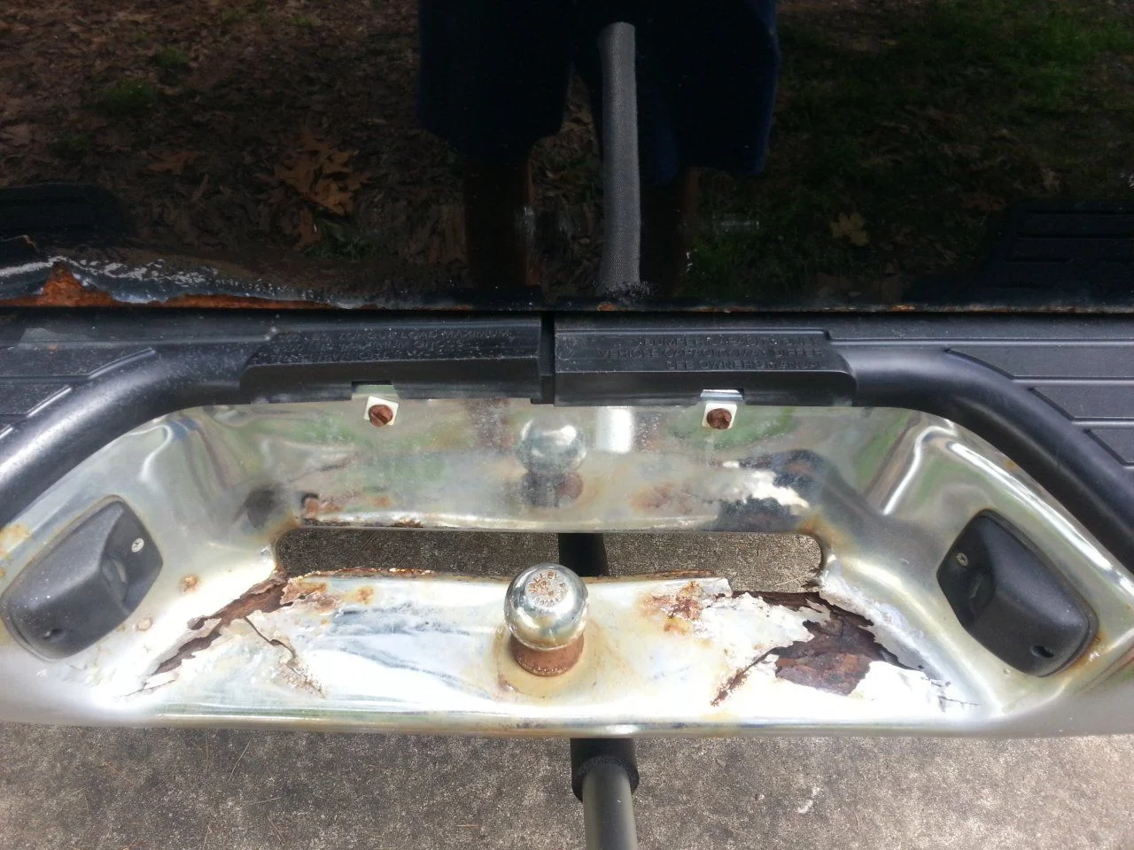

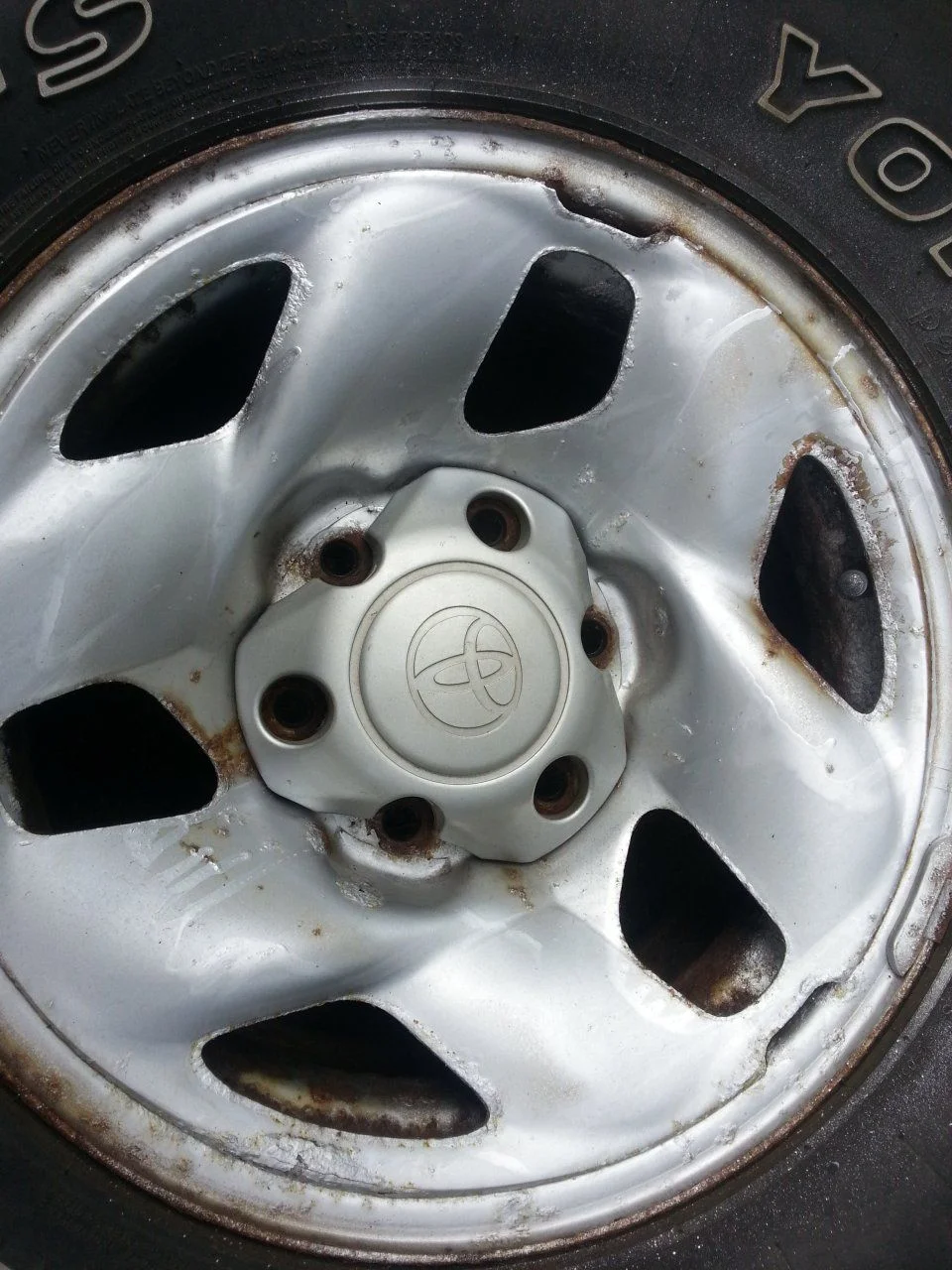

Check out the spray painted wheels (see the overspray on the tires?). Just covering up rust.
I didn't take a picture of the frame at this point; I was just too darn angry. But don't worry. Pics of serious frame cancer are soon to come.

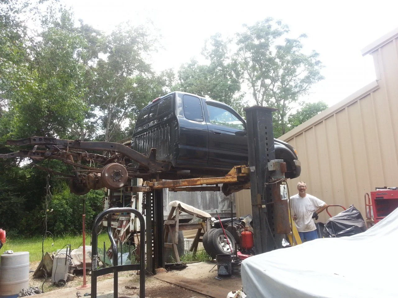

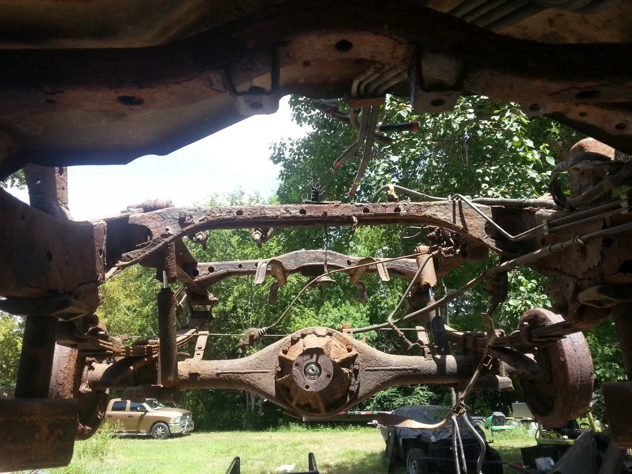

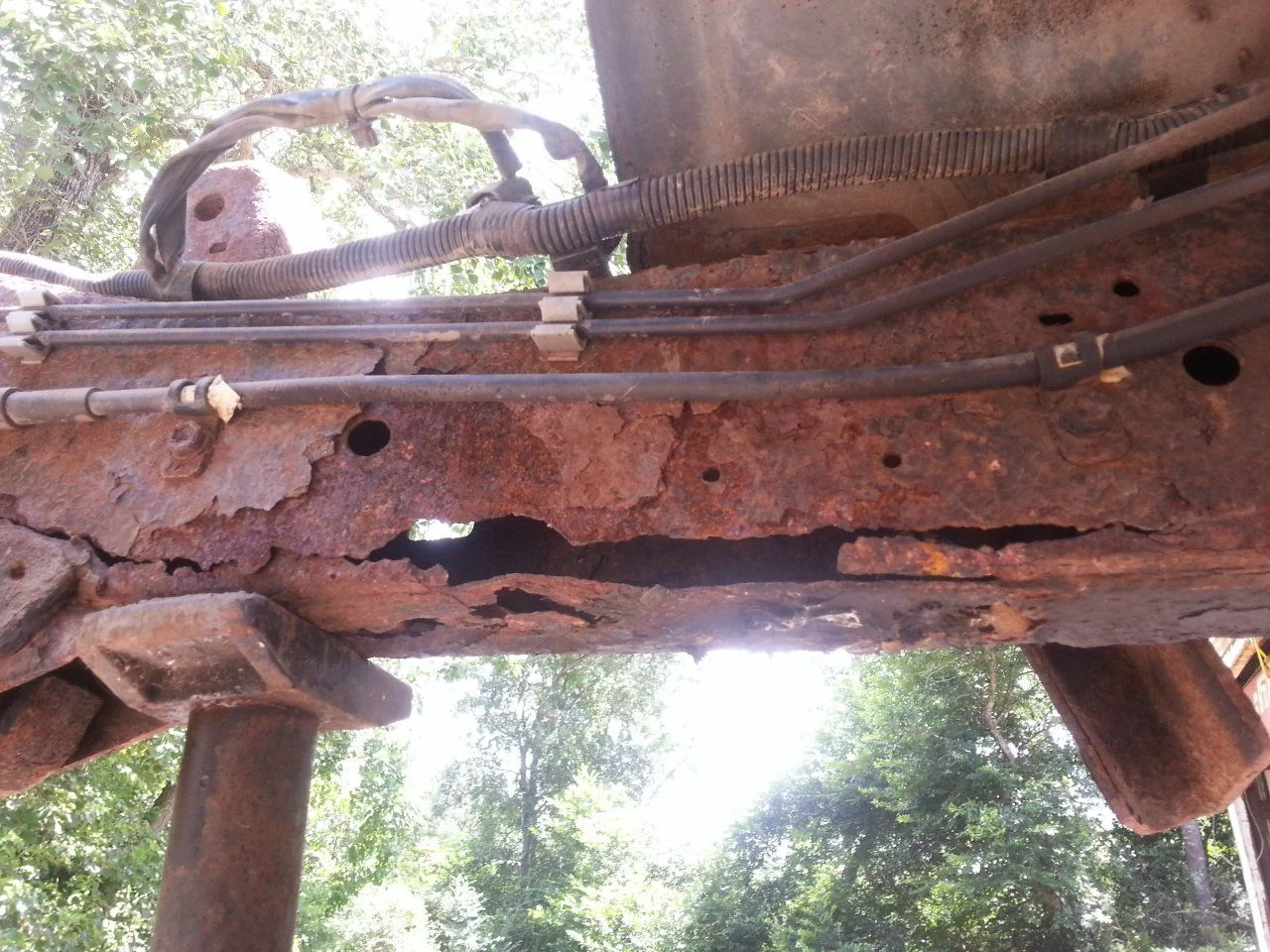

Having attempted to go through Toyota for a new frame, I discovered that the PO was notified 8 times about warranty service on potentially rust-plagued frames. The owner took not action, and thus, the truck is no longer under any sort of warranty (being a 2002 model). So, we loaded the truck on a trailer and hauled it to my uncle's machine shop in Dallas to see what he thought needed to be done. I owe him the credit for approaching this undertaking with a positive air and having the guts to say that we, with the the help of some other family members, could replace the frame. That's exactly what we did. The truck went back on the trailer and we hauled it to Houston, where my grandad has an automotive lift. Up on the lift it went and the disassembly process began. The bed was easy enough to remove and came off first.

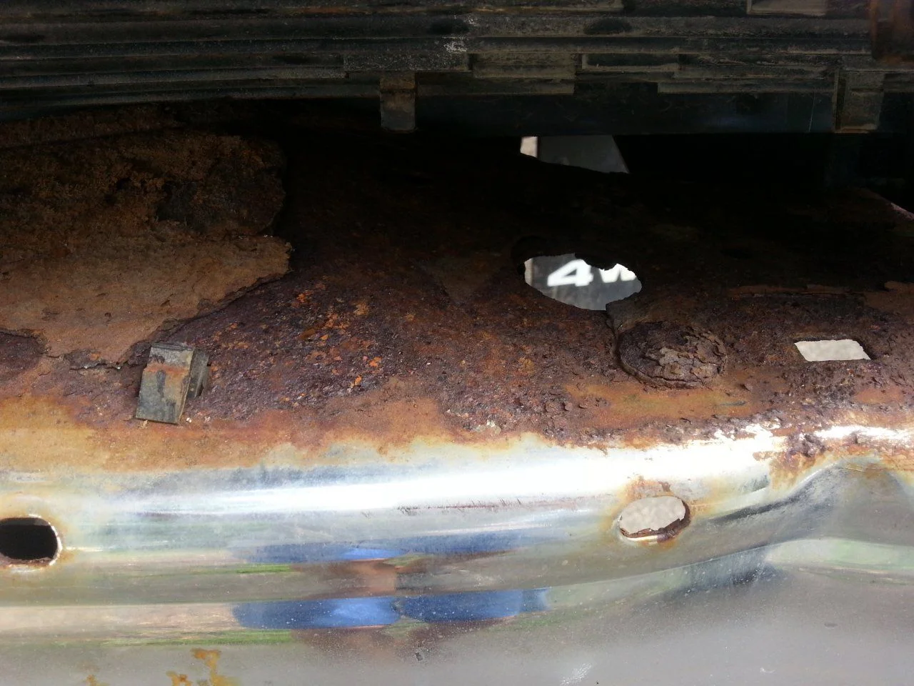

Here are some close ups of the damage and severe putting on the frame.
