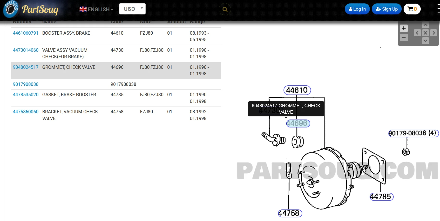

Sounds like a bad check valve, in US models it is PN 44730-28010. You'll also want the grommet, PN 90480-24015, and it just sticks into the brake booster itself like a PCV.
I'm guessing the Australian part numbers won't be any different, but that is just a guess.
Is there a way to test the check valve to ensure this is the culprit?

What is the part number for this rubber piece ?
I actually used the below one which I believe is for a 60 Series but exactly the same size
My booster is a two bolt type where the MC mounts by the way. The image above shows a 4 bolt type so the pushrod seal may differ however highlighted in the part numbers is the valve seal, not the one I have pictured below
Your issue does sound like the one way valve is not operating / sealing properly
