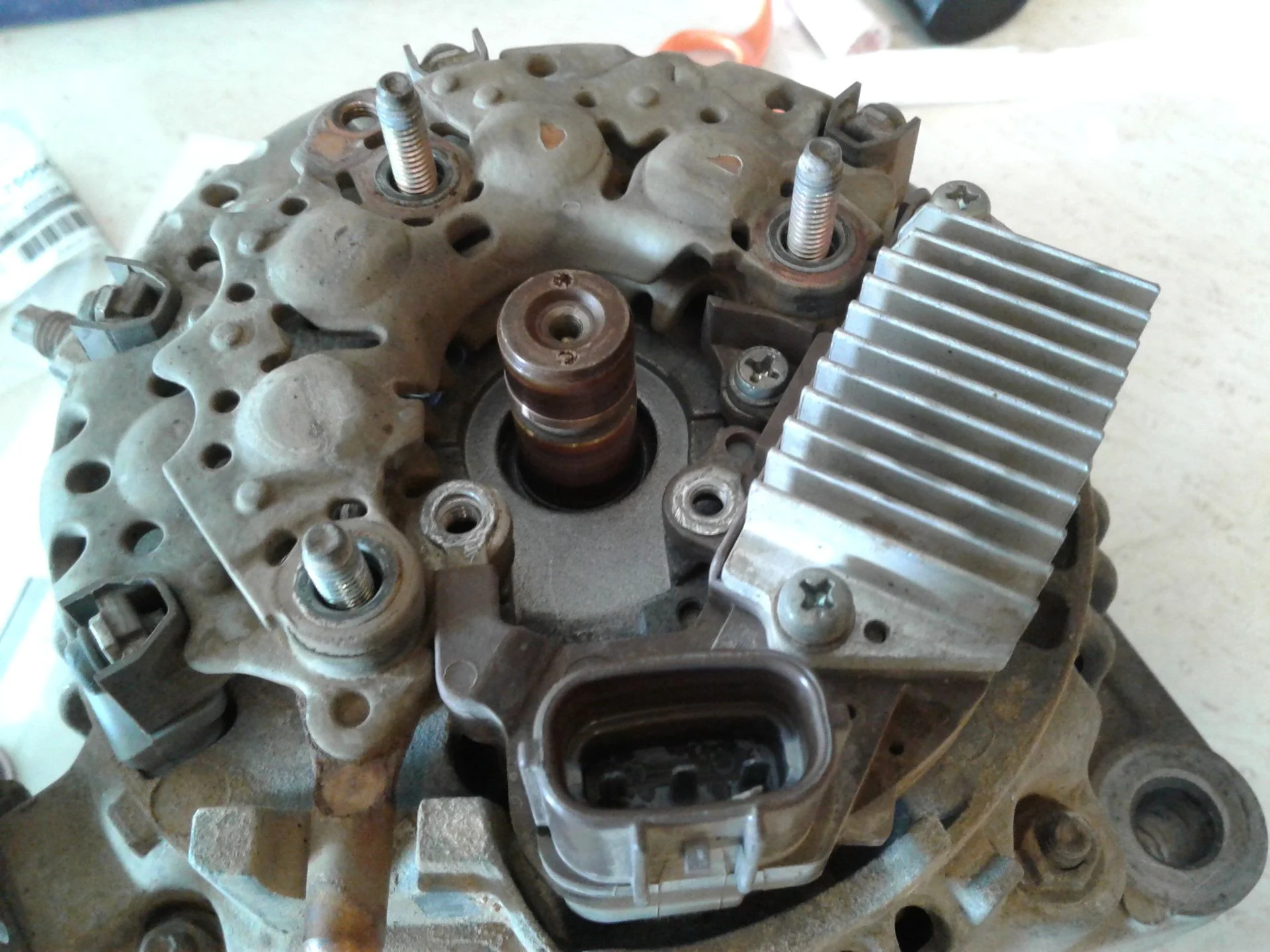

I replaced the alternator brush kit today. I believe the alternator is OEM, so does the brush kit.
Steps to remove the alternator
IMPORTANT: Disconnet the battery
Drained the coolant and removed the coolant reservoir tank
Removed the air cleaner box
Took lower radiator hose off at the thermostat housing
Removed the power steering pump and its reservoir (just move it out of the way, no need to remove power steering fluid or disconnect any hose)
NOTE: the wire plug was pretty tight fit to the alternator. I pressed in the tab on the wire plug and with a 90 degree pick tool, I carefully pried it against the alternator body on two opposite ends and yes, it worked!!
Pulled the alternator from the top.
Installation:
Make sure to apply some DIELECTRIC grease to the wire plug to prevent any corrosion and to ease the removal of wire plug next time.

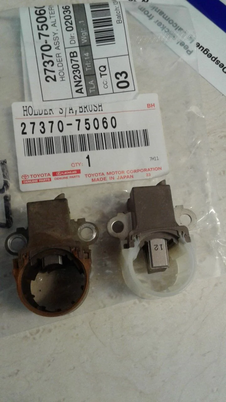

See the size of the old brushes, I'd say about 30% is left. From this 30% only about 15% may be usable. Glad I decided to R&R the brush kit.

On the reman units I have came across in my corolla they rarely replace the brushes in them. i have replaced that thing 3 times. it's much cheaper to just replace the brushes on the OEM unit and go on down the road. As long as the bearings aren't making any noise... Those brush holders can be had for under $10 on ebay. Just have to find the correct one. I'd suspect the 2 contact terminals are on the same plane for this one.
I've been driving toyotas since 1990 and all the toyotas we have got still runs on factory alternator and starter. The only thing that get replaced is the brush kit (stay with OEM to get the 14.4 volts, aftermarket does not give this voltage) and starter solenoid contacts.
The OEM brush kit is about $16 at Camelback toyota

A few years ago at 200k I replaced my alternator with 12v 100 amp reman Denso OEM unit. Currently at 320k and I have my front end apart for timing belt, radiator, fan bracket, valve covers, various hoses and "while I'm in there" refresh. Wondering if the brush for the 80 amp unit (part #27370-75060) is the same fitment for the 100 amp unit? Thanks for any assistance on this.
I believe so. My 92 corolla, 97 4runner and 00 cruiser uses the same brush kit.
