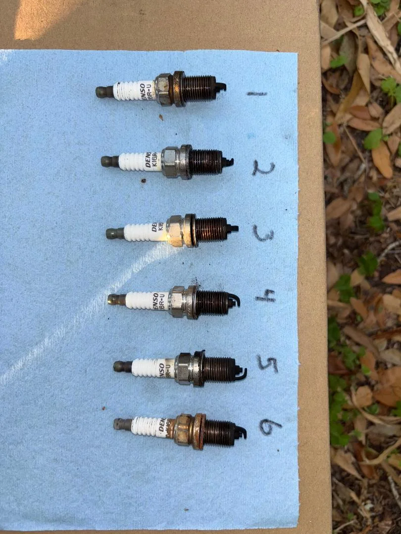

I pulled the spark plugs and still can't turn the motor even using a pry bar. The plugs are greasy but the cylinders look dry.
Spark plug #6 looks like it had water sitting on it outside the combustion cylinder - discolored compared to the others

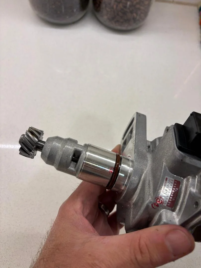

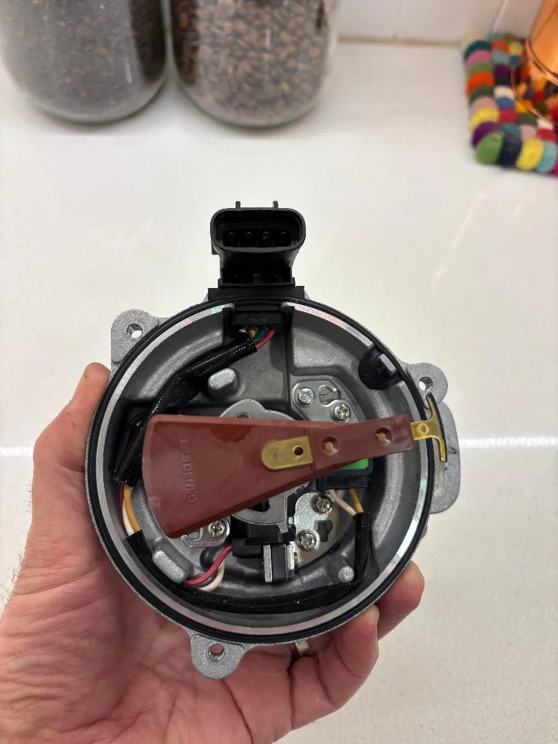

I pulled the distributor and all looks good.
Should I try to take it out and see?
I would. I see from the pictures that it is woodruff keyed, not pinned. That doesn't mean the gear couldn't have come loose. I mean, it's not super likely, but stuff happens. Do you have a borescope you can check inside the cylinders with? Who knows, maybe it lost a keeper and dropped a valve. Internet vehicle diagnostic work isn't always easy. you can also remove the starter to check. I've seen starters sieze with the bendix out.
