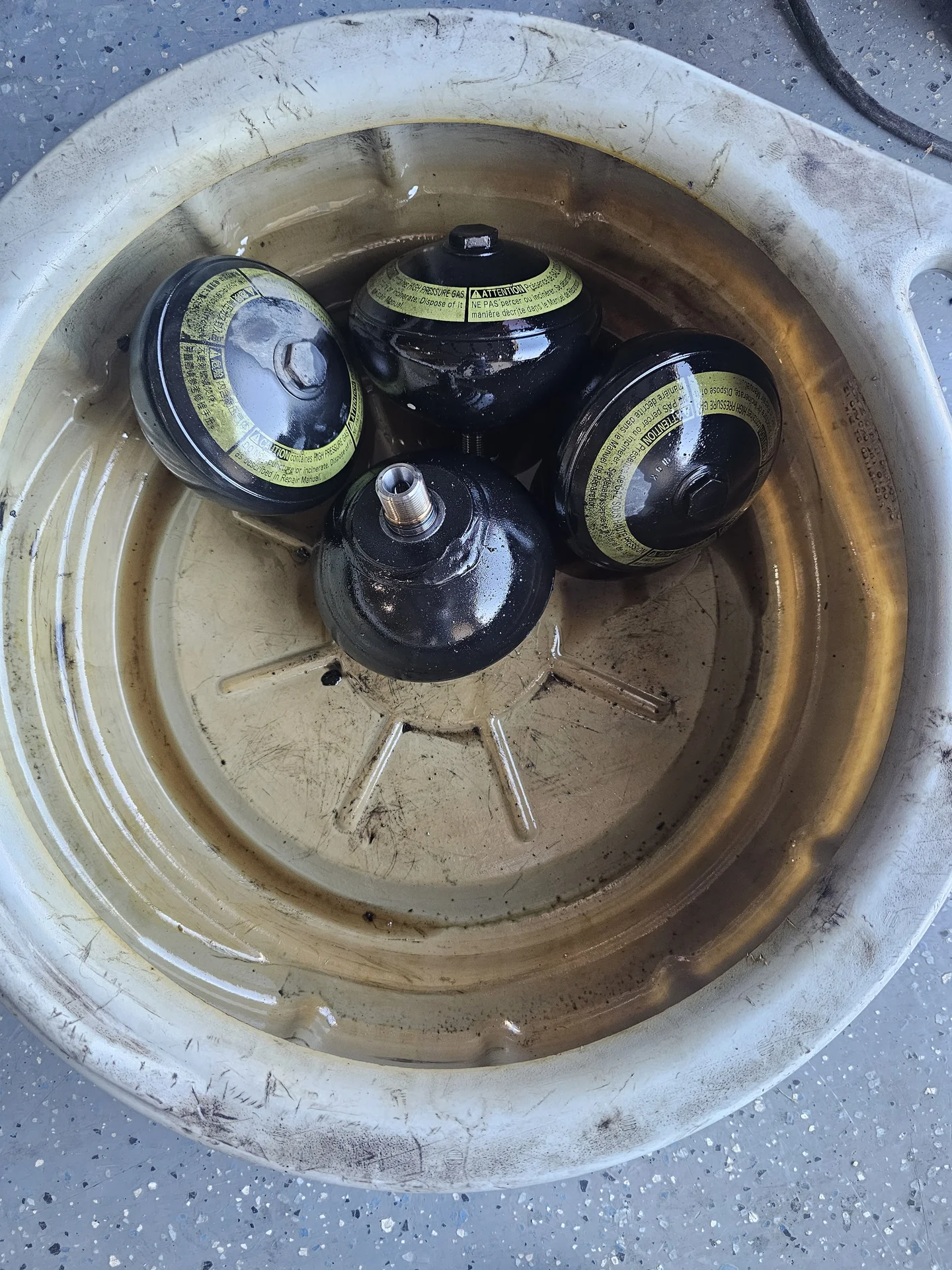

It's been slow around here lately been on vacation, went to japan and the philippines December and February, got to see many many many 200s diesel and gas as well as many 300's as well. Definitely made me jealous of the forbidden fruit we do not get here. Miraculously though i found some time a week ago to install my parts I've been hoarding. It feels good to knock all this maintenance out. AHC globes and flush ✅️ transmission filter and full fluid flush ✅️ radiator replacement w/updated part ✅️ water pump ✅️ fan bracket/pulley ✅️ serpentine belt and idler ✅️ power steering fluid flush ✅️ I also rinsed out the condenser and a/t cooler with simple green coil/condenser cleaner. To my pleasant surprise but some what waste of money i verified that the service history at lexus was indeed accurate because when I got the trans fluid drained and the strainer out everything looked basically new, the transmission fluid was flushed at 116k and the serpent belt also looked fairly fresh and was replaced at 100k and i am currently at 136k. Per the carfax when i bought it every single service was listed as done on time or just before by one dealer (lexus of bellevue) and the single owner who owned it before me. Nothing more to do now except drive it.. or upgrade ? 😂 I've been busy looking at 21's so now all I gotta do is convince the boss, but I don't think that will be a tall task..

The ahc globe and fluid flush is also incredibly easy, biggest thing i observed was to make sure you have a large enough breaker bar to get the globes off they are tight and yo can possibly strip the hex head if you are wreckless. But the service was as follows.
#1 remove protective cages on left and right sides to access ahc globes and bleeders. Set vehicle to low. Shut off vehicle.
2# hook up a 1/4 inch tube to one of the bleeder ports open bleeder and drain out fluid. Close bleeder and do the other 3. Note the vehicle will drop further in height past where low is every time you open a bleeder.
3# remove and replace all 4 globes, open ahc fluid tank and refill, I filled it passed max on the tank.
4# fire up rig and set height to normal, make sure all doors are closed or system won't operate. System might take some time to pump up. Run system to high then normal then low a few times.
#5 set vehicle to low and shut off vehicle. repeat the bleed sequence at all 4 corners, open and let fluid out. Vehicle will drop passed low! Refill ahc tank again and perform suspension raise sequence, low >normal > high a few times. Continue bleed/refill sequence till you bleed out clean fluid.
Note: you may get ahc faults and the system won't want to operate, I have a scantool to clear faults to get the system operating again. I highly suggest having access to a scantool.
All in all these things are very easy to work on and maintain with fairly simple hand tools and knowledge.
