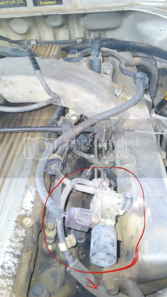

That's the solenoid that control the operation of the EGR. :D
1. There is a hose going to the injector pump.
2. Another alien thing.
3. There is a hose going to the vacuum pump? OH my god!

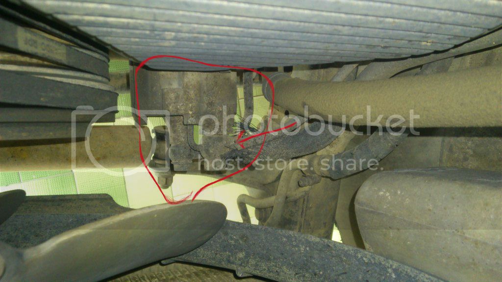

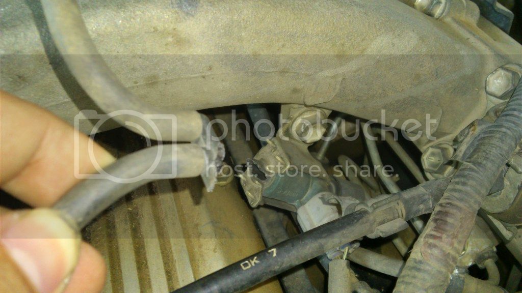

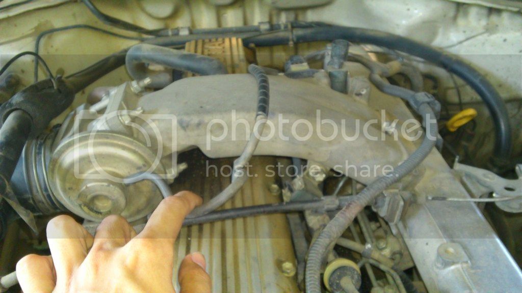

Could you name me the part of image 1 and 2?
If I dismantle the whole egr and hose what should I do to do to the hole at injector pump and vacuum pump?
That is definitely the vacuum pump.The power steering pump is on the other side of the timing cover and below.
Those pics are of a vacuum switching valve.
http://www.toyodiy.com/parts/p_G_2004_TOYOTA_LAND+CRUISER_HZJ79L-TJMRS_1708.html
Thanks a lot rosco! Could you tell me how could I remove the whole system without causing problem to the injection pump? I had lost my power and I think it is due to the egr system failure and the vacuum host connected to the injection pump. :bang:

As i said before block both hoses off where you broke that thing and put a plate in the line between the egr and the exhaust manfould and that will disconect the egr. Dont take the hose off the vac pump or other things wont work like your ac idle up. I think that will fix it.
