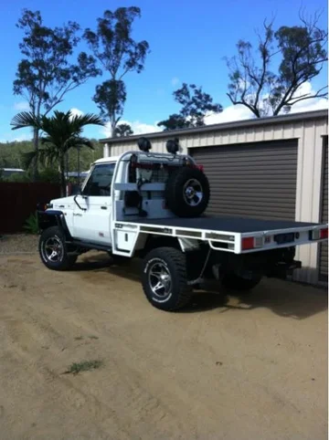

Hi all ,
Crushers , that home made tool is exactly what I needed. It took me hours and hours to get the gear box back in, I got to the point late on Tuesday night where I physically ran out of strength to go any further. I called a mate the following morning , it still took us 2 hrs to get it in, your dead right in saying the pilot bearing is the hardest to line up.... I got the gear box all the way in by myself but couldn't get the last 10-15mm in! It was a real mission to refit. For anyone going to attempt this job I strongly reccomend you are set up with the right tools from the start. I was using an atv jack that didn't quiet have enough hight , so ended up having to flattn the tyres etc to lower the truck! PIA to say the least ! After doing the job, I so wish I made that tool up, it would have been perfect, we ended up using a big lever and rolling the gear box over slightly , I was one very happy man once we got it in!
Couple of problems along the way..... Trying to get my levels right I lowerd the motor too far, the exhaust has had a hairline crack at the waste gate assembly for some time but it ended up snapping of with the dump pipe ending up on the shed floor! I have now had it welded back on and seems ok!
While the support was off I replaced the gear box mount, I've had a new one sitting in the shed for a couple of years so it was the perfect time to fit it!
Axle studs....... Definately not a wheel bearing problem, it wasn't till I had a close look at the studs (picked them up off the street) I noticed that half of the studs have been broken for some time , 3 of the snapped studs were shiney ( new brake) while 3 were black and looked to be broken for some time!
I struggled to get the broken studs out as they had bured the hub really bad , didn't stuff around with it , ended up replacing the hub , studs, and dowls!
Going back almost 2 years ago I had a wheel fall off on me . Was only going slow when it come off but , I am suspecting that this problem could have been caused by this ! The studs were not replaced after the wheel fell off !
Metal filings in engine bay ...... I can only think of one reason for this , as stated in an earlier post I have very recently done a full brake / bearing overhaul , I went all out , resealed the calipers, new rotors, pads, hand brake, full bearing replacement including swivel hubs! I am not certain but fairly confident in saying the metal throughout the engine bay has been coming from the front brakes bedding in! BTW my cruiser now stops extremely well , anyone interested I use TRW brake pads, they are soft, dirty, but work very well ! As for the handbrake....... God there s*** in these 70series ! Mine works ok, much better but it's still crap, would never rely on it !

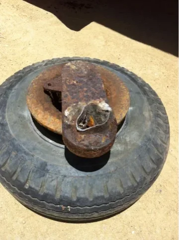

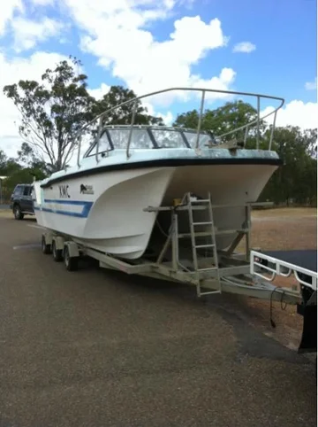

I've had this boat over at my mother in laws house for the last 5 years will I've been away working , bought it as a project but then had to move, back home now and time to get into it.....
First things first I best fix the broken axle that just snapped in the drive way.... Drive way has a small slope on it . All the weight was on the front axle ! Bugger ......
Can anyone tell me what the technical name is for this style of suspension? I'll put a post up in the trailer section! No doubt this will be a s*** head to repair! If it can be repaired?

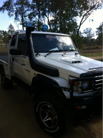

cruiser75, did u place the hood scoop for ur turbo?
Not sure what you call it, maybe pivot arm suspension? One of the guys at work used those style axles when he built a trailer for his drag car. By the looks of you might need to replace the whole axle :(

Torsion suspension..
