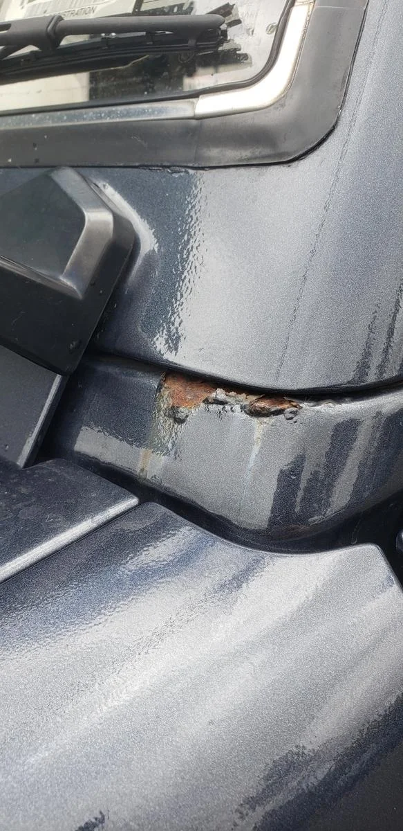

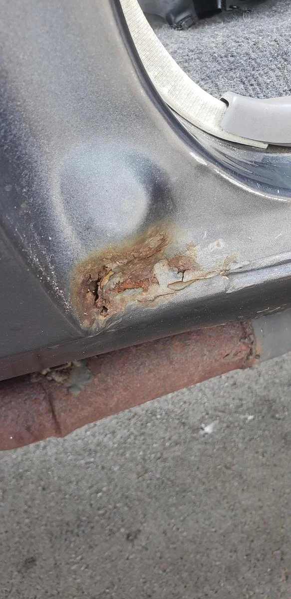

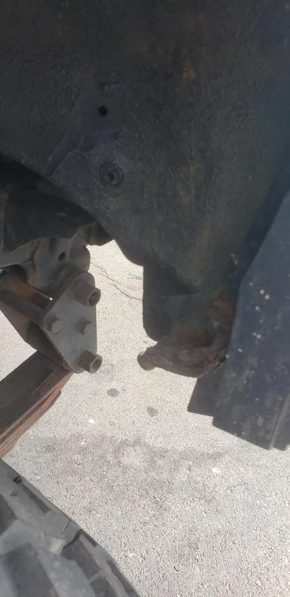

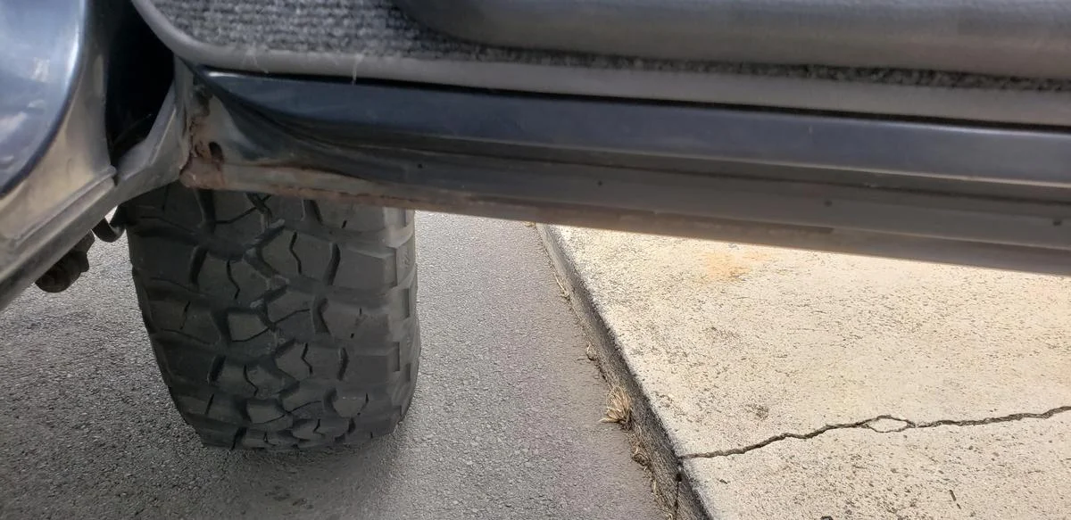

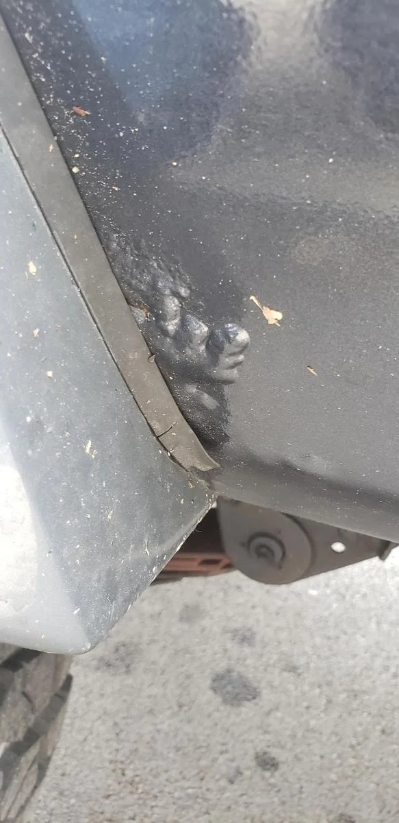

Hi everyone! I’m loving my new-to-me 1990 HZJ73 but there is some rather serious rust I need to have dealt with and I’d like to have it done in a way where it won’t be coming back.
I received a quote from one shop for just over 12k, and another shop said they can do it for 7k if I remove the top and front windshield, and order the rockers and quarter panel sections for anywhere with rust so they can be welded in.
Do you know where I can order just sections of the quarter panels? I’ll also need the rear left body mount and side rockers.
I tried searching extensively through Partsouq and couldn’t find these parts or the part numbers.
Thanks again for your help! Any advice is greatly appreciated.

Some of your panels and the doors bolt off, which makes it much easier to repair and paint. Sheet metal is much more comforting to work with as most of what you are showing is non structural. Under the window is a bit nasty tho, got to remove the window, to weld, which is doable.
Paying someone to rid the rust would be exy if they have integrity. Diy is time and love, depends on your lifestyle, work, family commitments, tools and workshop facility if any. You have a new hobby! If diy, build confidence on the front fender (check under where the battery sits) or door, bolt them off and clean it up, have a look, proper. Get a toyota fsm manual, you will need it for a car that age.
Body work as far as steel, welding and grinding is not too expensive compared to parts for running gear of drive line and engine. Paint is exy. I still prefer a solid colour buffed gloss to a clear gloss personally, one less step and easier to respray again. You have a clear gloss on top of colour.
Really beautiful thing about steel is that it is cheap compared to almost everything else. One piece of sheet metal goes along way. There is not too many curves on a 70 series. You could do one area at a time, to balance enjoyment of the vehicle, but put something on the rusty spots immediately to hinder it a bit. There is a million anti rust products, few really work long term besides vigilance. Big market; steel, paint and anti rust.
Of course you can't really see all the rust until you have a good dig though, Those pics are just what you can see, there shall be more..check rain gutter seams and the pillars at the front of your doors, especially where the rust is under the window. They are the worst sheet metal rust spots imo, front of doors.

So I can highlight on an image what parts of the quarter panels I need to have replaced, but I’m having trouble figuring out from parts diagrams how to order just sections of the quarter panel.
I’ve found rockers but I can’t find a source for the quarter panels or sections of the quarter panels that has them available.
Any leads would be greatly appreciated.
I’ve been quoted $2500 to replace each quarter panel if I provide the part, which seems really high to me. Am I mistaken?

You are either at a shop where they are used to getting to work with insurance or one that can pick their own resto projects ! Doing sheetmetal work is not hard nor complicated but it can be a dirty and time consuming job . If you can't find a reasonable priced shop then it might be worth looking at investing in some tools and do it yourself and that way you can go down the rabbit hole as far as you want. Youtube and google can teach you just about anything these days .
Looking at the pictures of your cruiser I can see that it already had some work done wich usually results in more work once you start peeling the layers off . You might want to start taking it apart and see what the damage is , Toyota still sells full quarter panels for these and almost every other panel you need.

I agree with Joe your truck was previously worked out... When I started my LC I had no idea what the truck had been through. The rear quarter panel had to be replaced we did it ourselves. The part was not expensive from Toyota but shipping ouchhh. I found building mine that removing all paint working previously done give you a very good picture of the metal underneath and also a good base to start with you can sandblast and repair if needed
Here is where I purchased my quarter panels. It was pretty simple shipping from The Netherlands to Texas.
