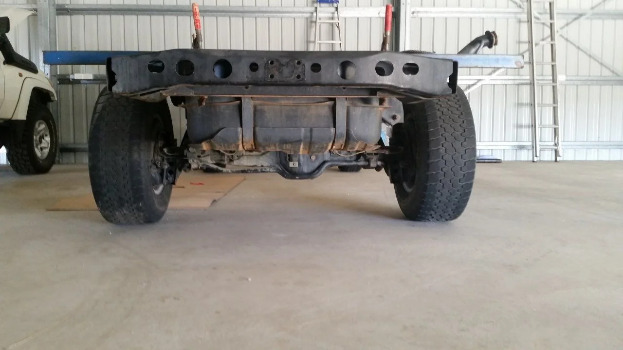

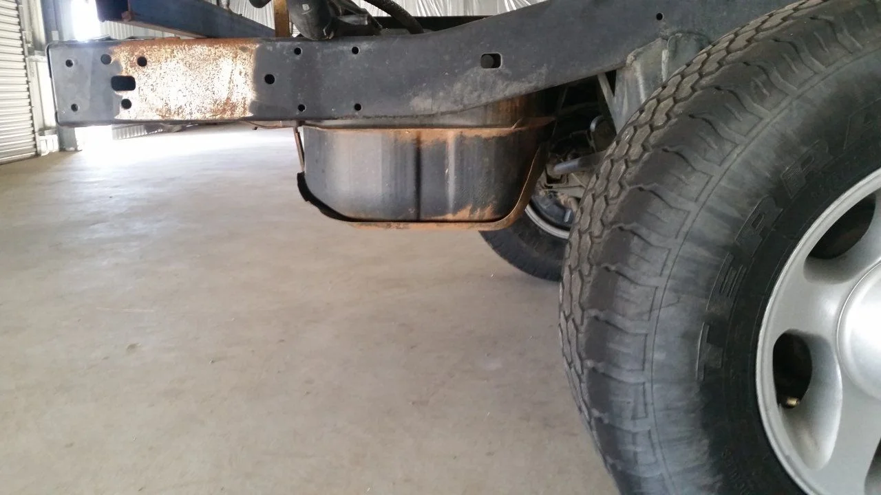

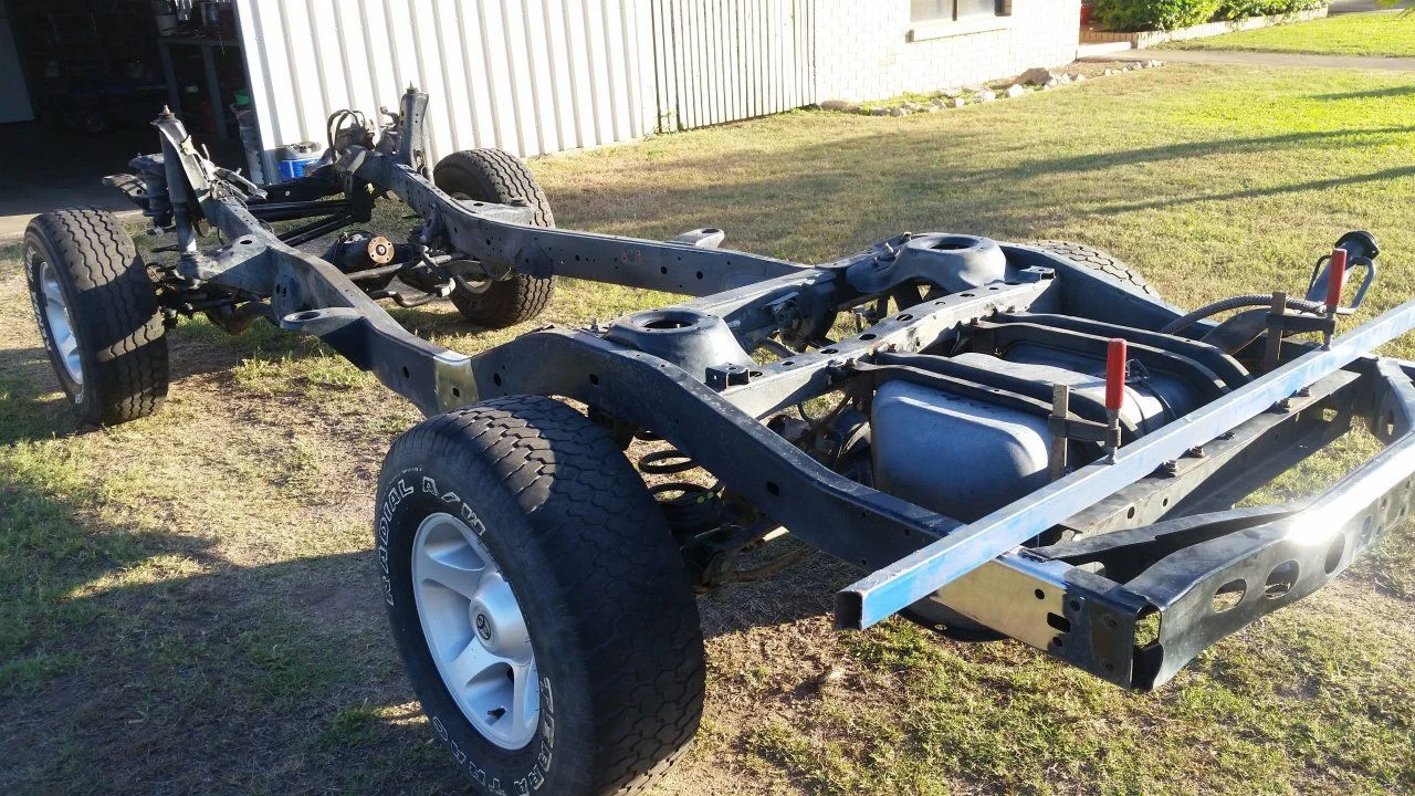

Looks like it was made to fit with those tank supports. Are they from the 79 as well, incl the C channel type traverse support? The 80 has a transverse support for the spare tire.
Would you mind taking a pic showing how far it protrudes below the frame rails? The depth of the tank is my only real concern when it comes to off-roading.
Thanks.
