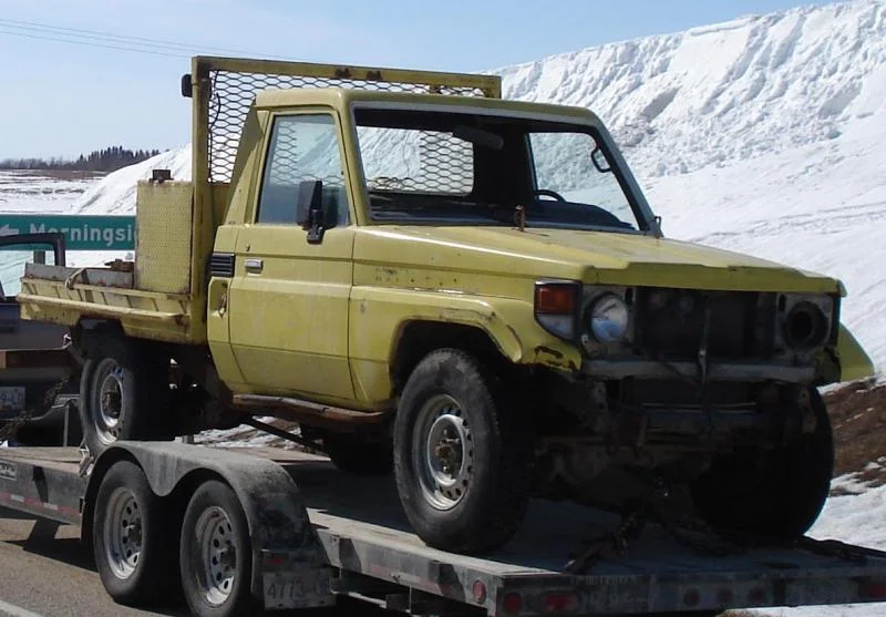

I've come to the point that many other lj78 owners have, cracked head that needs money thrown at it. So instead of the easy fix (new head), i've decided to go the long route. I bought a Hzj79 ( 2001 I think) ex mine truck, with a 1Hz and a 5 speed R151F tranny. The front clip was a little banged up, so I was able to source a complete front clip off of a bj74 in decent shape. The plan is to use the front clip from the bj74, and the engine/tranny and mounts from the hzj79.

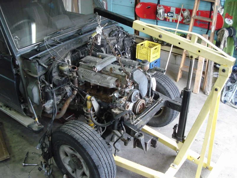

Pulled the engine/tranny out of the lj78, fairly straight foward with the front clip off.

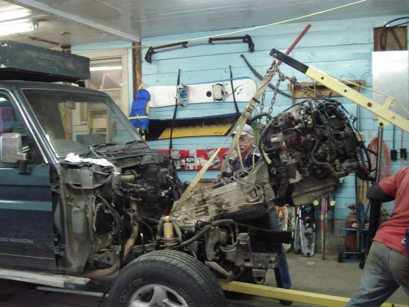

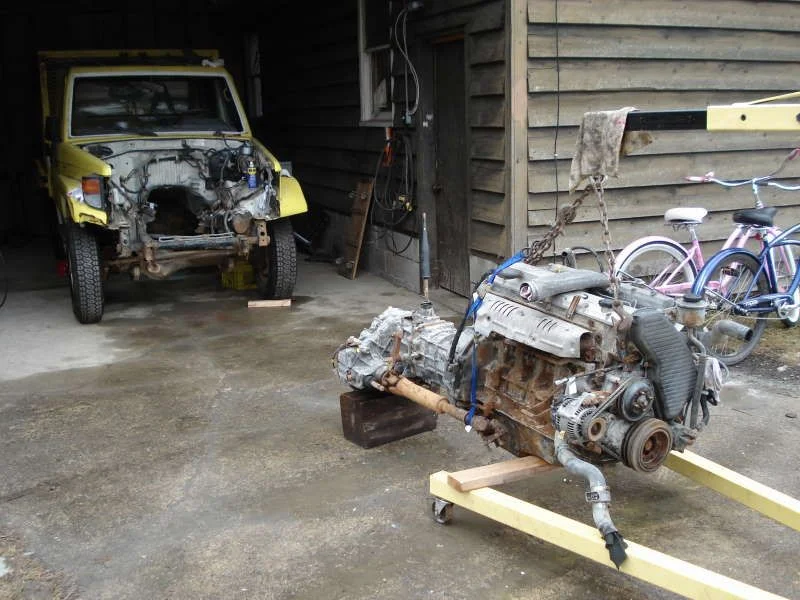

Got the engine tranny out of the hzj79, a lot less electrical, but the mine grime made the rust thick and abundant.

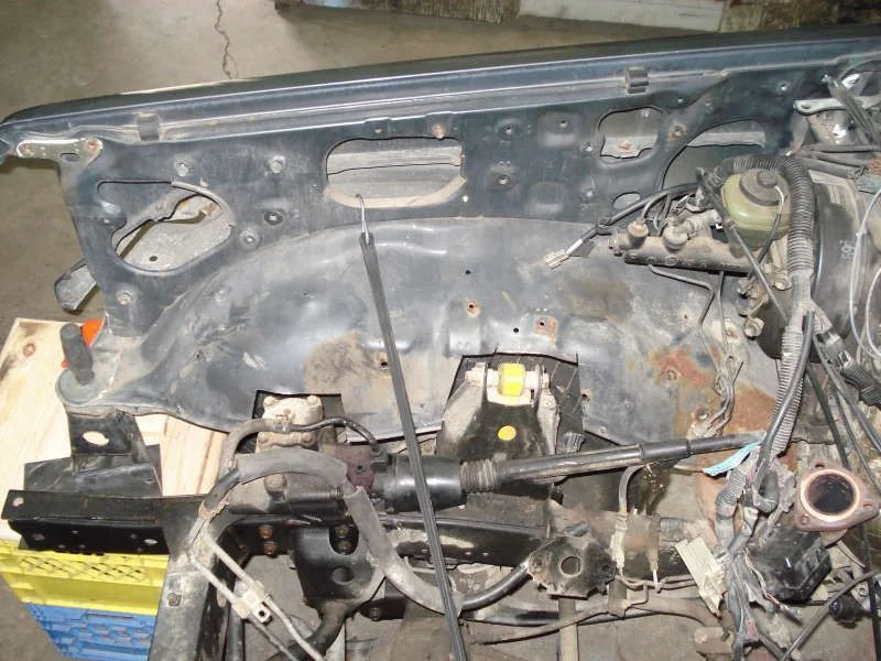

So now the easy part is done, first thing on my list is to deal with the front clip mounts. the 79 mounts are about 6 1/2" wider and a few inches foward. Not to sure if I want to cut the ones off of the hzj79( like to leave the front end attached), or just make some extensions and fit my lj78 mounts to it. The front cross member on the 79 is right inline with the mounts, where if I moved my 78 mounts out and foward they would be about 6 inches ahead of the 78s cross member. I guess what I'm trying to say is, do the mounts need the support of the crossmember right at the brackets?

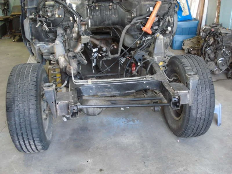

Made the front clip mounts last night, from scrap metal I had laying around. I just tacked them to the frame, until I can get a larger welder ( had to heat up the steel from the back side to get a decent beed, doesn't really work well on the frame though). Not the most stylish things, but they should work.
When I had the fenders on I had to cut a few holes to make room for the power steering, and the shock/spring towers. Thinking I'll just cover them with a rubber flap

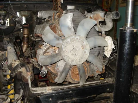

Was able to scrape together some time this morn, and dry fit the Hz. I had noticed that the stock front drive shafts of both the lj78 and the hzj79 were the same length, and after taking a few measurments it looked like tranny mounts might not need to be moved :D. After cutting the motor mounts out of the lj and the 79, the Hz slid right into place. I Used the stock placed tranny mount, and then tacked in place the motor mounts ( I'll be able to use both stock drive shafts ). So far it looks like the fan will need some attention, the 18" hz fan just hits the front crossmember, and the smaller 2LT fan clears by about 3/4". Both leave no room for a shroud, I'll have to see what it looks like when the panels are on, thinking if I bring the fan foward about 3" it should be past the crossmember.

personally, i would have cut the cront cross meber right behind it and stuck the front cross member from HD unit on...
well from this side of the keyboard that is what i would have done.
notch the top of the cross member and well a half moon re-enforcement plate in...
Nice swap:clap: Mine has been kind of on hold for the last few months due to work. I'm kind of doing the same as you. Putting a HD-FT/H151/full time transfer into a LJ-78. Of course I got to do it a lot harder. I ended up cutting and welding the front frame pieces from my BJ-70 onto the LJ, which did two things for me, one gave me the front body mounts and I can use the same bolt holes for the steering box and steering stabilizer shock frame mount. I am also doing a steering wheel swap and swapping my axles from the 70 into the 78.
The lj's front cross member is attached to some part of the suspension, anti sway bar? I didn't want to tackle that so I left it alone. Thinking of using the 16" 2LTE fan, I can make a bit more room by moving the power steering lines (if I have to). I also have the shroud from the 2LTE which will work with the fan, and will still fit (with some mods) on the slightly larger hz rad. The lower rad hose on the rad hits the middle of the crossmember, will probably put a 90 on and go over.

If you don't need the extra room from the front cross member then I would try and do what Crushers suggested by cutting/dishing this cross member to use the HZ fan. Of course you might run into a problem with fitting the bigger rad. Maybe instead of dishing this cross member you could cut the top half off so as to make more room. I would try and dry fit the fenders and rad to see if you need to make any more clearances for the rad/fan. I think you would want the fan to at least enter the fan shroud a little bit so you don't get any air leakage around the fan shroud. Hope this all makes sense.
With the smaller 2LTE fan (16") it all works ( fan/shroud/rad), with the fan in the shroud. The hz fan definately needs the extra room (dished/cut out). :hmm: In the end the larger fan is probably the way to go.
