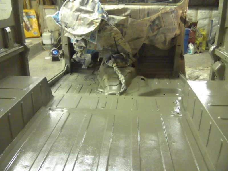

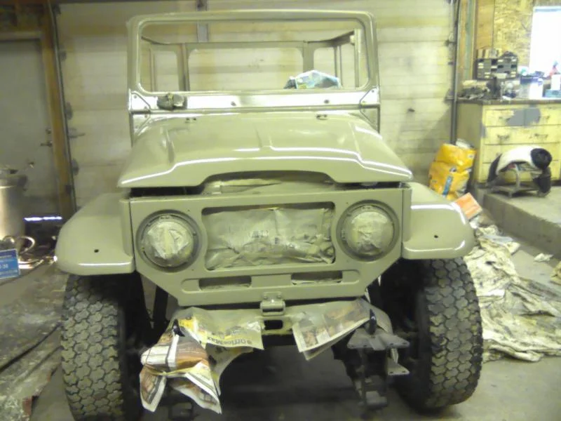

This is the new rig. I'm not trying to make her completely stock but close to it. Does anyone suggest using an electric fan? What is suggested for a not so expensive ignition setup?

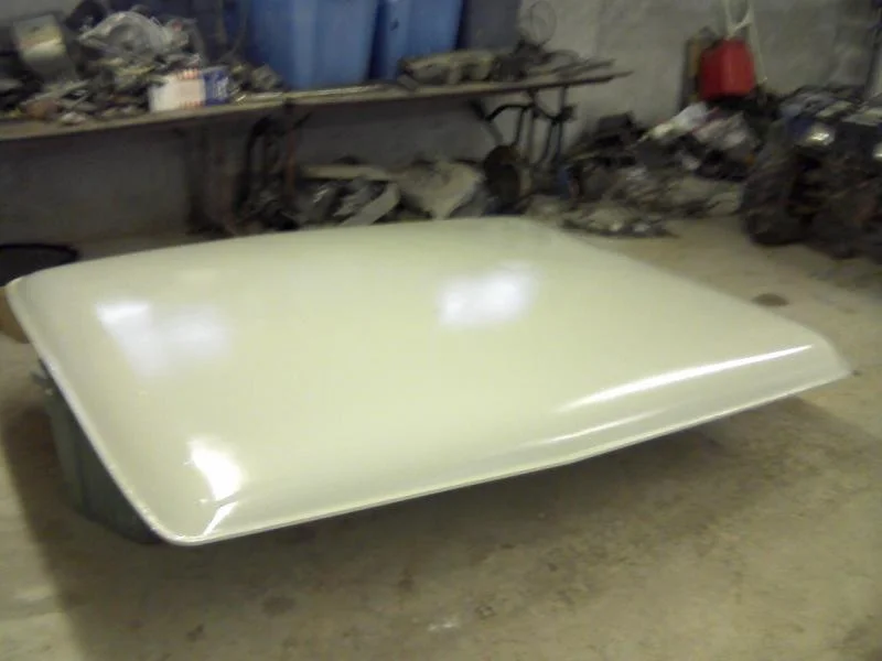

Heres more of the progress.. Only one coat of paint so far.. 2 more to go..

Did you already paint the engine bay, or is that step come after?
Thanks guys... yea I'm painting it back to its original colors. the engine bay is in pretty nice shape so i don't plan on painting it for awhile. She should be on the road by wednesday.. I'll post some photos.

First picture - I thought wow thats looking great....Can't wait to see it finished up...
I totally respect anyone that does their own paint.....Looks great!
