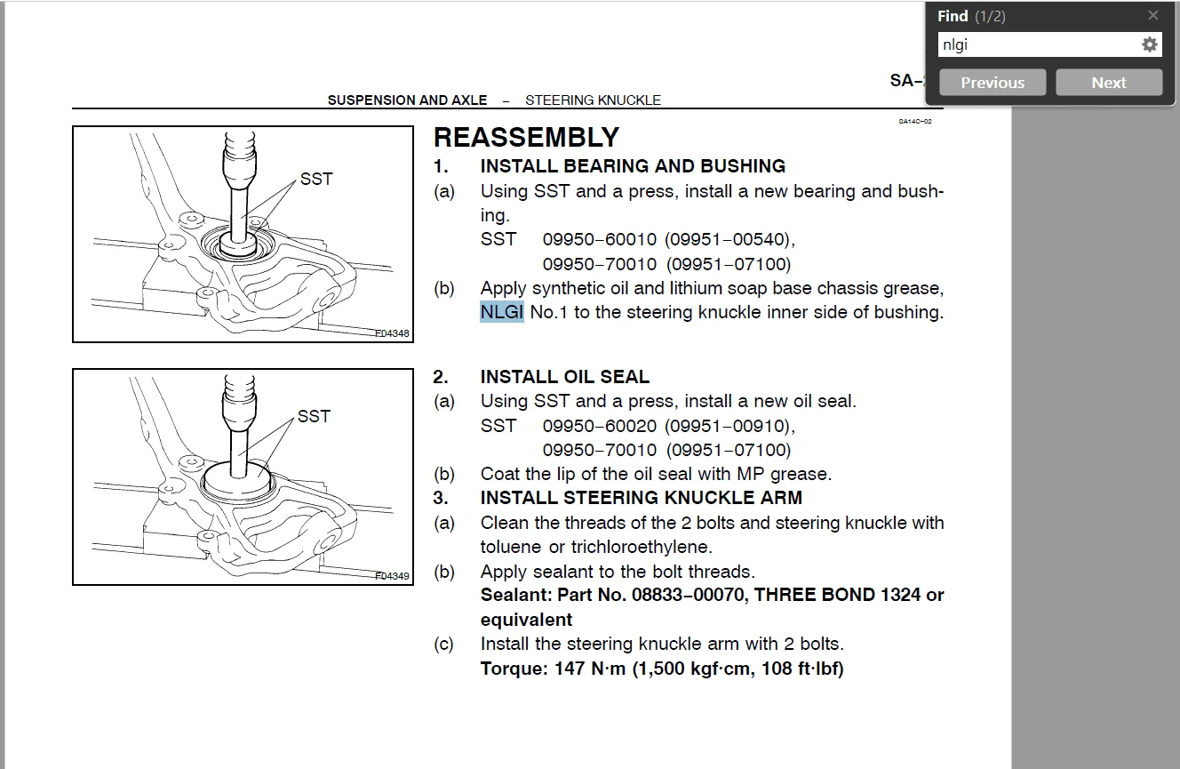

Thread resurrection--what grease to use. FSM says:
"Apply synthetic oil and lithium soap base chassis grease NLGI No. 1 to the drive shaft"

To be clear, I used mine on the spindle per the factory service manual. I am also a mechanical/materials engineer. I think making a broad assumption about what greases are best with what types of bearings. Really depends on the type of metal, surface finish, surface treatment, etc. Not to mention whatever weird chemical reactions if you stay mixing greases, if solids will precipitate out of solution, etc. I trust the factory did their homework. If it's what the factory put in there and they haven't put out a TSB to change it, it's what I'll use.

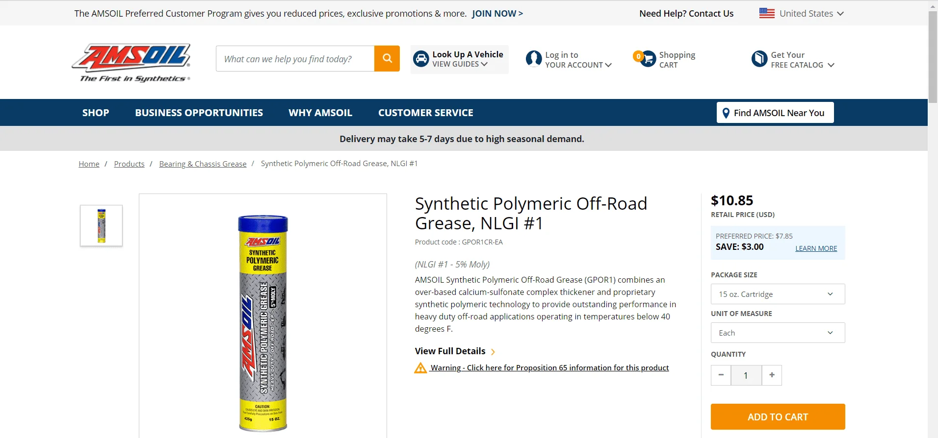

Oh, and to be clear I did not use the AMSOIL grease because I could not find enough info about the calcium-sulfonate thickener they used instead of the lithium soap. There is some good reading here if you actually care.
